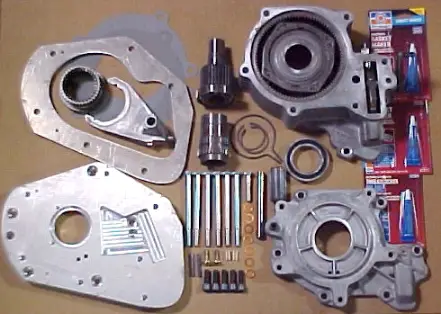

More goodies. This past weekend at RC got me pumped up and I figure if I don't have time to work on it, I'll still spend money on it in hopes that it will be done one day.
Stubler #14 from HERE
Didn't calculate my new crawl ratio yet, but will be somewhere around 120:1

Will I thought it would be easier now since I am making a new tranny crossmember anyway. And i wanted to make you jealous too :D

Got some work done this past weekend, I plan to do some more this weekend too. My only gripe so far is that I still don't have my Stubler because 4xFab found something wrong with it before it was shipped. He said he has to machine some new parts and should be able to ship it on Monday. I hope this is true, because it needs to go in before I can do my crossmember placement. I do appreciate his commitment to quality and not sending out a bad part, but i want my new toy!

Things are progressing slowly, but its progress. I finally got my stubler in the mail. I haven't been home to see it, but I'm sure its gonna be great. As I mentioned earlier the stubler might set me back a little bit due to the fact that it will interfere with my gas tank. The tank is removed so I think I will remove its bracket that is in the way, then install the stubler and see if I can build a new mount or come up with something else. Just out of curiosity, does anyone have any quick links or advice for putting a fuel cell in the Ex. Its gonna be trailered from now on so I don't really care about the size, I'm more concerned with getting the right fuel pressure.
