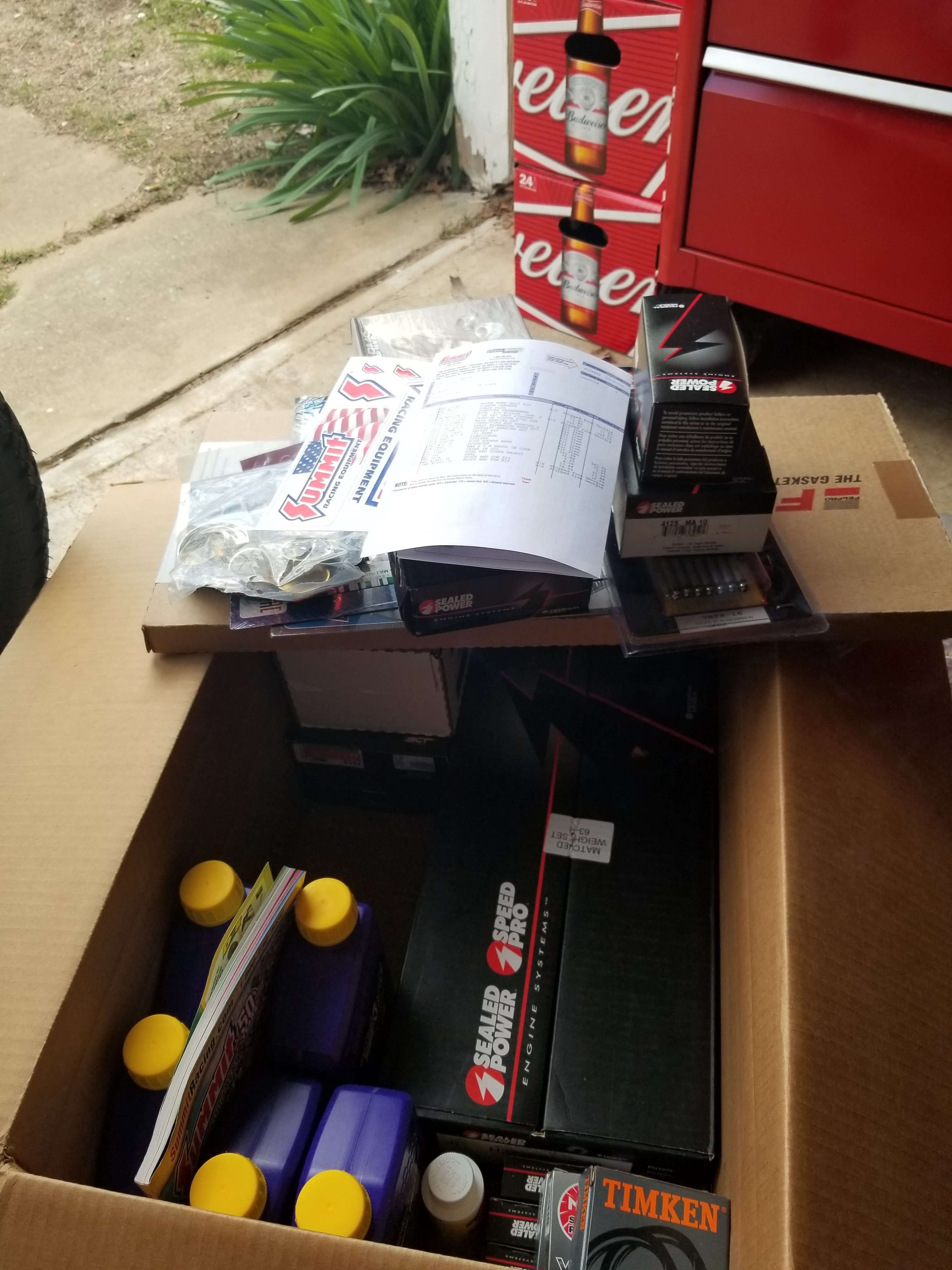

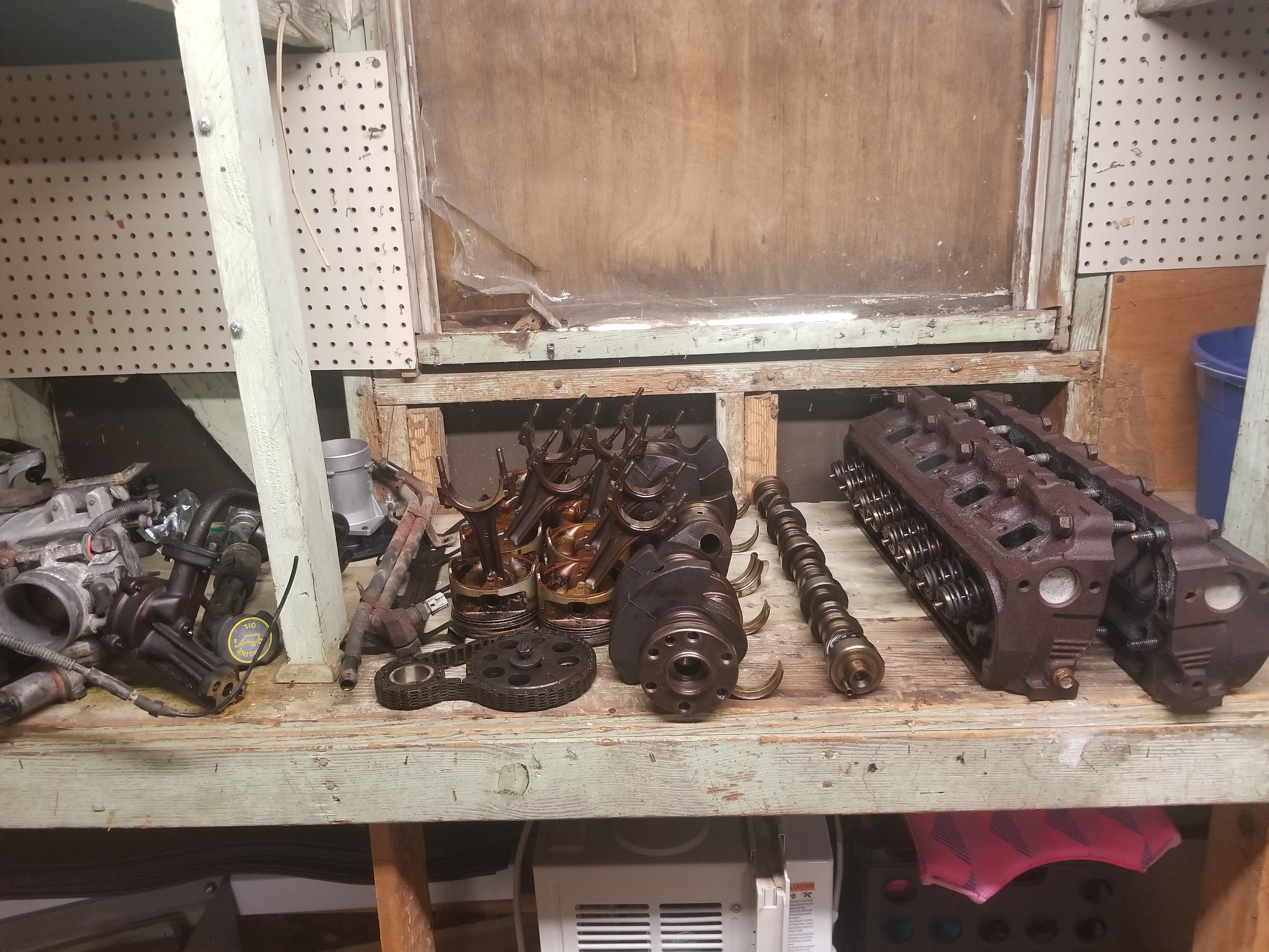

Okay, so I've got a few parts picked out and I think they will work but I'm not for sure. I'm going to go with comp cams 1.6 steel tip rollers part number 1431-16, comp cams 7826-16 high energy push rods and comp cams XE258HR-12 cam kit K35-510-8 which I know will fit and I think will be a good upgrade from stock without being too aggressive. What I'm not sure on is this engine rebuild kit I found on summit, it seems like a great deal but it says it only fit up to 95' but if it would fit then it seems great because it has piston and rings oversized for a 0.030 Bore/hone and crank bearings undersized by 0.010 for the crank grind. the part number is MHP174-311. And I think I'll be okay reusing my stock connecting rods. I will also be getting the SCT X4 programmer. I'll have a local machine shop set up the heads with the new parts to spec with the cam card, as well as do the bore/home and balance my rotating assembly. Should I get new valves and guides as well or should the originals be okay if cleaned up? Thanks for all the help so far, I tore down the doner engine this past weekend and everything seems to be in decent condition and all oem so it should be a good build.the water pump bolts were a pain as always and had to drill them out of the timing cover but I expected that.
Well I got my parts ordered. Going to have to wait on the machine work as I'm in the process of buying a house and my truck money is now house money for the next month. But if got a shop to do the head work, the block bore, and the balancing so I just have to find someone to grind the crank now. Gonna try to get my parts I'm reusing cleaned up this weekend. Slowly but surely making progress!

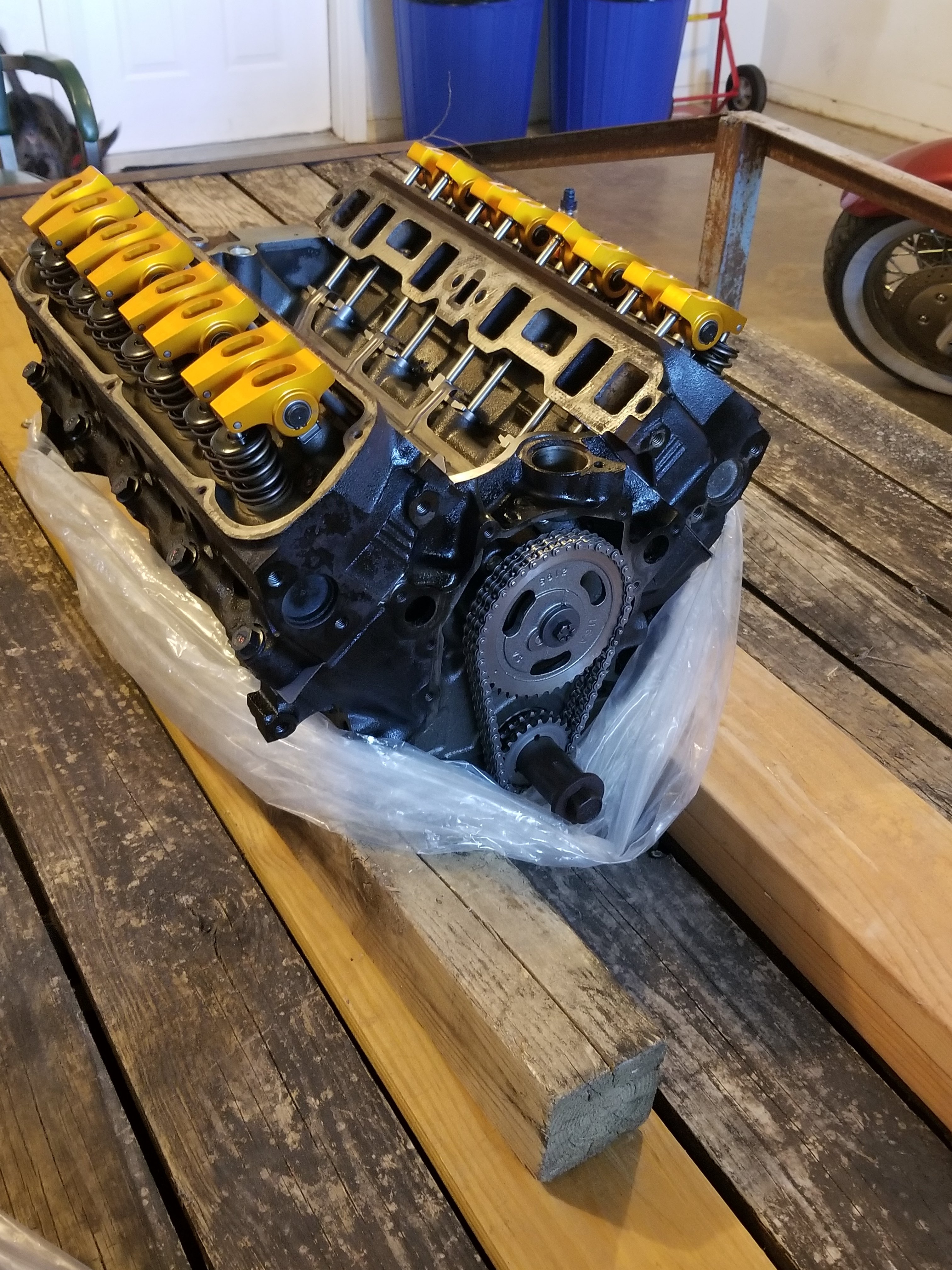

Well I picked up my engine yesterday! I went ahead and had the shop balance my rotating assembly, degree my cam, and set up my rockers and push rods. Ended up going with crane 1.6 roller rockers, a comp cams cam, push rods, and springs, and a .030 over bore. Gotta get some stuff sand blasted and some parts gathered for the 4406 swap and then I get to start dissasembly of the old drive train.
