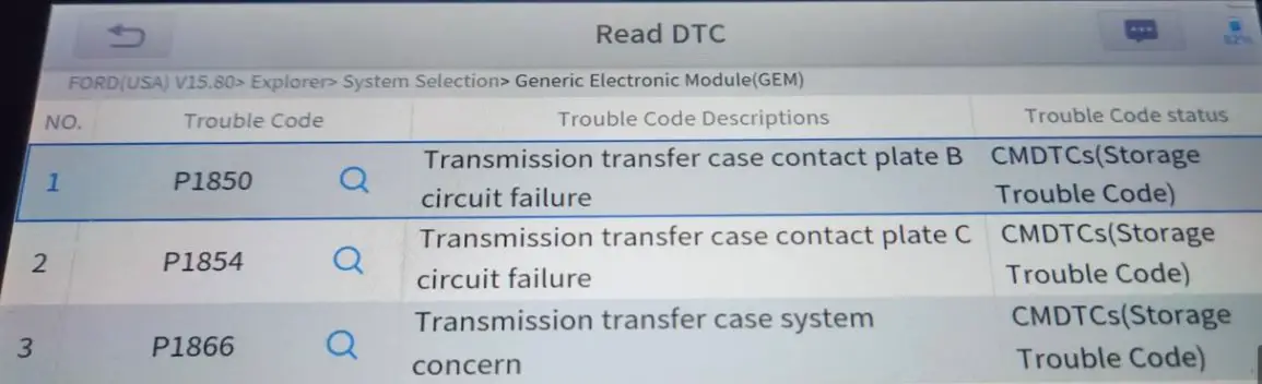

You have changed the GEM module without reading codes before?

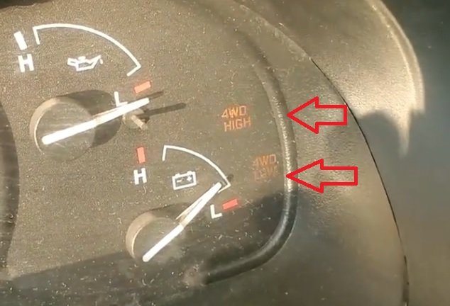

If you have flashing indicator lights
i am pretty sure you will have some of these codes
and that is a sign of a bad transfer case shift motor.
