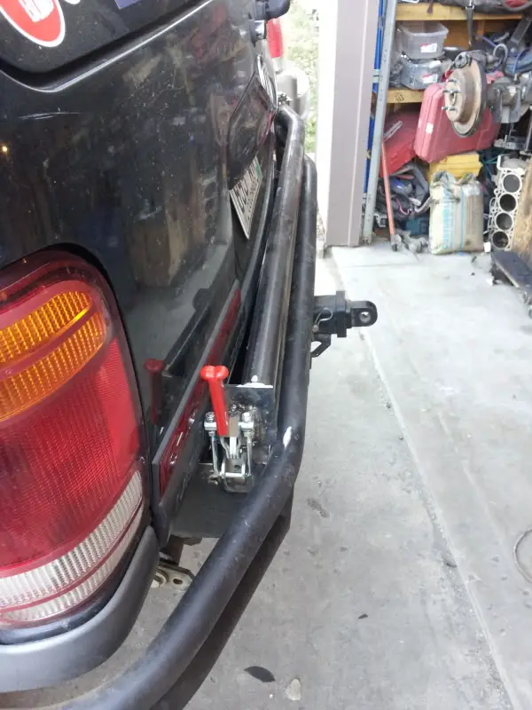

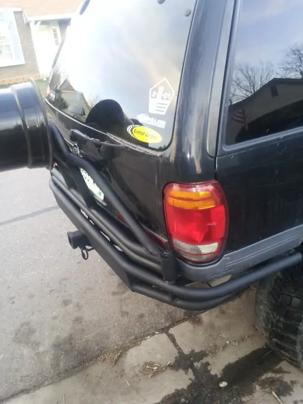

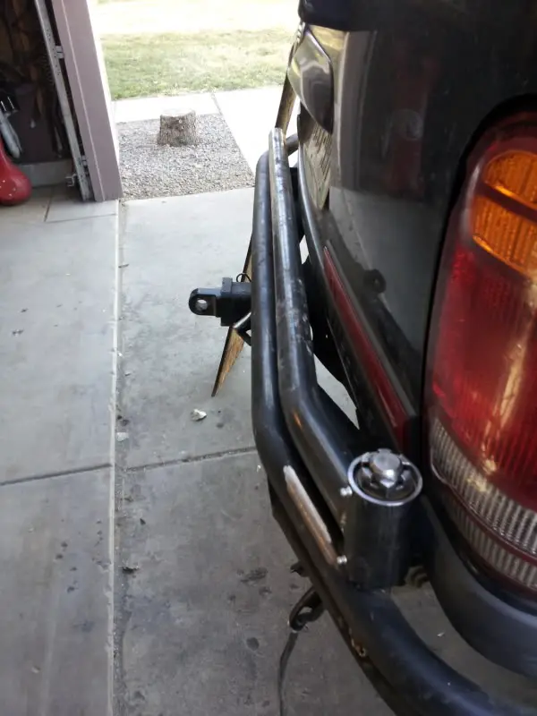

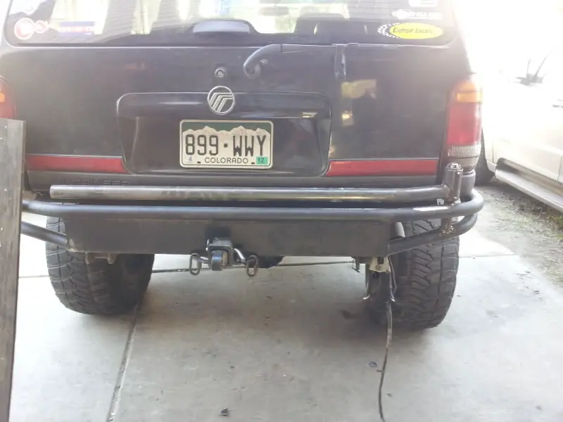

Worked on the tire carrier some today.
Hard part is done(swing arm) now I just have to work on the tire carrier, high lift mount, and Jerry can holder.

That is a really cool design! Not sure I have ever seen one like that. Nice Work!

Thanks! Still have to do some more bracing using round tube you have do a little extra work to make it beefy enough. But the look is awesome that is why I am going the extra mile cause I wanted something different.

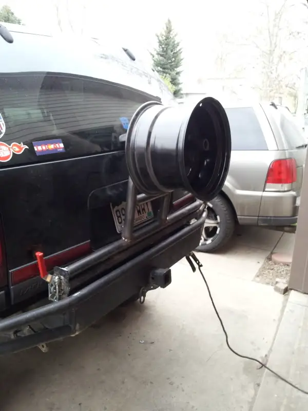

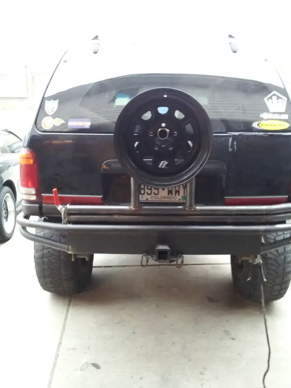

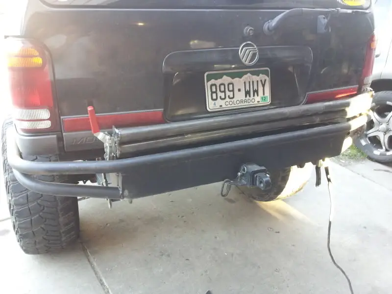

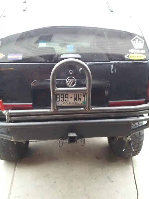

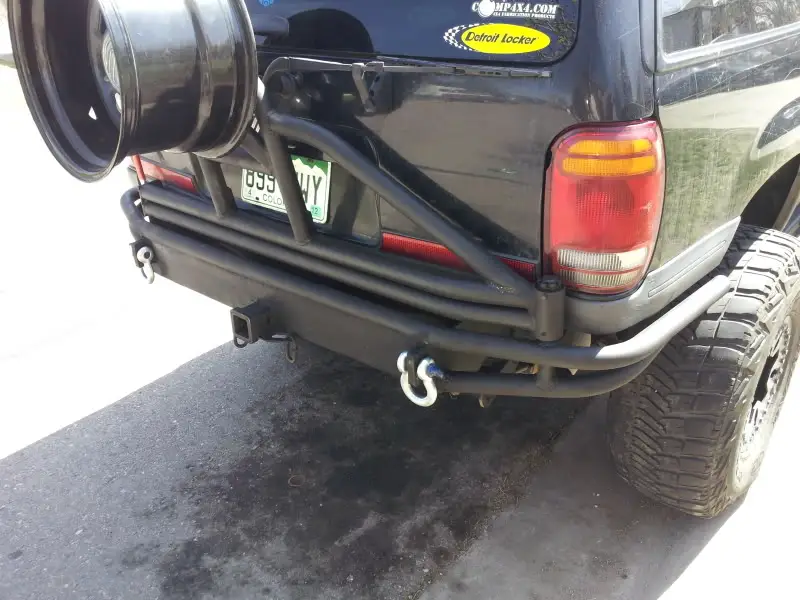

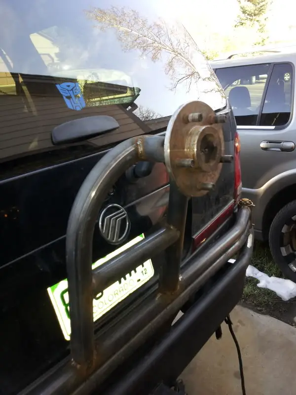

Pretty much done with the tire carrier part. Just need to beef up the bumper some where the hinge is. Turned out good I am very happy with it.
Used a Dana 35 axle shaft and cut it down so I could use the end for my tire mount.
Saved one of the Mercury center caps just for this purpose. LOL
You can see the extra brace I added in the center and then one from the hinge over. Made the carrier super solid.

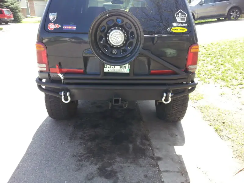

Thanks guys I love how it turned out. Now if the other 2 Kevlars I have on order would ever show so I could put a tire on it. LOL And yeah backup camera would be nice but I am used using the side mirrors since I pull my flatbed and enclosed race trailer with my Super Duty.
Also one of my Jeep buddies said if I wake up and my bumper is gone and his is laying next to the Merc not to be alarmed. LOL

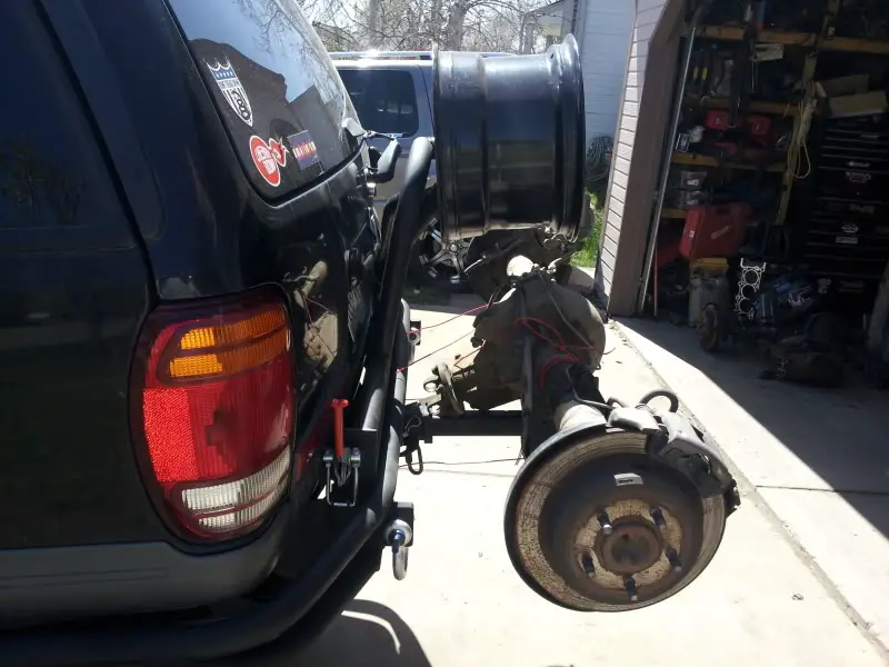

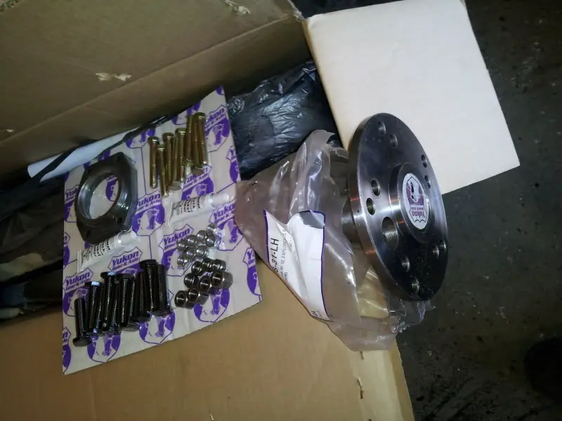

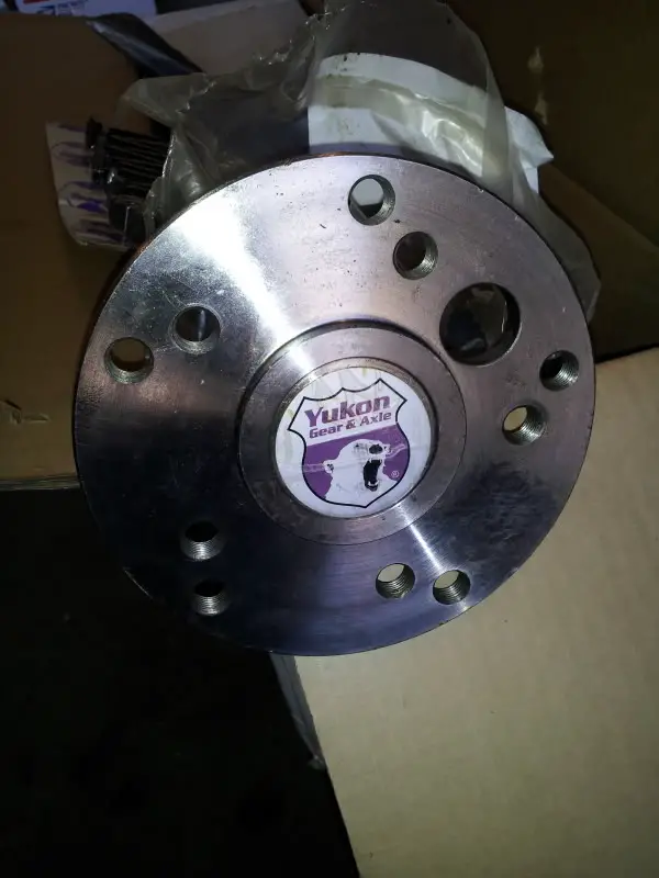

Got a present from the Fedex truck today!
Double drilled sweet!!!
I also got the D tabs put on the Merc.
Looks like I am going to have to build a special holder for my axle holder cause this isn't going to fly when the tire is on the rim. LOL

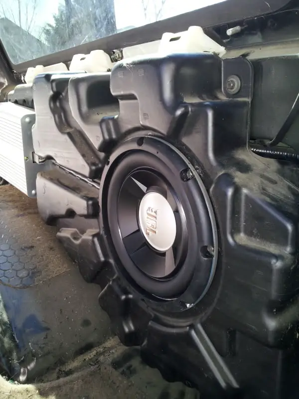

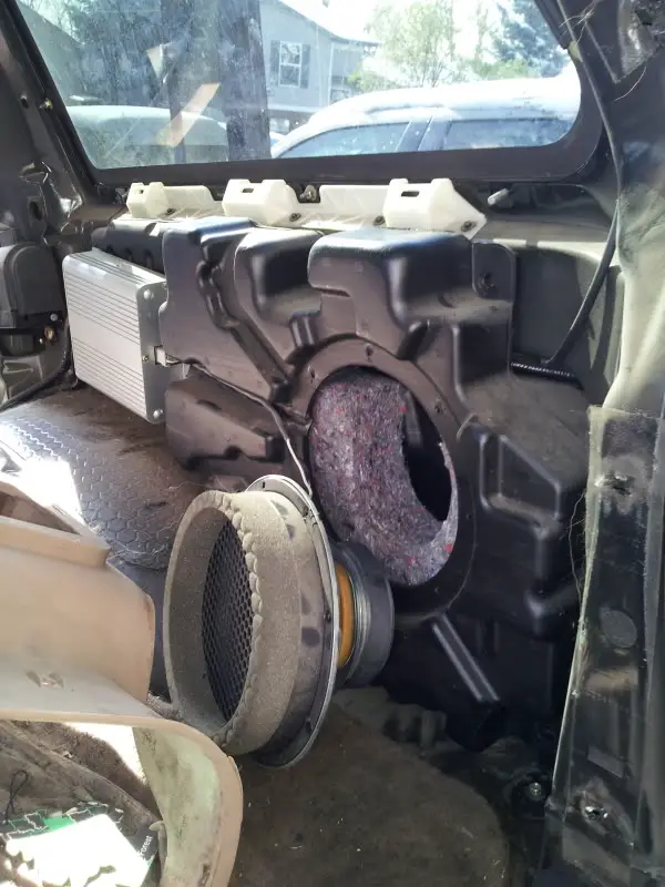

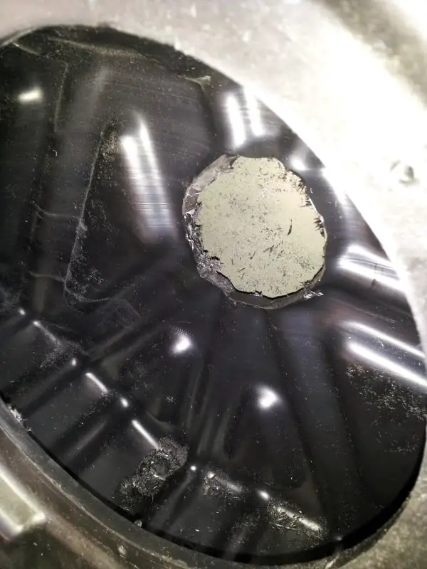

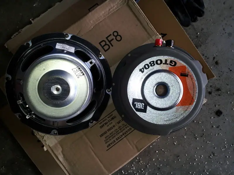

Also replaced the 8 inch sub in the back it was blown.
I had to cut the back since the sub was just a little to deep. So now I have a ported box still sounds good just need a bigger amp since the JBL is good upto 800 watts.

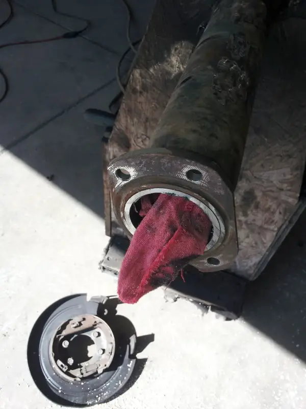

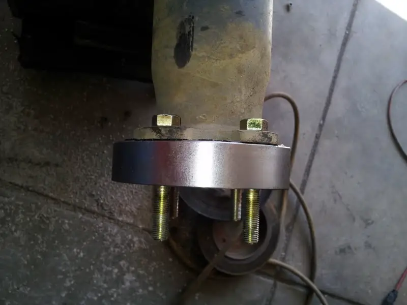

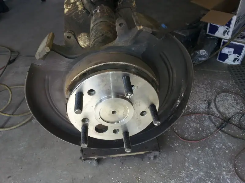

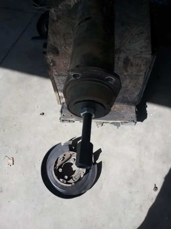

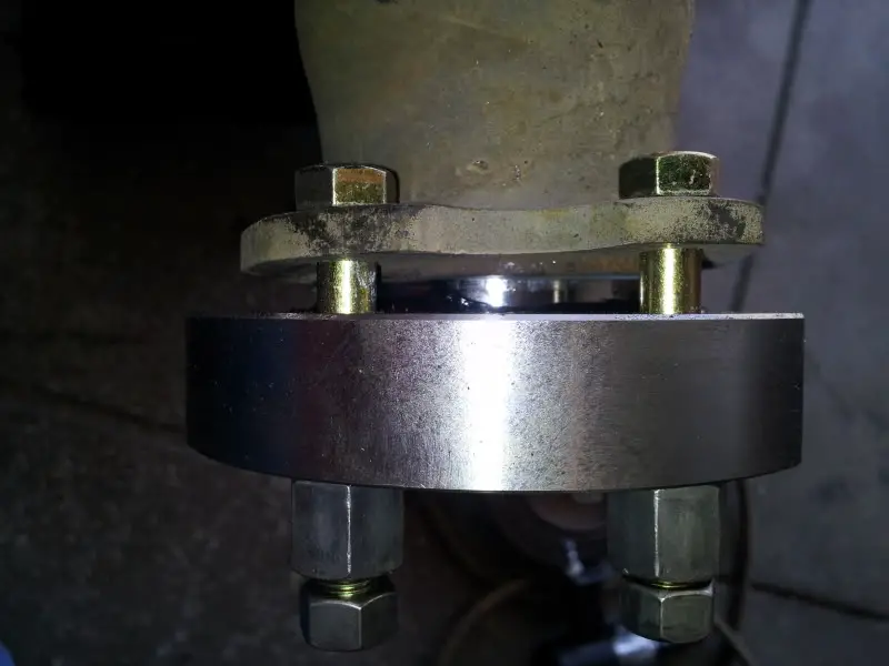

Install the Ultimate 88 kit in a customers axle Yesterday mine should be going in this weekend if I have time. The kit brings the factory axle from 58.75" to 61.5". So now my rear will be wider then my front. I did not know that would be the case when I ordered it cause I could not find any info. But I am happy that it is. The kit is super beefy I am impressed here are few pics of install.
Pulling the old bearing and seal out.
Cutting the end of the tube off that holds the bearing and seal.
Installing the new bearing seal holder/spacer you can see the RTV down inside the spacer to help seal everything up.
Ready for backing plate and axle shaft.
Ready for action. This axle is going to the 5x5.5 bolt pattern.
You can see how much the new shafts go into the spiders.
That kit was pretty easy to do just took some time. I had to take one of the shafts to a place with a bigger press cause mine wasn't big enough. The other went right together with my 20 ton press. Not sure what was up with that. I put one of my shafts his this axle waiting for phone call today to see if they got the other one done. If not I am calling Yukon and going to raise hell! LOL
