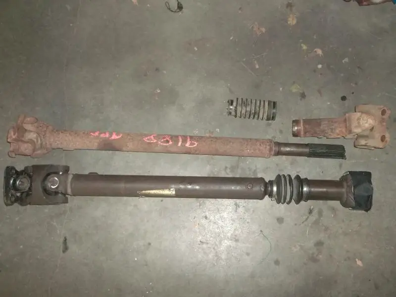

Great, so what is the length of that F150 shaft, short and long lengths?

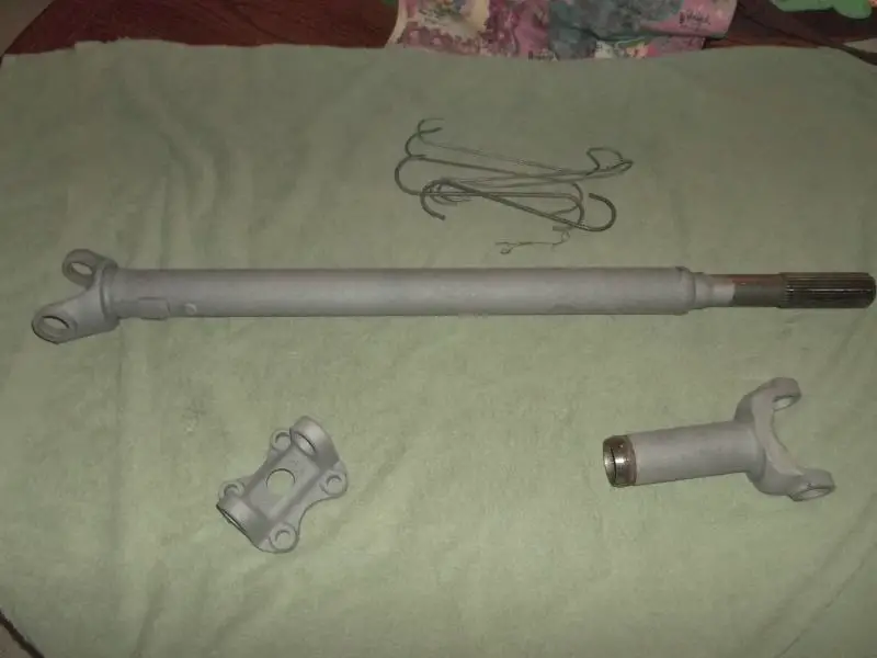

After a thorough degrease and rinse I baked the driveshaft parts at 450 for about an hour 15 minutes. Basically until they quit smoking. Then I spent about 1 hour 15 minutes blasting them with crushed garnet. I used some duct tape to mask off the splined areas before blasting, to keep them free of sand. The front yoke has a bit of a "rust ring" but I needed to cap it so there ya have it--
From this
to this

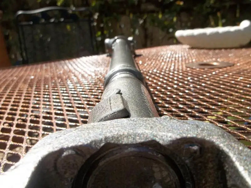

I am going to sleep on a color choice, kinda pooped. I have some Titanium Metallic to use up, I am kinda swayed to that. Hmmm, titanium drive shaft. I like the sound of that.
What's the titanium color you have look like, is it kind of a gold tint?
my vote, clear coat it and leave it as it sits
When clear is applied over blasted metal it kills the glimmer and sort of "yellows" it . I do have a silver color which look very close to blasted metal though, with clear over it.
I can compress it to 32.5" from rear flange face to u joint center. At least 36" extended

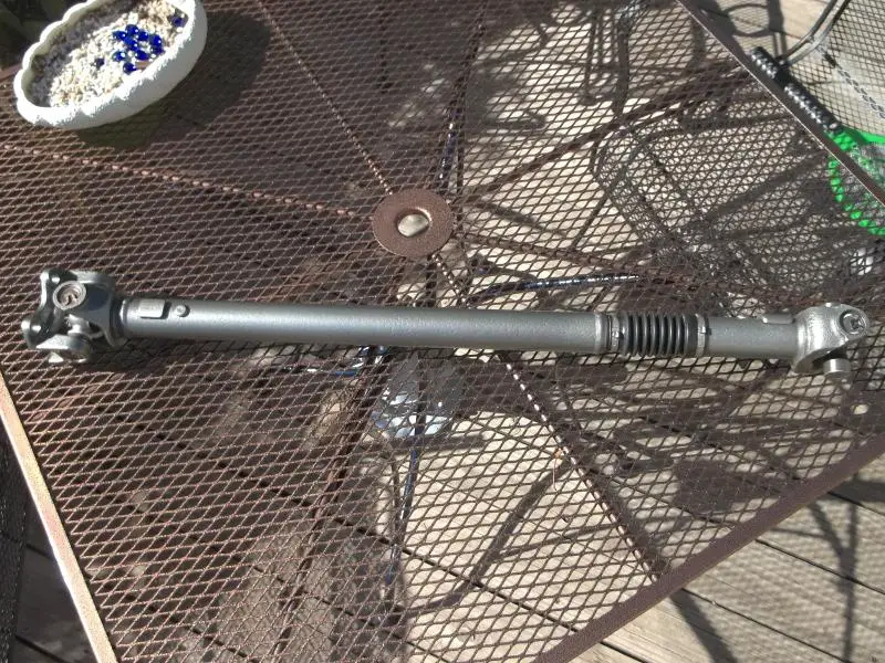

It went together very nicely. Gonna take a break and then throw it in for a road test! Aint it sexy!!

Success!!
F150 drive shaft in and she drives smooth as silk. I probably shouldn't say this but she finally hit 80 MPH shake free! Woot!

So the installed length is very close to 34" then, and the end joints should be as pictured there, called parallel?
