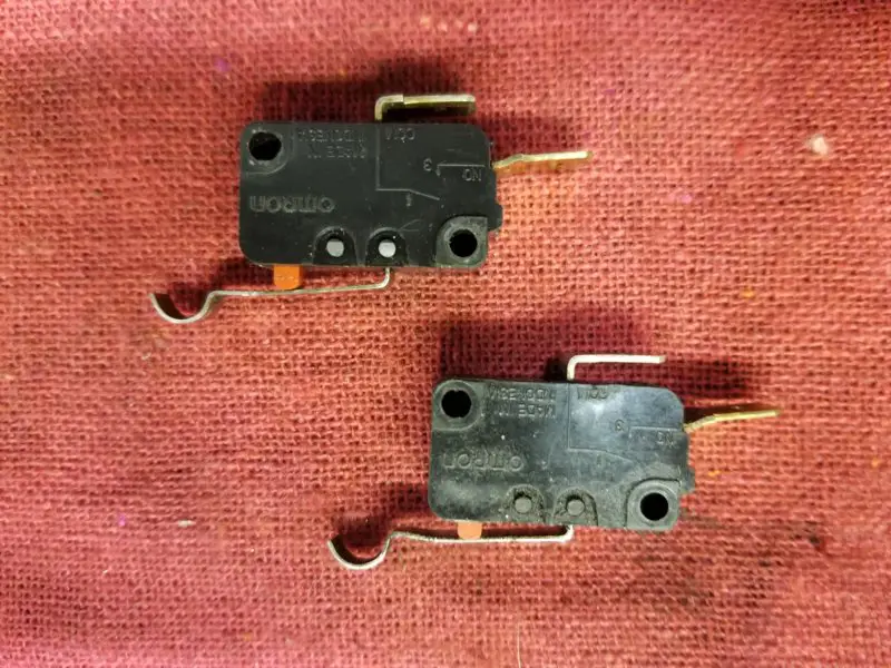

It was pointed out to me that my reverse lights seemed to come on at random. I traced it to the reverse switch in my B&M shifter. There are two switches on the shifter. One for the reverse lights, the other for the safety ignition lockout (won't let the Explorer start while in any gear but Park and Neutral. The switches are the same so I ordered two. Figured I might as well replace them both while I had it apart. The switches are located on the driver side of the shifter. They would be easy to remove/replace without a center console in the way. It uses tiny little nuts and bolts to hold them in place.
Switches
You will notice there is only one nut because the other one got lost.
I ran a magnet around, looked as much as I could see without removing the console, I did not have a nut that tiny in my bolt drawer so I got creative. I knew it would be just as hard, if not harder to install the nuts as it was to remove them, and since I had already lost one I had to do something anyway. I got out my good set of taps, but I did not have one that small (4-4). I pulled out my POS never used HF tap and die set I purchased a few years ago because it was too cheap to pass up, and the smallest tap was the right size for the bolts.
I keep a lot more scrap metal than I should, usually anything I could make a gusset out of or reuse for something. I went through and found a little piece of 1/8" flat bar and made it into a double nut with a tab that extends out past the switch mount. I really thought the tap was going to break, but it made it through both holes.
Test fit looked good, but realized it would be easier to get to the tab if it was bent up slightly.
That little bend in the tab allowed me to use my needle nose vice grips to slide it in place to line up the bolts. Used a little thread locker to keep it there. Next time I need to get in there, it should be much easier. Someday when I remove the console for a different reason, maybe I will find that tiny nut.
