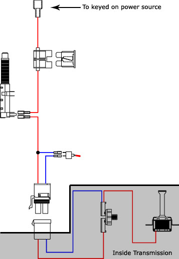

I have noticed recently that the 700R4 transmission torque converter isn't locking up with the switch in 2nd or 3rd. Having the option to lock it up really cuts down on heat buildup due to friction. The way its wired is like this;
It automatically locks up in 4th (OD) and I can feel it. It has a brake light interrupt so when you apply the brakes it unlocks, and I can feel that. What I can't feel is it lock with the switch in 2nd or 3rd. The blue wire in the diagram is the manual lock up wire. There is power going to the transmission for both the automatic lockup and the switched lockup, so it must be the blue internal wire. I called Bowtie Overdrives and got someone helpful. He said it is as simple as it looks. The switched wire bypasses the solenoid to activate the pressure switch, locking out the torque converter. I should be able to feel it lock and unlock. If the pressure switch and solenoid are operating when the trans is in OD, then it has to be that blue wire not getting power to the pressure switch. He also said if I stick my ear to the pan, I should be able to hear the pressure switch click on and off. Might have to drop the pan on the trans, again..
Edit: I extended the tubing on a old stethoscope so I could reach in and flip the switch and taped it to the trans pan. No click, no clunk, no nothing. Guess I need to drop the pan, again...
