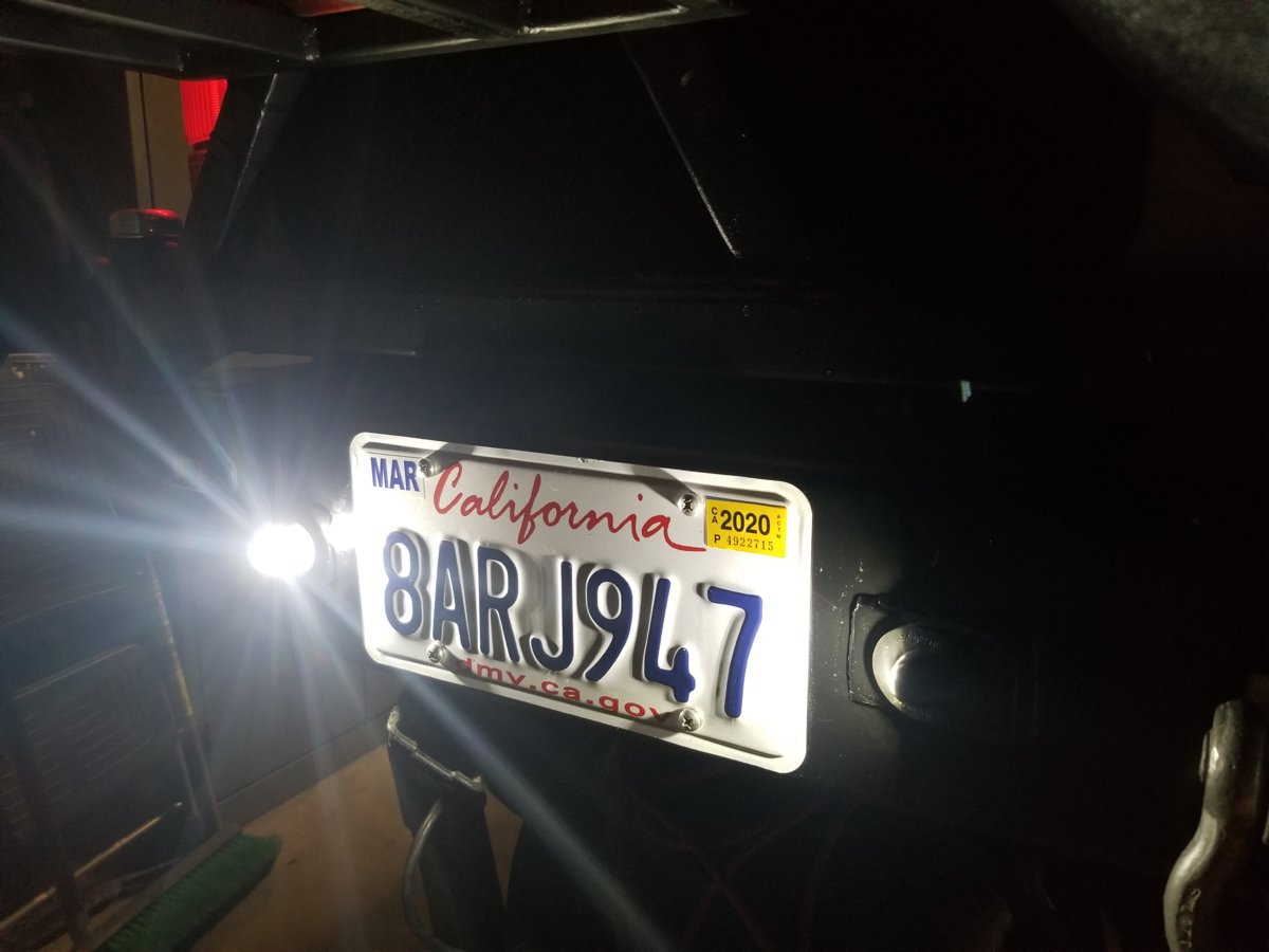

I bought a set of LED license plate lights off eBay and they are way too bright. I would not want to be behind someone with these, so I need to figure out how to tone them down, or repair my OEM light housings that fell apart when I removed them. Stupid BRIGHT
I bought a set of LED license plate lights off eBay and they are way too bright. Stupid BRIGHT
Try a few passes of black spray paint over the lenses. . . It'll help tone down the bright.

They make a tint spray you can put on those led's or you can use some black paint and cover more of the bulb up so the light is not so bright from behind the truck....

The seller or the license plate lamps suggested I use a resister when I asked for a refund. I replied that was not acceptable and they sent me a full refund. I ordered a set of OEM type replacement lights off Rock Auto.

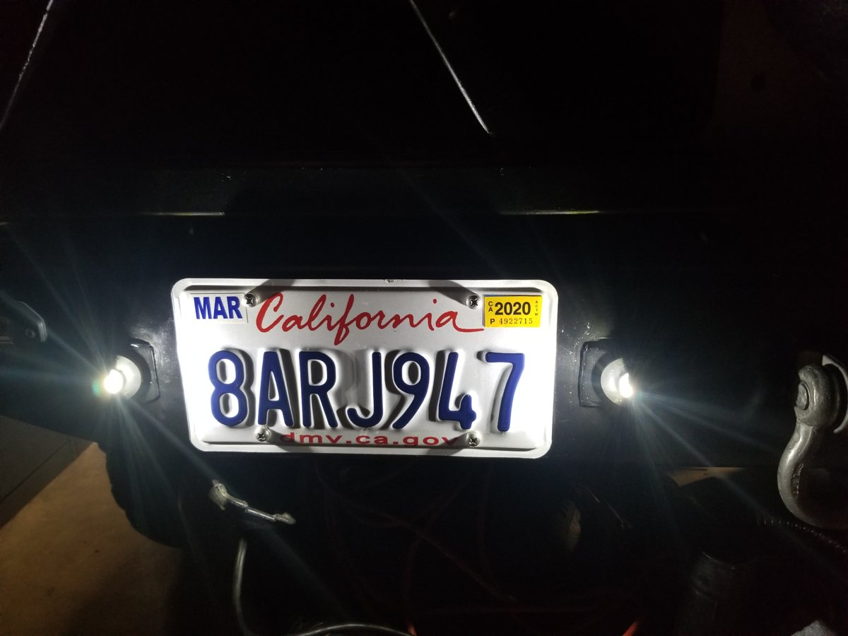

Today, I spray painted over 90% of the license plate light lenses with 4 coats of black. They still might be too bright, but need to wait until dark.
If still too bright, spray a light coat over the remaining unpainted part - - it'll knock the illumination down a bit more. . . Great job.

They are still too bright. All they are supposed to do is make the rear license plate visible during darkness. I bet one of the LED's they have inside the housing would take care of that. I think there are ten. I'm going old school and installing the new OEM type replacements that came in the mail today.

I went through a similar thing with the LED license plate lights, most of them are just too brite, especially from behind the vehicle. I finally found one that has 6 led's, is diffused, points down and has a black shade over the exposed area from behind. This is what I am running on the bronco and wifes FJ cruiser.

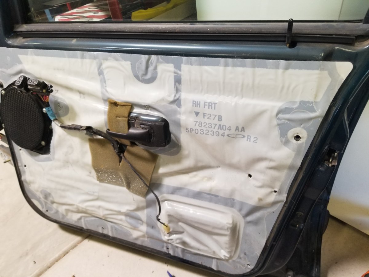

I ordered a new power window motor. I think I cracked one of the screw mounts on the driver door panel pull handle so I need to pull that apart and glue it back together. I almost purchased a new regulator (track) for the window, but I will just clean/grease the OEM regulator so I don't have to mess with the glass.

I pulled the inner door panels off the front doors. Both of the pull handles have been repaired a bunch of times and there is nothing left to repair. I found a set on eBay for 22.90 shipped. The old pull handles are melted on to the panels. I remember Brian1 did this repair a while ago so I will need to look up how he did that.
Edit: Found it, he ground them out with a burr. Seems the easy way to go
I have had an issue with the driver door handle for many years. I thought this might be a good time to fix it. When you open the door from the outside handle, the locking post drops, locking the door. No big deal if the window is down and/or I remember to unlock the door before closing it again. It looks like a spring holding the post up and down inside the latch assembly has failed. I really don't want to purchase and replace the entire latch assembly, especially since the three screws holding it to the door have stripped heads. Anyone ever had this happen and if so, how did you fix it?

For the stripped screws try an impact driver screwdriver with a HUGE phillips bit that fits those screws perfectly, otherwise = strip
Im a door doctor, whenever these trucks have a door lock or latch issue everyone seems to bring them to me. You will likely have to pull the entire drivers door master switch and rods all out, have a look at it and see what kind of mcgyver spring/ lever fixes you can come up with.
I'll have to pull screws out of the extra passenger side doors I have stored before I try to remove those. I was just looking at a hand impact that I found at my dad's shop. Might have to take that home.
I grabbed the impact driver I found in my Dad's shop, which is the same place the extra Explorer doors are stored. I pulled out the latch assembly and the actuator, along with the three screws. Getting that one out made me realize that maybe I don't want to mess with it right now. I haven't seen a 25 year old door as pristine as this one in a long time. My inner door seals are mostly duct tape at this point.
I got the door latch assembly out this morning. Had to cut new slots into the screws, and knock on them with the hand impact to get them to loosen. Spent an hour or so trying to figure out how to make it work and ended up ordering a new one. Its a tiny little spring that has broken. I got the same spring out of the right side door latch I had, but could not get it into the left side and have no reference because that one was broken. I think its installed, then the unit is riveted together. Anyways, waiting again for the UPS dude. Ford must have had a contest to make the most complicated door latch mech in history, and some engineer won. I took a few pictures so I can hopefully get it back together.
