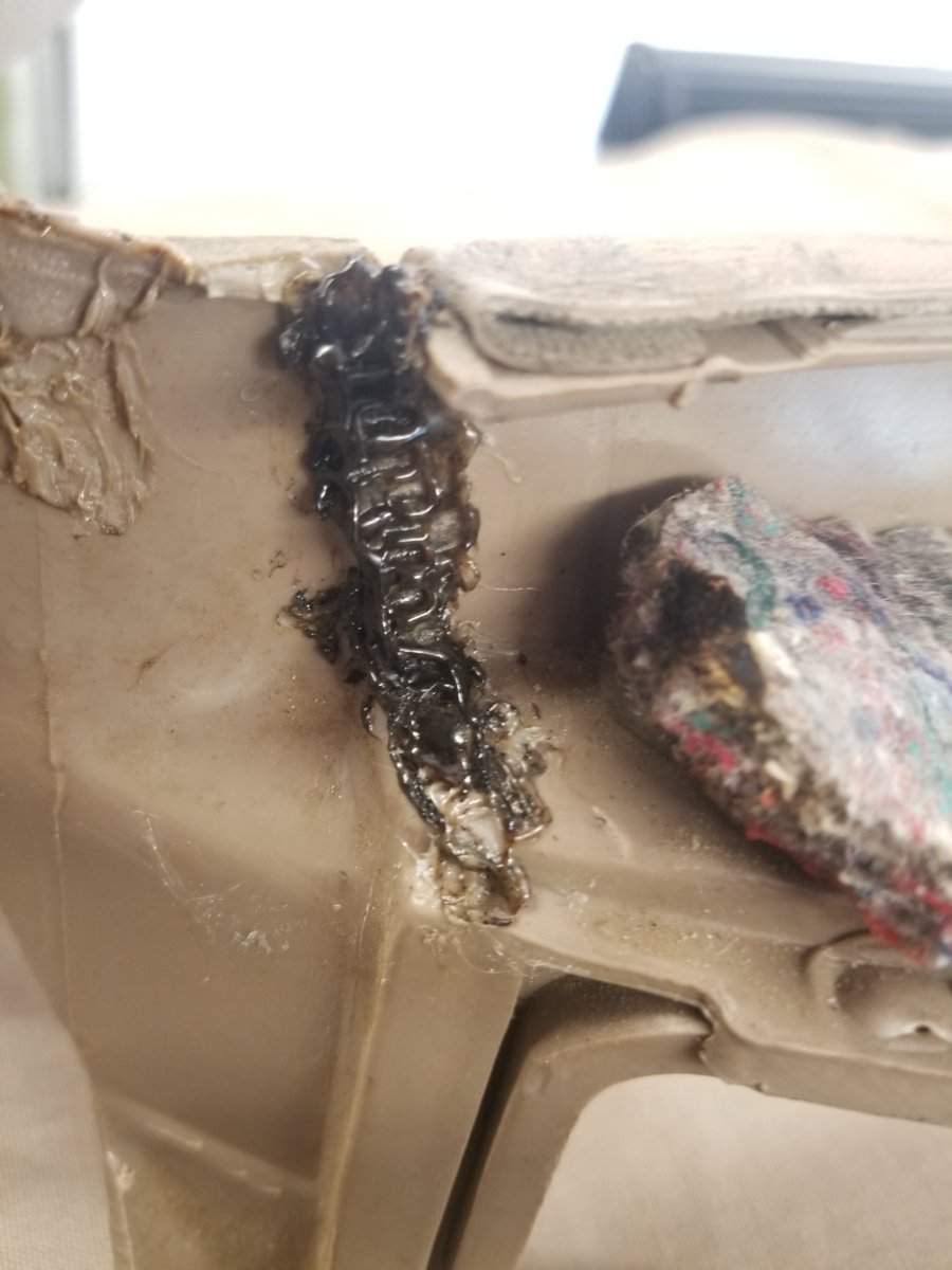

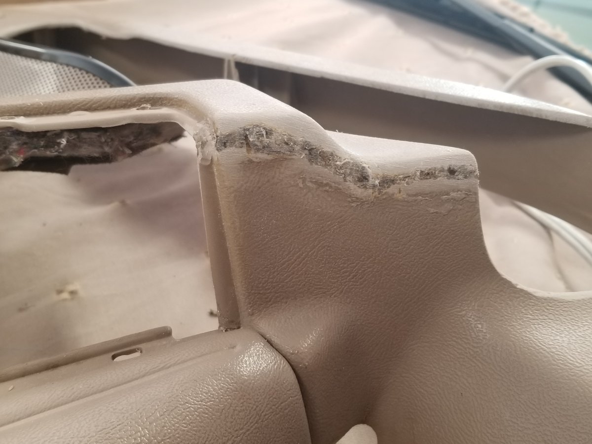

Today was door panel day. I taught myself how to weld plastic after watching a You Tube video. It wasn't that hard to figure out. I used zip ties as welding rod and a soldering iron as a tig. There were several cracks on my door panels that I have been repairing with epoxy, only to have them crack again in short order. One trick I learned is to remove as much of the epoxy as possible before welding the crack. It has a completely different melting point and becomes very brittle when it cools. On the largest crack, I had to repair it on both sides and add quite a bit of plastic before it became solid. Its visible so I sanded down the outside but am not planning on painting it or color matching it in any way.
Inside of panel
Outside after sanding

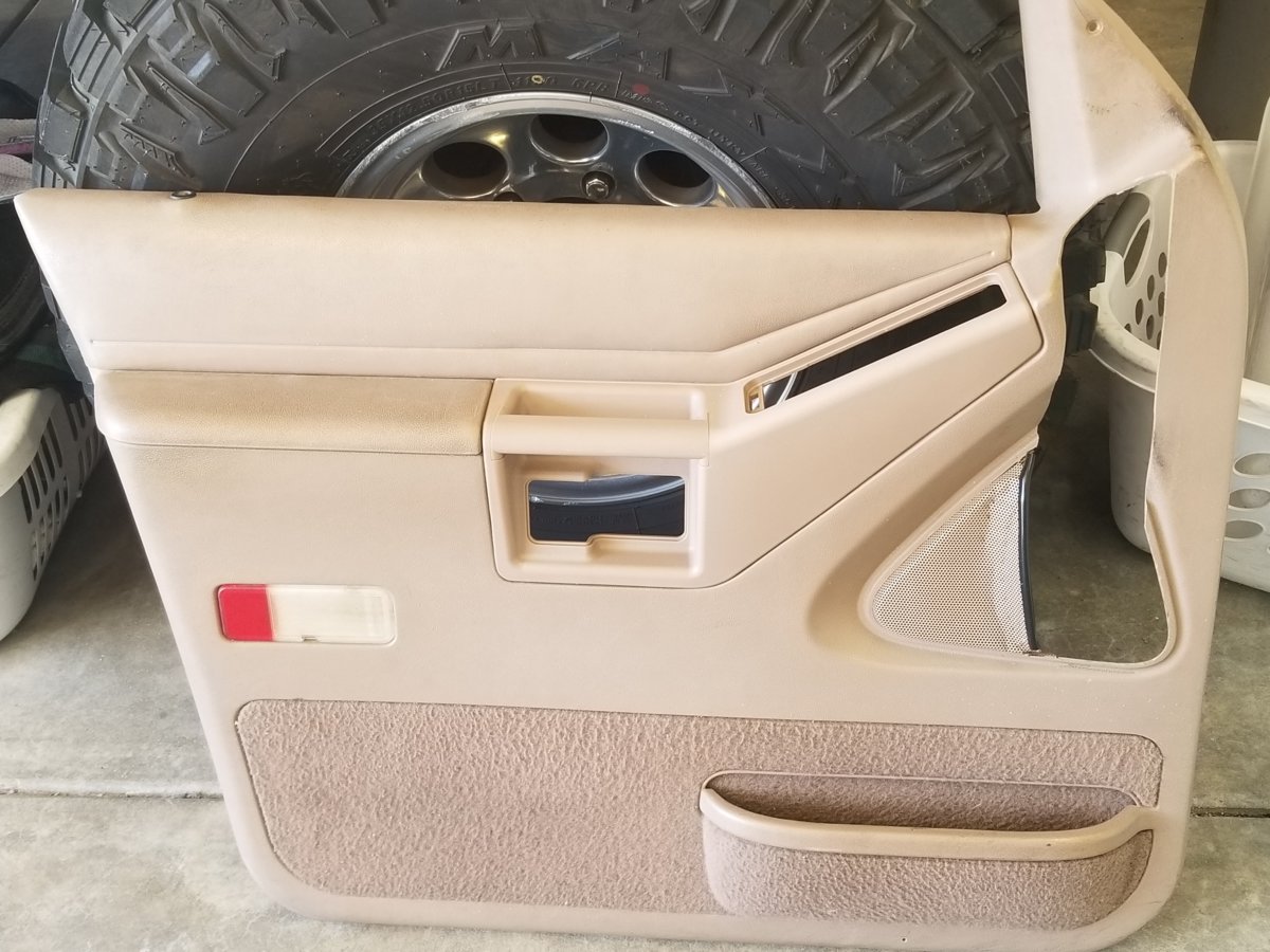

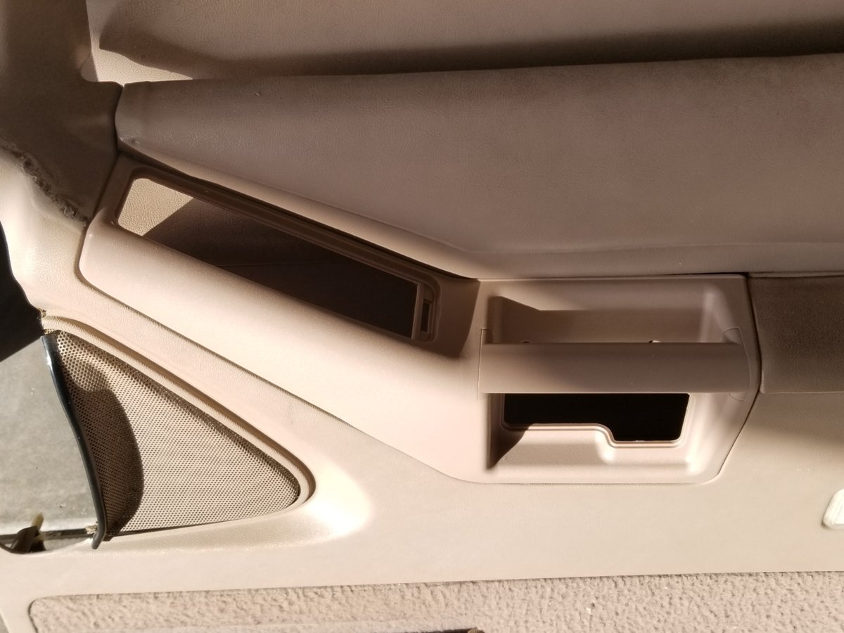

Also removed the old door pull handles and replaced with new. Old handles have tabs that are melted to the door panel. I ground them out with a Dremel and a burr (got the idea from Brian1). The new handles have press on clamps, which seem to hold well. The color is close, but not a perfect match. I am pleased with the result.
Old, busted up pull handle
New handle

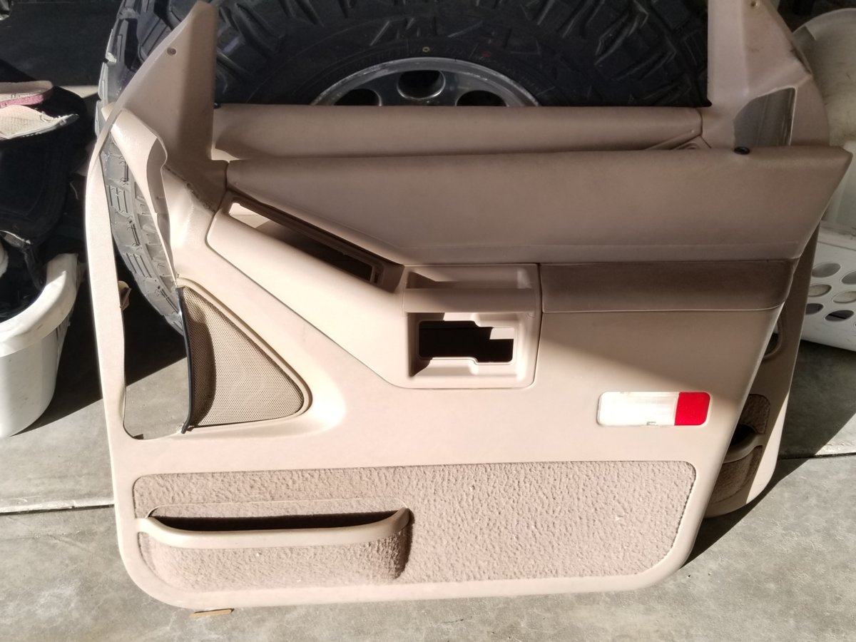

The vertical slots are for the cage A pillars to clear the doors.
