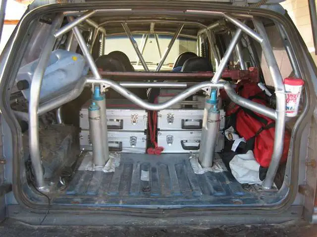

You're probably sick of me posting this photo Sean but I used this shrink wrap tape that hasn't peeled off the floor in a year and a half, it moves when it has to and the dirt in the rear is minimal.
I had a fancy design in mind, then realized if it works, roll with it.
i like it, good idea. and super cheap which is awesome.

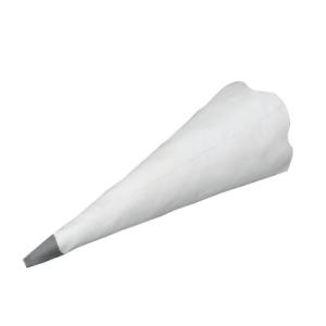

I used grout bags from home Depot to seal around the shocks. They are cheap and easy to install using hoseclamps. Sorry for the horrible pics but thats all i could find from when i had that setup.
