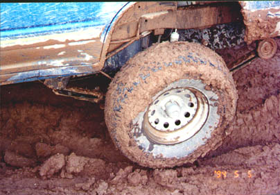

Well huge change of plans on the rear end. Got a set of 13 leaf nationals for a bronco for a price i cant pass up. They are almost on, so the plan is now to go through the floor with some 18" FOA's. I will see how i like this setup in race conditions, if it works well i will run it. If not then it will be linked...
Full droop pic here. I need longer brake lines before i can really do any testing.

that leaf pack is a monster
Yeah it is lol. After driving on it today its very very stiff. Im sure its a combination of the crappy pro comp shocks and the leafs. Im gonna wait till i get the hoop setup and new shocks. Then if its still too stiff ill break apart the leaf pack and remove 2 leafs.
are those stock length leafs? What shackle are you running for that much travel? I'm not calling B.S. I just know that I've got 16" shocks and don't know if I'm even traveling 14" better safe than sorry though. I've ran a zip tie on my shock and haven't come close to using the last 1.5" on uptravel and have driven it pretty hard.
Just a heads up not sure the price diff between 16 and 18 inchers. If you go too long on a bypass shock you'll never even hit the next levels.
If you take the top cross bolts off the spring clamps you can get more droop. The vertical pieces will keep the springs from splaying (is that even a word? :)) apart.
We cycled it some on the driveway with no shocks. The shackles are the POS autozone ones, and they will hit so i need to get some Camburg Or Blitz shackles. The leaf is actually 1/2" shorter than stock, and moved the axle forward about 1/2" but everything cycles and clears fine. The travel #'s arent exact yet because we ran out of time and i had to drive it today. But some quick measuring shows the springs will cycle 18" full droop to bump.
