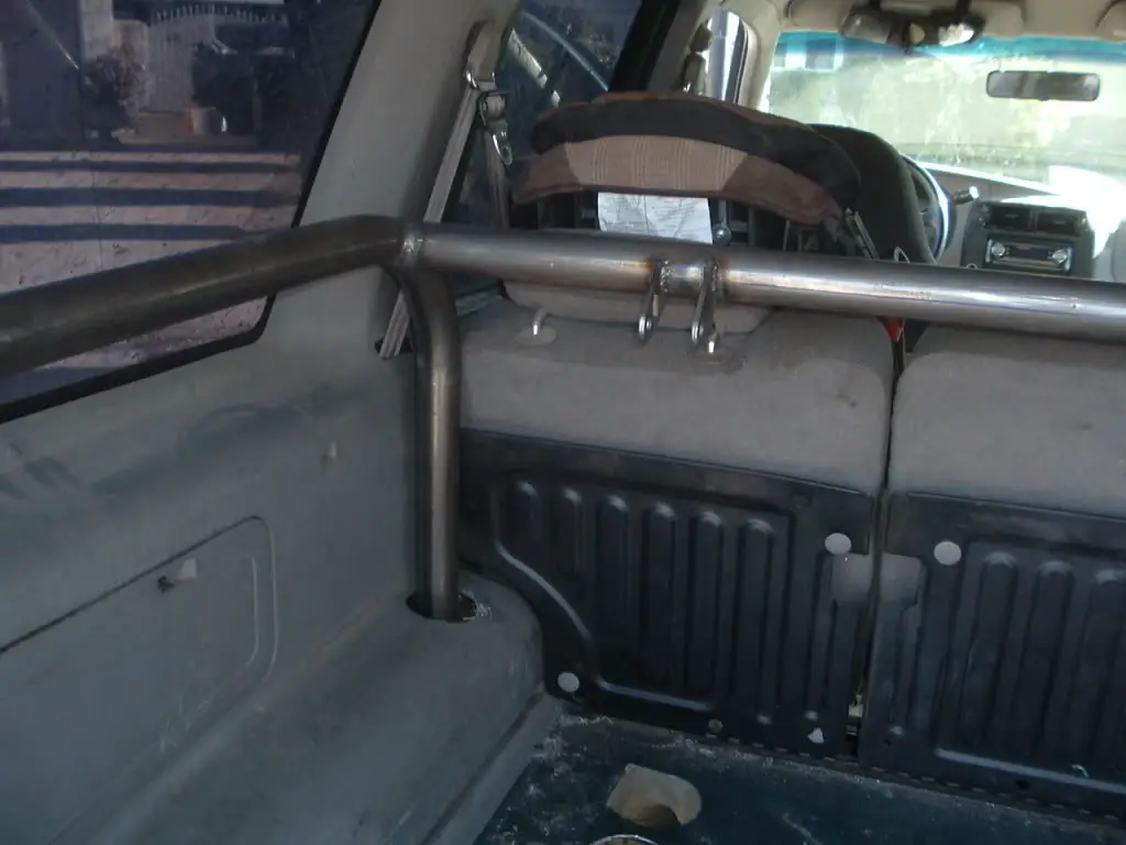

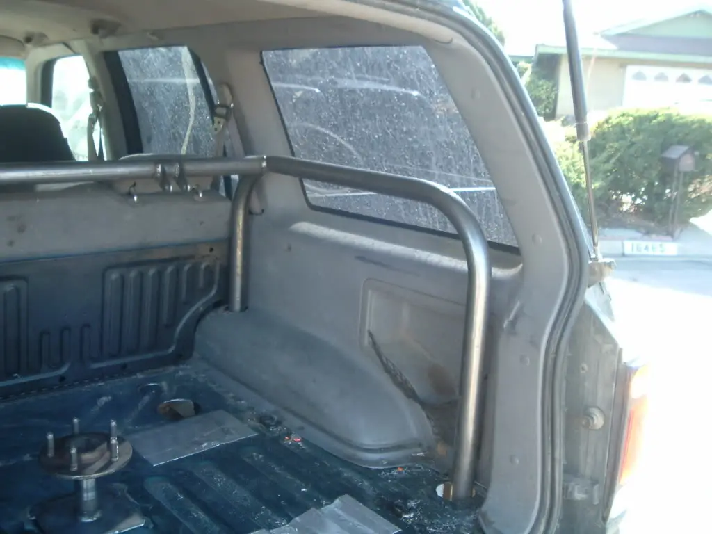

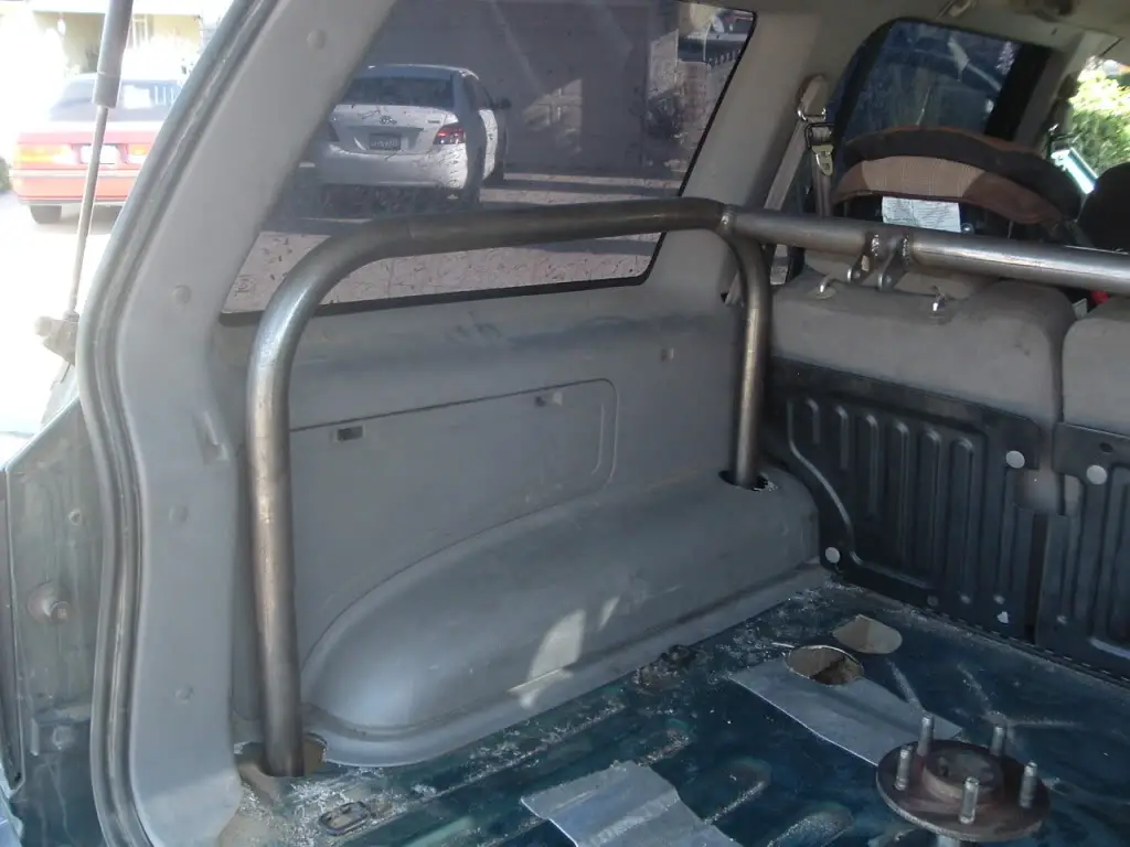

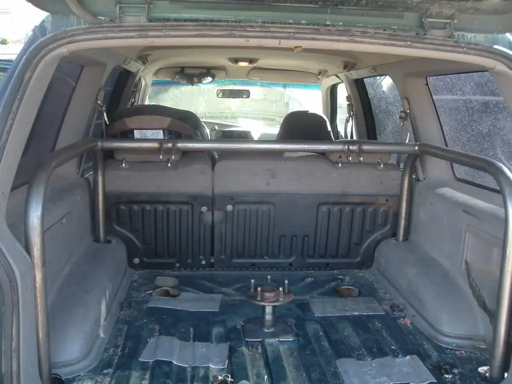

Well rear shock hoops are being built as we speak. Leaf packs was cycled last night and 15.5" of usable travel with very little leaf seperation. There is alot more there but the rear shackle hanger needs to be moved forward and longer shackles built. Ordered shocks last week so they should be here early next week. 18" FOA's cant beat the price at $390 shipped to my door for 2.5" shocks. Ill have some pics tonite of everything.

Im looking at racing MDR, MORE, and the new series Drive. BITD goes off of Score rules which for our explorers is 2" which is way to much for me lol. All of my cage points will tie into the frame, and after looking at it last night we found a super super simple way to cage our explorers. More details and pics on that later when we actually do it though.
Shock hoops.
Oh snap, i like how much useable space the trunk still has, that's a major requirement for me. Are you getting smooth body shocks or bypasses?

smooth bodies. bypasses are nice but a well valved shock will do perfect for me.
Also i love the setup because the cage will easily tie into it. still have my cargo area, and the shocks will be at a 1:1 ratio.
