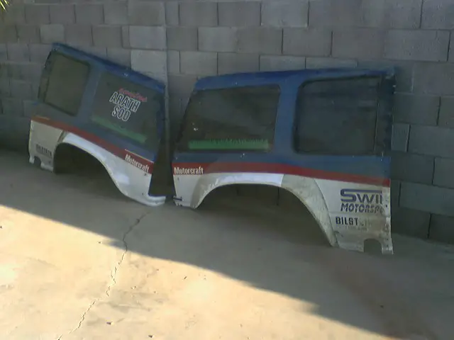

If you want to shed some weight I've got something that may interest you. No Turning back though!!!

That's not going to happen...I've already looked into it.
I've hung onto that glass and I've decided the only way it will ever be used is a serious date with the saw-zall and plenty of d-zeus tabs along with total elimination of the rear gate. Basically your roof would get welded to your cage and the fiberglass would bolt on to tabs.
