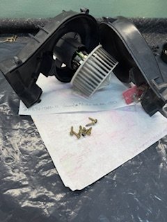

We need a rear a/c blower motor ... where to get good one?
I've acquired three so far with inoperative motors ... bummer. Are these possibly serviceable?
Need to keep Nana happy and grandchildren in comfort. Thanks for any help. Greg / Florida

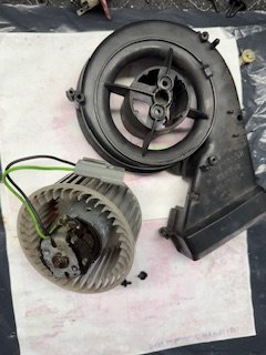

I have provided 12V directly to the original center console blower motor with no positive results and... unfortunately the other two we obtained from my local salvage yards (both resellers each stated... motor should be ok for you).
My power feed (pink/white) from the front connector is 12V active.

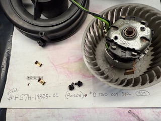

Convinced a working motor will be the solution for me. I am soon attempting a motor tear down to hopefully make a repair.
Off Topic: After removing the center console - dang my carpet is filthy in this family ride. Hah!
Green(12V) / Black(ground) - powers a good motor... when I have one.

Do you have a picture of the motor itself? or is it incased inside the plastic housing as photo'd. above?
