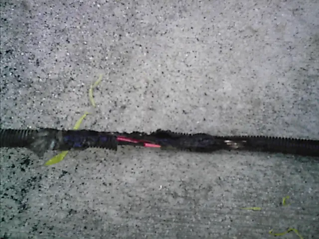

Well Ladies and Gentlemen I think I have the cause of my problem......
My buddy calls me up and asks me if i wanted to go lunch i said ok but i am comin in the Escort ekk convince me to take the X instead. So i am headed towards his place and I hop on the fwy.
I take off from a dead stop down the ramp.....1st gear....2nd gear......3rd gear......uhhh 3rd gear....no shifting into overdrive and or t/c lockup!:eek:
so once i arrived at my buddies place i dive under the truck and take a look at the trans wiring to find out that the harness had come loose and is melted/shorting against the header!!!!
so i now have a new used harness from thr junkyard and i am gona install it on Wed. after i get back from work
I am keeping my fingers crossed that this will solve my problem
well see on wednesday.......

The verdict is in...
Well it's good news bad news
The Good: Got the harness installed and now have my OD back and routed the harness Correctly :o so it off the header and other heat sources.
The Bad: still have the CEL coming on and staying on and i cannot get the code reader to read the computer still getting "vehicle not responding"
Hmmm now i am thinking the computer might have suffered some damage over the shorting burning wire harness.
still got one thing left to fix tho i have to replace the O2 sensor since it has burned against the headers also. luckily i have a few spares of those:D

any who....... heres a photo of the carnage.......

Update
Well it looks like i am going to be searching a another Computer since replacing the wiring harness only solved part of the problem with the no O/D
drove it to work last night on the fwy and it shifted into O/D but i did not notice it lock up the converter or maybe it did an i did not notice. but it seems the the RPMs were higher than normal.
before all this happened it would run about 2k RPM's with the converter locked up. And now it it like 2500 RPM's and jumps to 3k with you step on it to downshift it out of O/D.:rolleyes:
