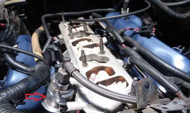

If the FPR looks like this, i would change it.

It is actually all dirty, and most likely the original. It only has 83k miles on it, but from what I understand there aren’t many of these first gen’s on the road with original regulators, reguardless of mileage. I’ll get a picture up soon. Just gotta wait till that next paycheck hits to replace it lol.
P.S. Those zip ties are holding the vacuum line on the FPR. It’s so slippery with fuel it wont stay on.
Any fuel on the vacuum side of the regulator means the vacuum regulator is bad
There should never be fuel in the vacuum line
You need to test fuel pressure if it acts up after replacing the fuel pressure regulator
The only way fuel gets to the vacuum side is if the diaphragm rips

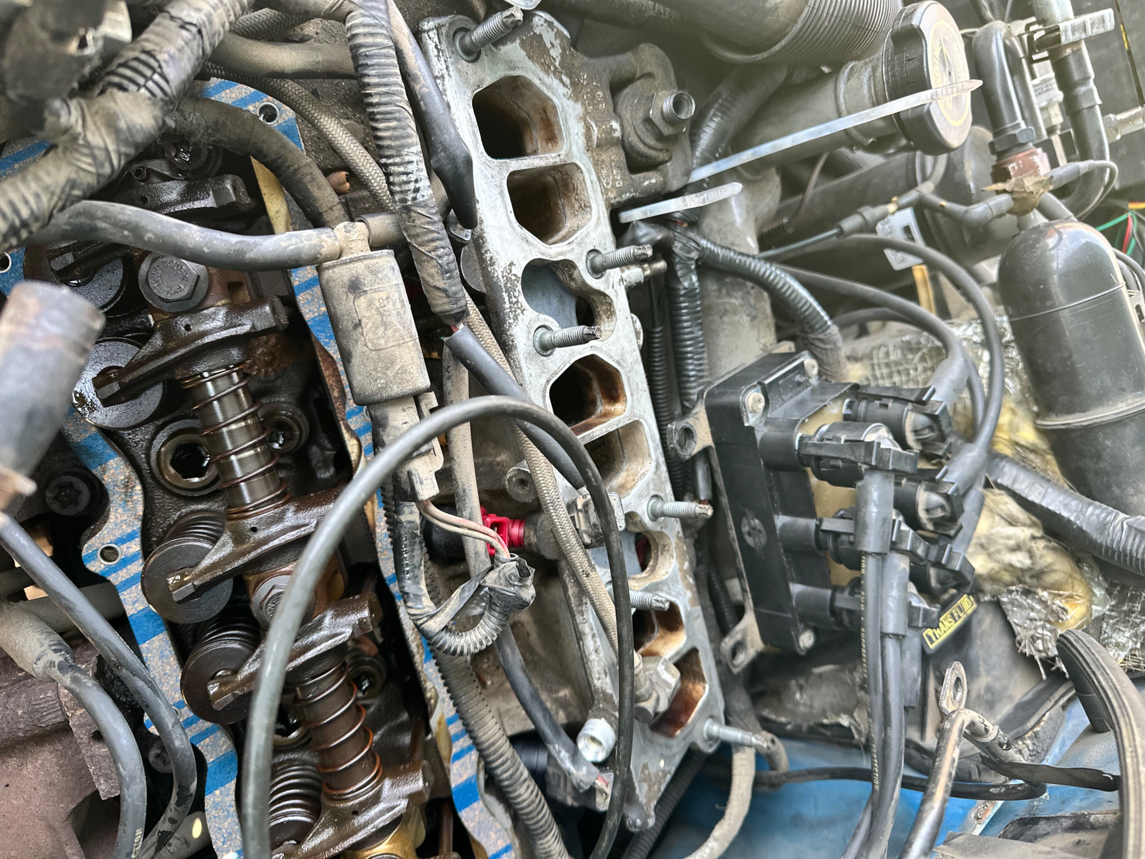

On the list. lol. I have the lower manifold off right now since I have a coolant leak at the front drivers side, leaking down the block over the fitting for the oil pressure sensor and onto the ground. I could not for the life of me figure out where it was coming from. Sure enough, I take the lower manifold off and gasket around the front drivers side water jacket is split/cracked. I’m hoping thats the problem and not a head gasket lol.
Lower intake gaskets are known for this
Have a good look at your freeze plugs too they can leak water in that location
Sound Like you found it! I say it all the time, there is not a out 4.0
Put there that does not need intake gaskets they simply do not last 25+ years, especially not with ethenol fuel
