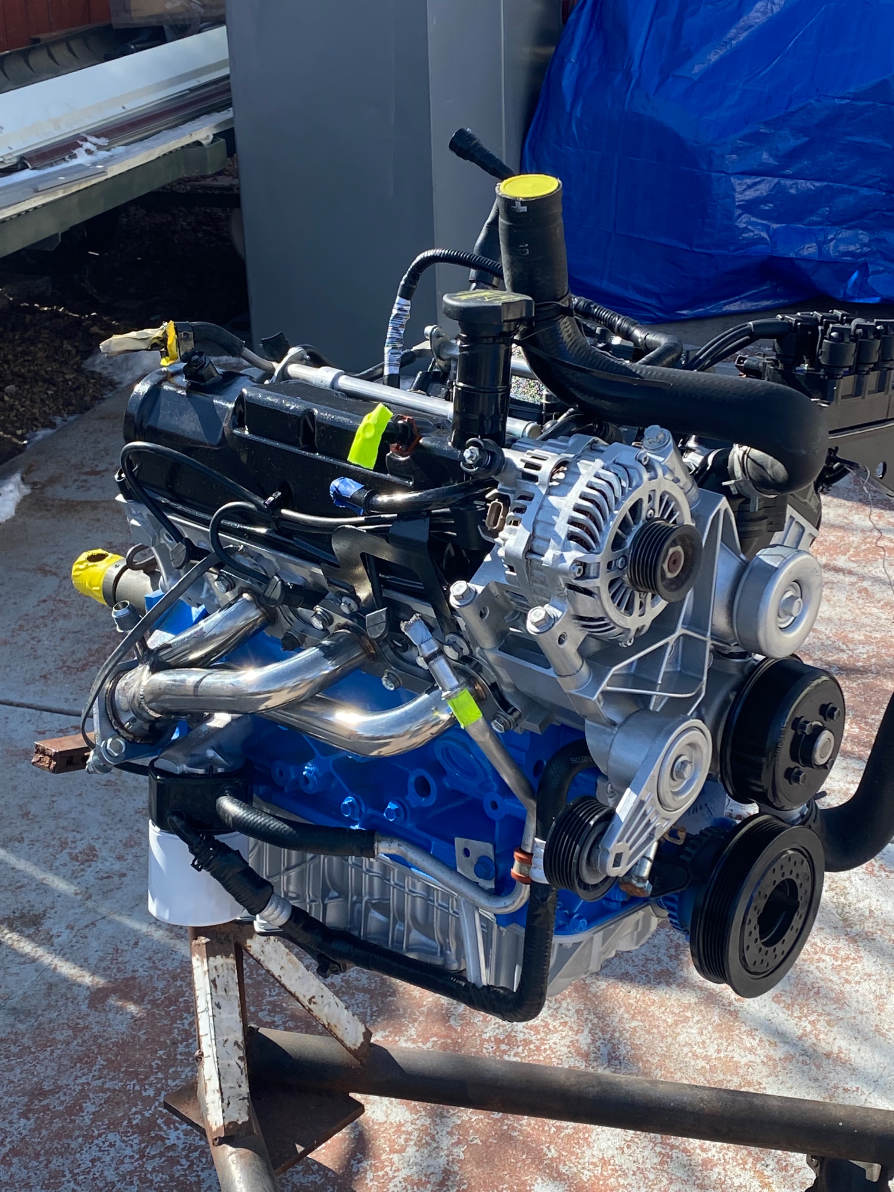

I have a rolling idle up and down. I have replaced injectors, New Motorcraft EGR,MAF,Fuel pump,FPS as well FTPS,Purge Solenoid,Canister,New PCV, Crank and camshaft sensor and Both upstream 02’s replaced twice now. Still Getting P02198 Rich also P0300 Misfires 1,3,5,6 New coil as well. Tried spraying at cool start up around intake, as all intake seals replaced when installed Bosch injectors. Is there a common vacuum leak or a pinpoint location the plastic intake can crack to focus on. Next step smoke machine. I forgot to mention New Cats have very little run time. As watching my 02 sensors on test drive start out at 6.50 then work their way up to 9.00-9.50 rich out. Fuel trims upwards of -25 then they all zero out go to limp/default. PCM was tested out run through live simulator and updated software as well check out good and sealed up. Real PITA
That is a possibility as with so many counterfeit parts out there like Bosch etc knock offs. As i did buy from a reputable supplier granted like you said still could be bad right out of the box. The Motorcraft plug wires have low hour run time but i’m going to buy new NGK or Accell wires to rule out. Thanks for your help, as i have put in many many countless hours on my build up.
