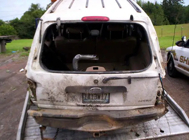

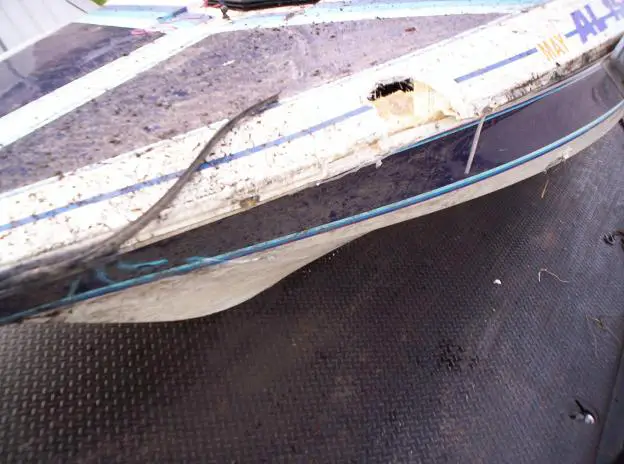

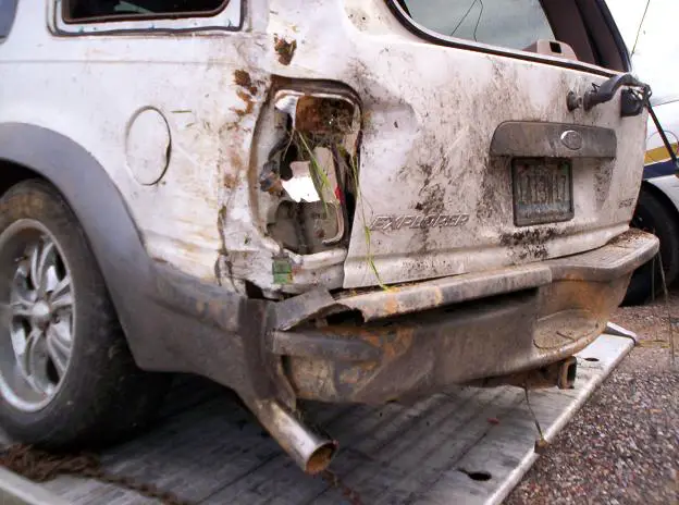

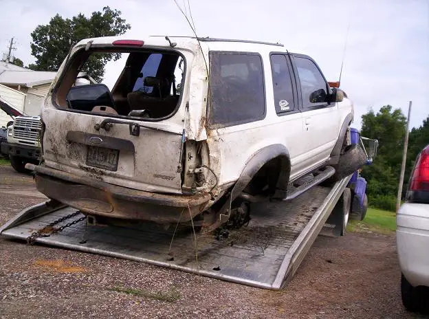

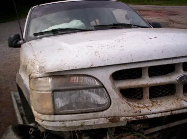

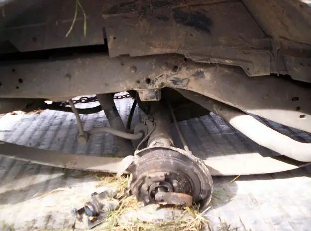

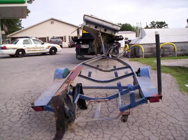

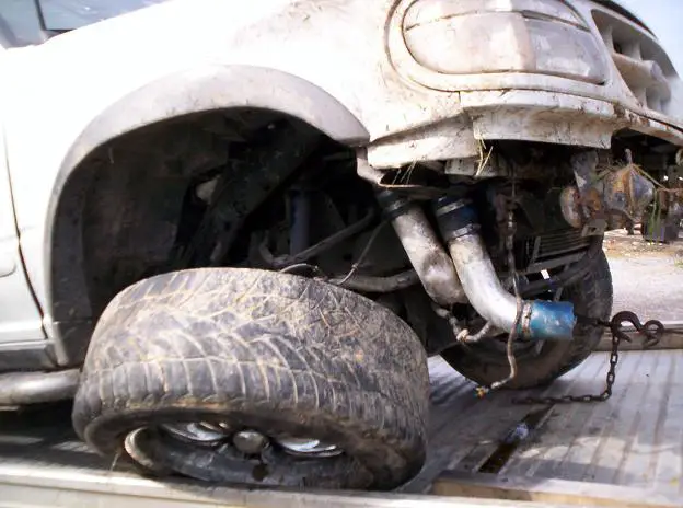

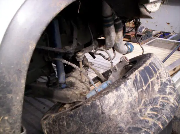

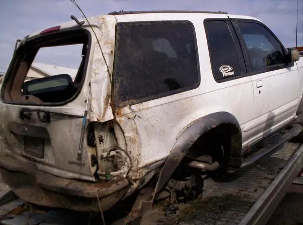

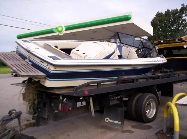

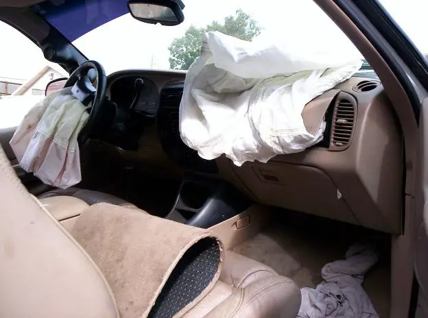

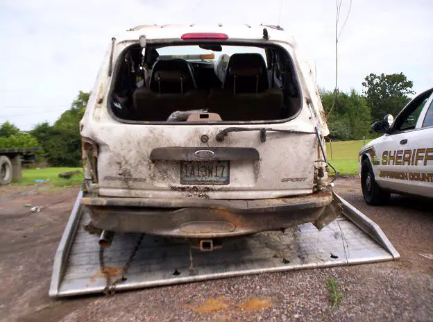

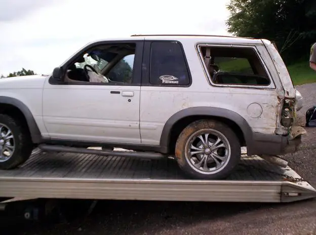

Just thought I would let everyone know (especially if you have sent me a PM in the last week why I have not responded. I was in a serious wreck Sunday night about 20:50 hours and well... the pics speak for themselves. I will have to say I basically walked from the wreck with minor head and chest injuries, otherwise I am blessed to still be here.

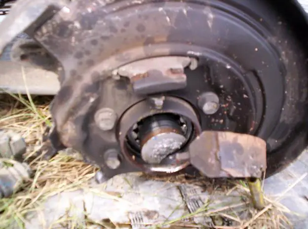

I had a vibration I couldn't find for the last year, I have rebuilt everything in the rear. Bushings, bearing, seal, etc. to no answer. Sunday night I found what it was- the right rear axle apparantly was cracked and it finally completely broke. I was driving straight up a hill and the vehicle took a hard left for no reason. Totaling the truck and my tournament inboard ski boat.
Everyone if you have rear end vibrations please pull your axles and have them magnafluxed. This was my next step but I never made it to it. Jake, especially you if you are going to do any dragstrip launches on slicks. The vibration would come and go and wasn't ever consistant.

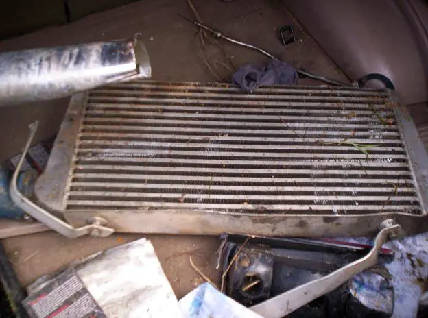

Pic of intercooler-overlook the dirt and so on. Everything in the back got thrown out of the truck. We scraped it up and chunked it in the back of the truck

For anyone else with high HP/torque, maybe a full floater axle setup would be safer in the long run
Sorry to hear that James. Glad you are safe though, that is the most important part.
This hits a little close to home since I had a bent passenger axle shaft when I purchased my truck and didn't realise it until a few years later. Scary to see what the outcome could have been.
