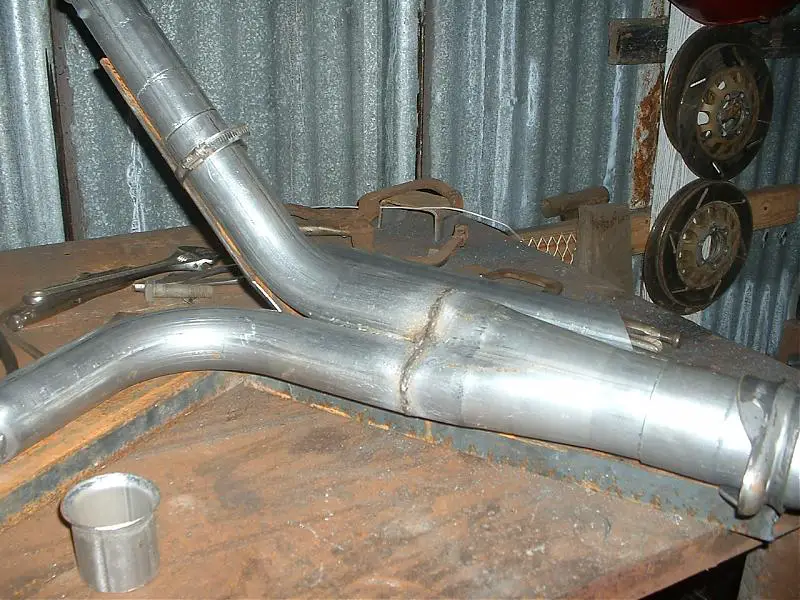

I wastn't gonna post these but what the hey. It's ugly right now but you can see some of the changes being made to this y-pipe.
What made you go with this style Y pipe over the Y pipe that you had made out of the magnaflow peice? Also, which style magnaflow muffler are you running? How does it sound? What has the cat done as far as noise?
Af - We wanted to start making everything and was shooting for more of a "Header extension" look. I'm running a regular 2-1/2" inlet/outlet magnaflow. The sound is deeper than the Gibson at idle, and maybe just a little loader. At wide open throttle, the sound is allot different than the Gibson, and much louder. I'm actually starting to like the sound.
As you know, these are just my opinions and I really need to get a sound clip for you to make your own decision. I believe the cat actually "cleans" up the sound, but I haven't ran without the cat on this combo, and don't plan to.
The transition on those pipes is far better than the cheap type of y-pipe, where the flow hits each other at a sharp angle. Regards,
Yap - That's exactly why I saved the headers for one of the last "NA" mods. However, I was a little surprised on how they actually performed. I guess I told myself along time ago not to expect much. They perform a little better than I thought. Now, I'm not sure if I'm feeling this because of the headers, the headers and y-pipe, or the headers;y-pipe, and entire exhaust. Who knows, but I do feel that I have the right combination.
Anyone looking to make there own y-pipe, this is for you. I've tried a 2" y, a 2-1/2" Y, and now a 2-1/4" y. The 2-1/4" is just the right size for NA (My opinion). And 3" single is not too much for N/A. Again, the point is to try and hit right in the middle, and aimed for torque.
