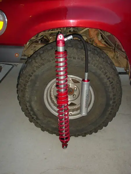

Got my coil-overs a few weeks ago and forgot to post a pic:
2", 14" travel, Eibach springs
I wanted to start last weekend, but I didn't feel like working in the 100* heat. Maybe next weekend.

Those are the same coilovers that I tried to go with when I did mine. They ended up being way too long. I could have made them work by bringing them up through the hood a few inches, but that was going to require a little more work rerouting fuseboxes and such that I just didn't feel like dealing with. I'm sure you'll get it done though

Thats what everyone that has seen them says. . .and I didn't even plan it that way.Originally posted by JoshC
That's cool that you got the red, matches your truck.
All my homework so far says that the top of the c/o will be about 2" below the hood. Thats no sweat though. . .its fitting them plus the hoops all in next to the master cylinder on one side and A/C on the other, while still keeping it symetrical. (I think I'm gonna end up ditching the A/C [I'll just have to use the compressor for on-board airOriginally posted by Mudd*****
Those are the same coilovers that I tried to go with when I did mine. They ended up being way too long. I could have made them work by bringing them up through the hood a few inches, but that was going to require a little more work rerouting fuseboxes and such that I just didn't feel like dealing with. I'm sure you'll get it done though![]()

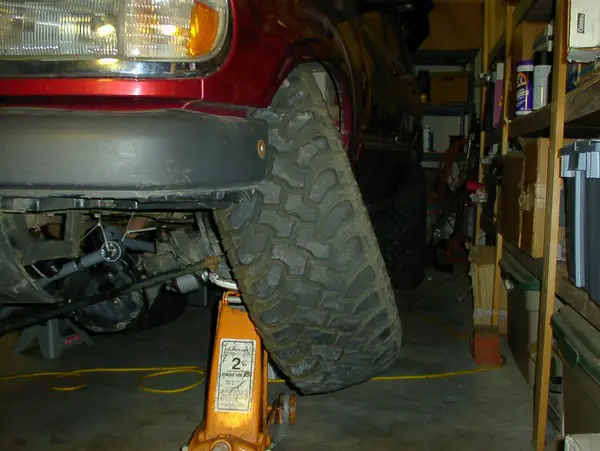

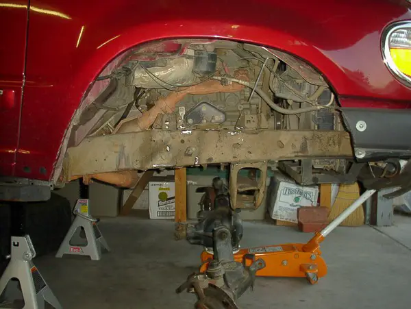

Day 3
Got a lot done tonight.
Finished hackin at the frame and got most of the grinding done.

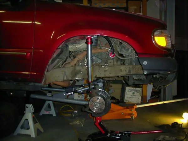

And mocked up everything I have so far:
Coil-over angle:

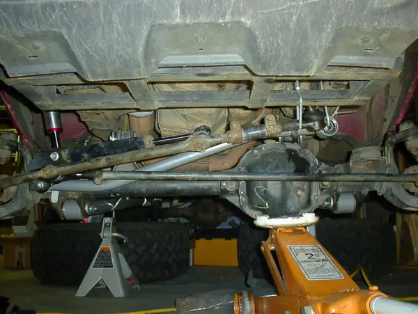

Steering angles:
Full Stuff (Thats probably 1.5" more up travel than I'll actually have. Can't turn stuffed that far up.)
Coil-over angle:
Steering angles:

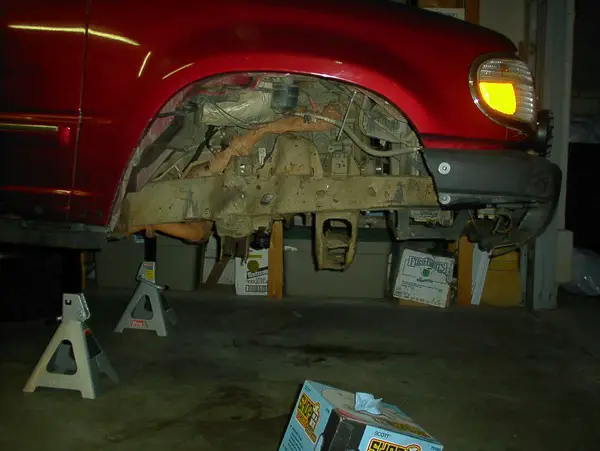

Days 4 and 5

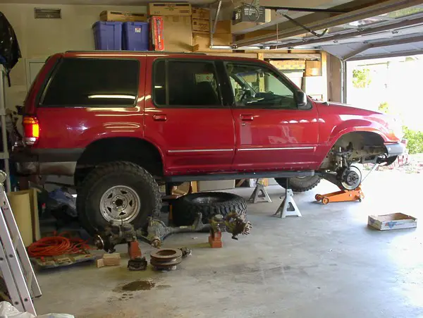

Got the steering box in and a temporary track bar bracket tacked on, and cycled the suspension through its paces. Looks like I'm gonna be at ~7.5" of lift in order to get a decent amout of uptravel (~5")
Back on her feet (ok, not really):
Ride height:

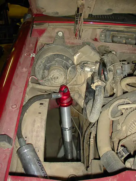

Lots of room for a coilover hoop:
Not so much room:
Ride height:
Not so much room:

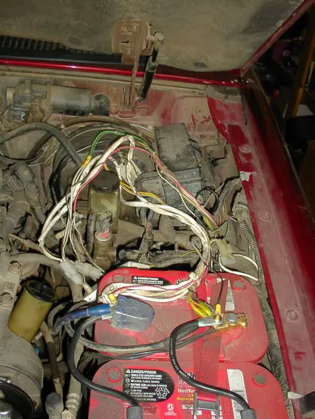

You should relocate the batteries to where the old spare tire used to be mounted up behind and above the rear axle. Those Optima batteries can be mounted sideways. Then you would have plenty of room for the coilover hoop.
