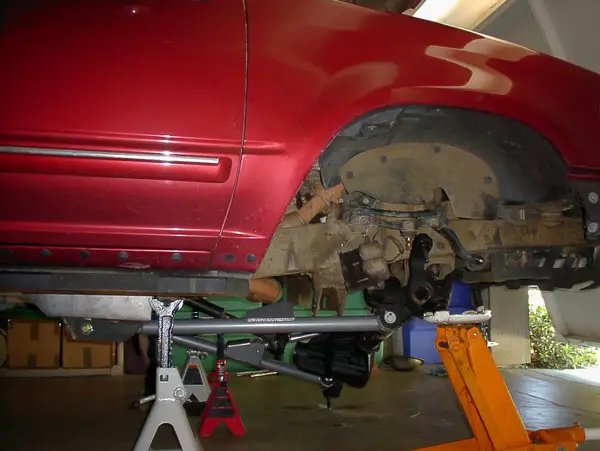

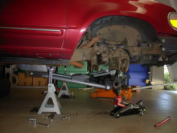

Final test fitting (axle is 3" lower than it will end up being [IFS bracketry is in way] ):
Flex from 14" of coilover travel:
Gonna need a longer driveshaft:
Now that I've seen everything I need to work on, the IFS goes back on.
Actuall deconstruction and construction will start sometime around August 9th.

Jefe is that the D44 from the rubicon in those pictures? I wasn't sure what you were doing with that, but are you going to use it on your swap?
That is the Rubicon D44 housing. However I am still not sure I'm going to use it. I'll be running a TJ D30 for a while after the swap (in 2wd), and then either lock and gear the Rubicon housing, or order a custom axle.
I'm not too fond of the Rubicon housing since it is still the D30 axle with the exception of the diff, so 35's would be pushing it. I've also heard that it doesn't take normal D44 gears, just like the TJ D30 doesn't take normal D30 gears, but I haven't confirmed that.
Plus figure that by the time i throw alloy axles, the 5x5.5 manual hub conversion, gears and a locker into it, it'll cost as much as a custom axle.
