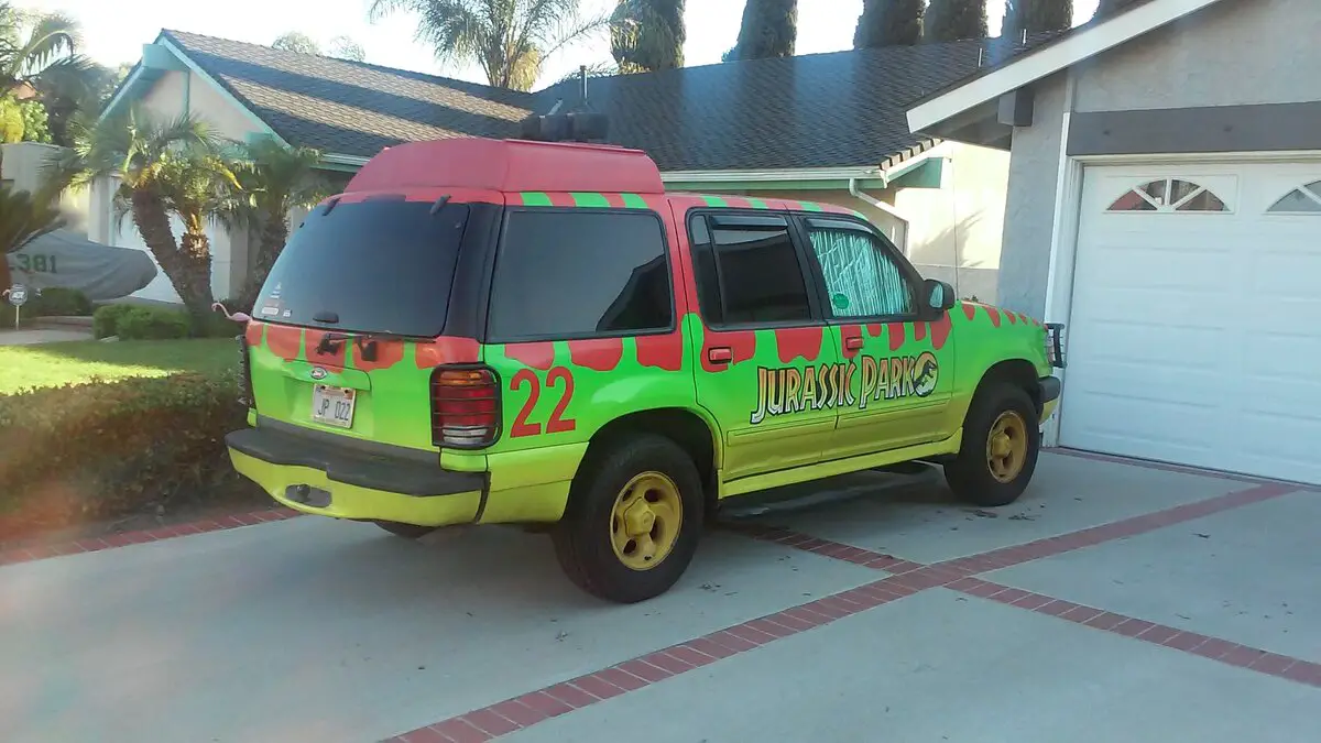

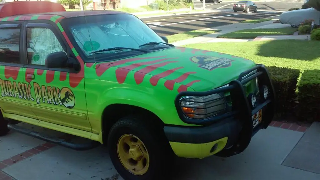

Alright so some of you know Ive been painting my truck the last week, and I was going to wait to show it off at T-haven...But I know you all can't wait and I'm to proud of my hard work:D
So here are some pictures I took with my cell phone.
Still have more to do, need to remount the front bumper, wetsand the whole truck and put on the JP logos when they get here..
The entire paint job was done using a $10 air sprayer from Harbor Freight and Rustoleum paint. The green I actually custom made, as no color was available like that.;)

YOU ARE NOT THE ONLY SECOND GEN JURASSIC EXPLORER ! ! ..... Guy about a half mile from me has one! ! Just saw this a few weeks ago...got pics... Also in So Cal -- Orange county... not nearly as nice as yours--stock ...but.....
You two should hook up and caravan down the freeway...you'd get all kinds of looks / followers thinking your on your way to a movie shoot !
