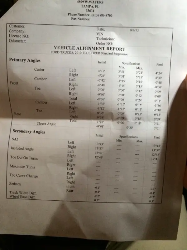

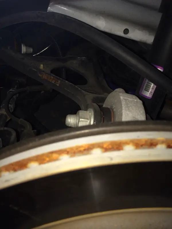

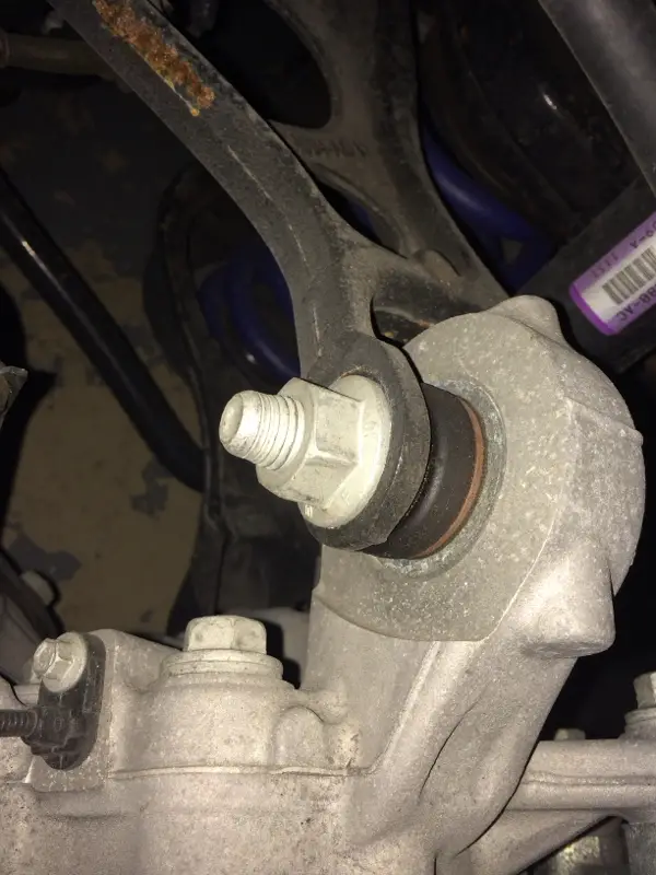

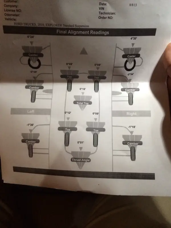

I lowered my '13 Limited several months ago using h&r flex springs and then adjusted the upper control arm bolts. Here are some pics of the bolt you have to loosen up to be able to pull it towards you. It won't move much( a couple of mm but it helps). I also attached a pic of my final numbers after alignment. Notice that the left is still out of specs .22 degree which is fine with me. Let me know if I can help with anything else.

the dealer did the alignment for me , for no extra charge , when they did the install . it's nice to have friends at the stealerships :D
I didn't do any camber kit .
