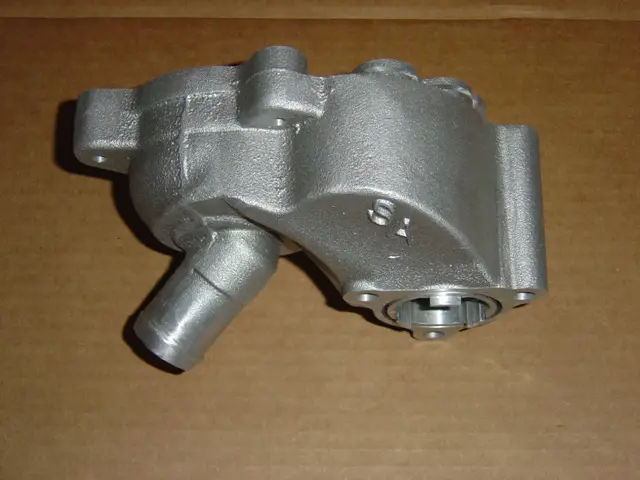

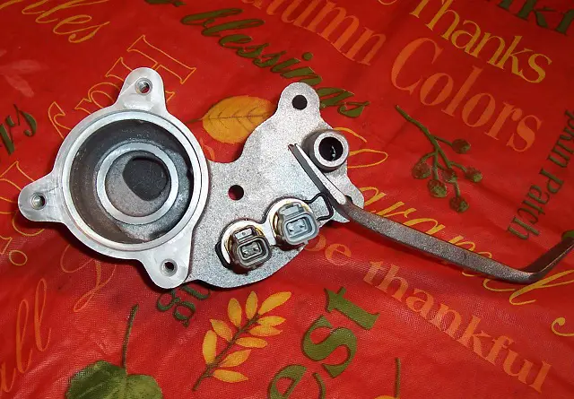

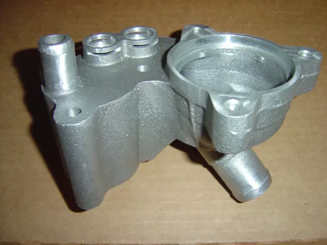

Mine showed up today already, fast shipping!
I wont be installing this yet, waiting for warmer weather.

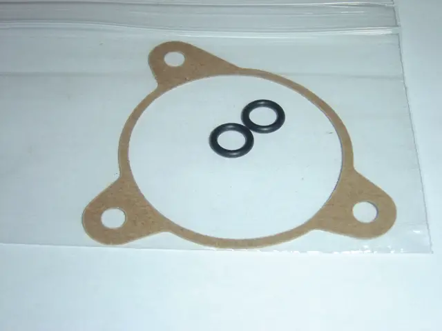

Here is a few pictures.
thanks for photos
I was wondering if I would need to puchase gaskets so your photos saved me some time and money. I assume the O rings are for reusing the sensors. I've decided to install mine as soon as I get the sensors. I think I replaced the lower hose 3 years ago when I had the engine out for timing chain repairs. I'll reuse the hose but replace the old standard style hose clamps with new Norma Torro hose clamps.

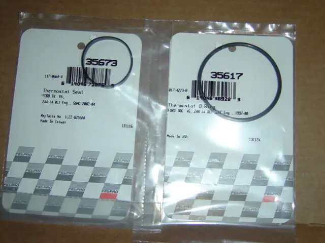

Gasket
The only thing that worries me is the last picture. What happens when you need a replacement for that gasket. The original plastic design didn't have that one so I figure it is custom made. Maybe we can get replacements to keep on hand or use sensor safe high temp sealer.

I have extra gaskets, but you can run the setup without the gasket. The gasket is a secondary seal. Primary seal is the o-ring on top of the thermostat. I am eventually going to have a web site with all of the parts available individually ,so they will be available.

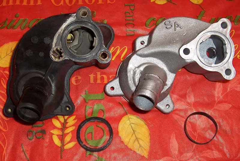

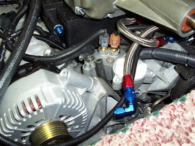

I finally received the sensors and retaining clips this morning and they looked like they would fit the metal housing so I pulled my stock plastic housing for comparison. I was pleased that I got it out without disconnecting any fuel hoses.
The first thing I noticed is how much closer together the sensor mounts are in the metal housing compared to the plastic housing. Note: make sure to oil the sensor O rings before installing them to prevent abrasive damage.
Also, the sensors sit taller in the housing which concerned me because one of my fuel hoses is above the sensors. In my stock unit the engine temperature sender (3F1Z-10884-AA) is on the passenger side and its connector wire crosses above the engine coolant temperature sensor (3L8Z-12A648-A). Since both sensors are in the same chamber I decided to swap them to eliminate the cross wiring. I also test fit the connectors for clearance and there is just enough when oriented with the connector tab receiver facing forward. (They are not correct in the above photo). One unique problem I have is that one of the housing retaining bolts is corroded to the bushing that prevents over tightening the plastic housing (specified torque is 8 ft-lbs). The bolt came out with the bushing so I'm soaking it over night in PB Blaster.
My other concern is the different method for sealing the base of the housing. The metal housing has a deep groove and a matching gasket while the stock housing has a considerably wider recess and a matching gasket.
The mating surface of the head is flat and I assume the thin edge of the gasket widens as it is compressed by the mounting bolts pulling the housing to the head. But I doubt there is a comparable amount of gasket area in contact for sealing. I checked the OEM equivalent part number (1L2Z-8255AA) for the supplied FelPro gasket and Tasca Ford's database shows it to be the correct part number for 2001 Ranger/Explorer Sport/Sport Trac thru 2010 Explorer/Sport Trac and 2011 Ranger. Just to be safe I plan to apply Red RTV to the inner and outer edge of the gasket.
Since I currently have carpal tunnel symptoms in both hands I was unable to push the clips in with my fingers so I used one of my favorite leverage tools: an old drum brake adjuster.
The sensor can still rotate with little difficulty when the clips are installed to achieve the correct orientation. (Sensor orientation shown correctly in above photo).
I would not recommend using rtv under the lower housing oring, the oring does widen during when the bolts are tightened. The plastic groove you are measuring against is on an old unit. My groove matches a new ford plastic housing. The clips to in tight and if you use a pair of pliers to squeeze them in works well. The metal housing does not distort and warp like the plastic one did. I tore several plastic housing apart that we're used and was amazed at how much of the plastic was distorted. Let me know if you have any problems with your installation, Im glad to assist. Great pics bye the way and thankyou for trying my product.

So far I am pleased with the metal lower housing and wish the metal upper piece had been available for purchase so I could install both at the same time. I also wish that I had purchased new mounting bolts from the dealer when I purchased the new sensors and retaining clips. I don't want to wait another week for new bolts so I'll cut the bushing off the old bolt if soaking in PB Blaster doesn't allow release.
A common source of coolant leak in the 2nd generation plastic housings was the sensor threaded bushing. When a sensor was unscrewed or tightened the bushing could spin and subsequently leak. That's why I epoxied the threaded bushings to the housing. Another leakage source was the housing splitting. I detected no distortion or splitting in my old housing. However, I torqued it according to specifications and to my knowledge the engine has never overheated and the pressure cap has maintained the corrrect pressure.
I wonder if leakage problems with the later design are partially due to the new method of sealing the base. Both mating surfaces (bottom of housing and top of head) are machined flat. I will thoroughly clean the head surface before installing the housing. However, I still intend to increase the gasket sealing area with a small bead of RTV. It may increase future removal difficulty but I'd prefer that over a leak.
Edit: This morning I found another reason for using RTV with the base sealing gasket. It is a fairly loose fit in the groove and might fall out when attempting to insert the lower spout into the hose from the water pump. I applied RTV to the groove prior to inserting the gasket to hold it in place.

Housing installed

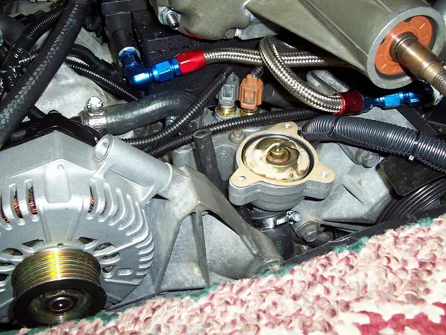

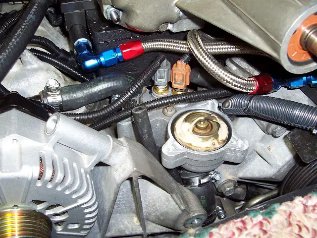

I received the new lower housing hold down bolts today (PN W702527S437) so I continued the replacement of my stock plastic housing with a metal one.
First I torqued the bolts to 96 lb-in (8 lb-ft).
Then I tightened the lower hose clamp, installed the heater hose with clamp, and connected the sensor connectors. I installed the thermostat and the O ring on top of it. I thought about replacing the made in China thermostat (92 deg C/198 deg F) but according to past datalogs it has worked very well to maintain a constant temperature under normal driving conditions.
The paper gasket came next.
I wire brushed the old bolts and added a drop of oil before installing the cover.
I am satisfied with the product and will purchase a replacement metal cover when one becomes available.
