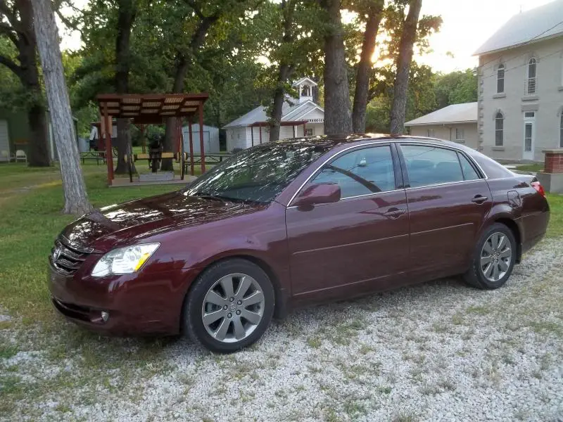

Oh yeah--the car
2006 Avalon ,Touring edition in Cassis Pearl --black leather interior. This was truly driven it's whole life by a little ol lady-my mom. :thanks::thanks::thanks:

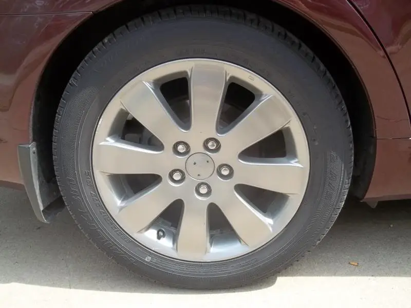

Threw on a set of Falken Azenis pt722 225 55r 17
No trimming, no rubbing. :D
The driver side rear tire had developed a "wop wop wop" on smooth roads, so it was time.
Close up of new rubbers
