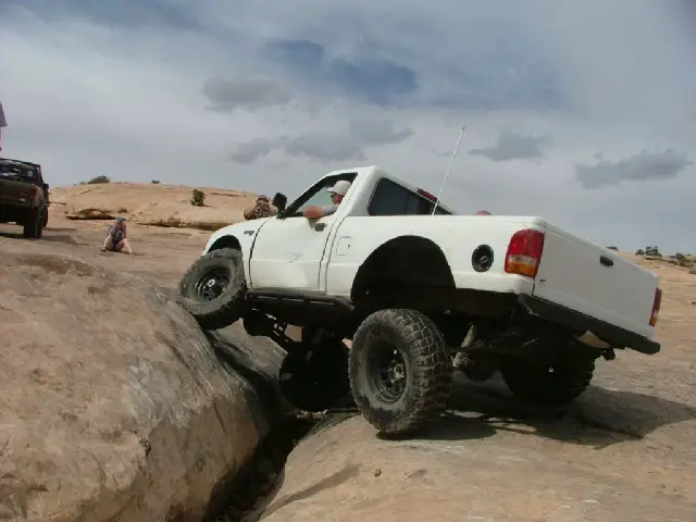

Mine as pictured above are 2x2 .25" wall tubing. However it didnt sick out far enough to protect the body. It just protected the rocker. Then I added a 1.5" tube to it to help protect the body. I hvae droped off 4 ft drops in moab strait on the slider and it is still perfect. I use the tubes to pivot off of and so far so good.
