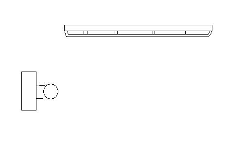

I had another development today:
I found some 2 x 4 metal that won't cost me anything, new, just slight surface rust. It looks like I will be using that just because its free. I am probably going to go a different route as far as design- I was thinking about standing the metal on edge, just outside of the pinch weld, and about 1/2" from the body. This will stick down enough that I can attach some skid plates for the gas tank and t case, but still won't be lower than the frame, so I won't be loosing any clearance. If I get them like I want them and am satisfied with the look, I will get some tubing bent for steps, then herculine the bars. Thoughts?

I would also have the long side of your 2x4 box run horizontal instead of verticle...i think it would look kinda weird like that and you'd loose abit of clearance. I have basically the same kind of sliders you have drawn except for the tube extension. When I take my truck to bbp fab for a cage i'll have him run some extension like froder has :)

I just noticed your design with standing the 2x4 material on end. Not sure I would do that, just because that's losing a lot of the clearance you just gave yourself by taking off the steps. You could do the same design, but with them laying flat.
I'm pretty sure that RangerX, Jefe and Paul B. all have 2x6 material alone laying flat.
