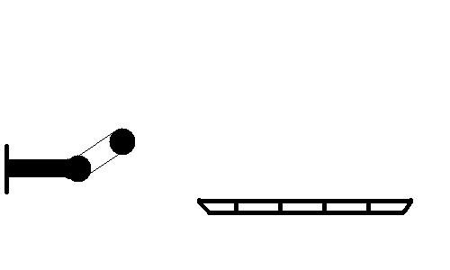

I was thinking of a double tube style slider with the outer tube kicked up some, plenty of bracing between the tubes. I do not have a tubing bender, so any angles would have to be cut and welded. I made some crappy drawings in paint- comments or improvements welcome.
I still haven't bought any materials yet, so I am open to suggestions, just keep a newer, rounded look.

I really like the look of your sliders, but I have no bender to make those purdy bends. I guess I could get a square base and cut and weld the angles, but they look so much better when bent.
