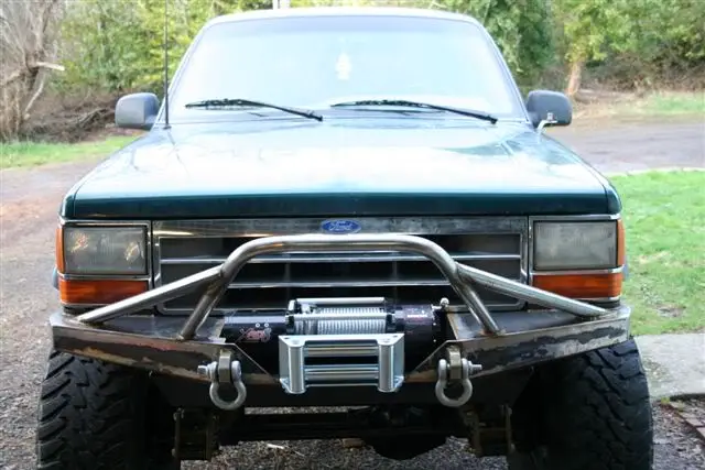

Your bumper turned out very nice. I centered my bumper to the winch and not the spool like you did, I had to notch for the motor also... now I dont feel so bad. Just an idea that worked for me, but you can mount the relay box behind the gril on the paseange side like I did. That way the relays are up a little higher and not out in the weather as much, you cant even see the box on mine.

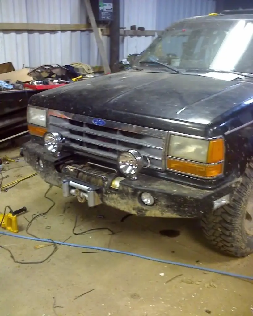

Got the bumper done tonight less paint. Painting will start tomorrow. Ended up going with option #3 and it turned out GREAT! Mounted up some 8" HID's from the sandrail on the jig table at the shop......looked so badass, too bad I can't keep them! Pics tomorrow.
Beautiful job RustENutz, it's flawless. Looks like the clevis mounts are from 1", no weak spot there you would pull the Explorer in half before ripping one of those off. Nice clean welds too. Just one suggestion, you should tack the bolts to the winch and tack the bumper to the cross member. Not for strength, my friend had his winch stolen off his Jeep in his front yard, with only 4 bolts holding the winch it only takes a couple minutes for someone to pull your winch off. Again great job, I haven't seen a better looking bumper yet.:salute:
That is one of the nicest custom bumpers I have seen on this sight. I wanted a plate bumper with a hoop but everything I have looked at was to bulky... now I have found one to copy...I can fab, just got no creativity...3 cheers for forums.
Bumper looks great! I also mounted my solenoid just behind the grill on the passenger side. You can even plug in through the grill. If you look close in the picture you can just see the solenoid peeking out behind the grill:
I mounted my solenoid pack behind the grill too. Had to do some serious soldering to extend the lines a bit to make it work, but it looks much cleaner and is much better protected. (If you look carefully you might be able to see it on the pass. side. (You can definitely see where I notched the grill to clear it on the back) I leave mine plugged in all the time, and the the controller sits coiled up in that little space between the battery and headlight. Pop the hood and there it is.

I didnt have to notch anything, I just drilled two holes and cut the ears off the bact that were profiled to the winch motor. I wired mine in with SO cable to a rocker switch on the dash becaues I was tired of dealing with the plug on the front, I have a sealed switch just inside my gril to run the winch in or out to spool the cable back up if I need to by myself. Oh, and the stock cables are long enough to run behind the gril so dont worrie about that.

All done! Winch works, going wheeling tomorrow! I'll try to remember the GoPro video camera and get some pictures.
