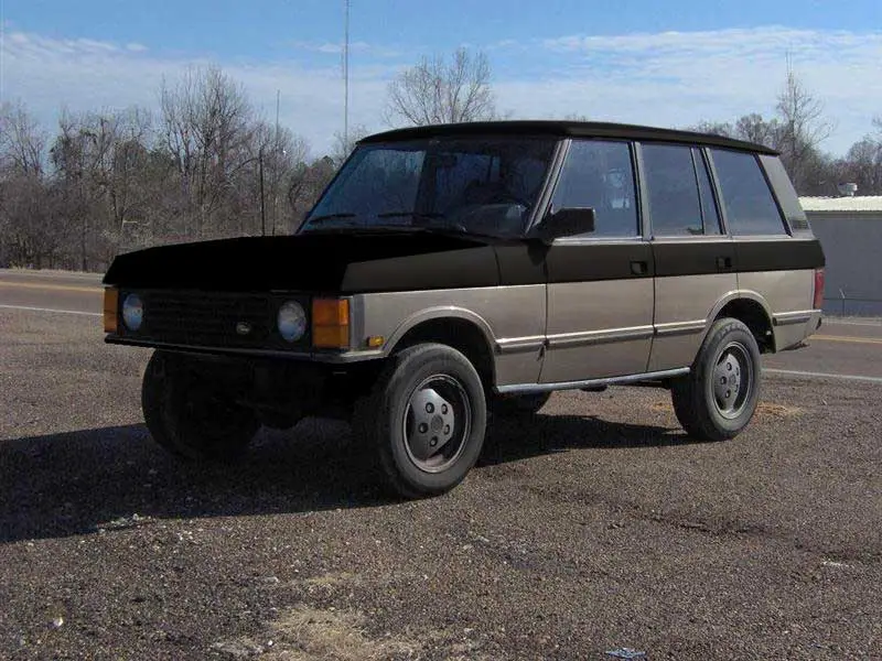

I got the hood smoothed out completely today. I am considering spraying the entire top surface of the hood with bedliner instead of just the center section. There is a little of oxidation on the hood, so this would cover it up. The sides of the hood look fine, so I would leave them alone. I made this picture on Paint--the hood os blacked out and I trimmed the front fenders a little.
how does it look with the blacked out hood?

I don't like it with just the hood black. Especially being that color. Paint the whole top black and it would at least look decent.
