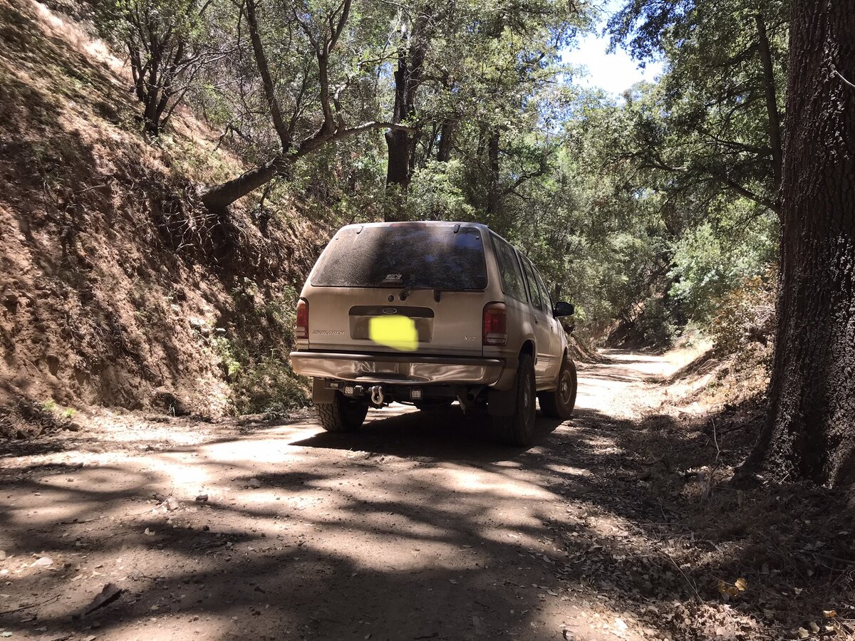

The rear hitch probably won’t effect your departure enough to not want it. If you need recovered and really need to pull, I’d match rather pull from the center of a hitch than on a frame mounted hook.

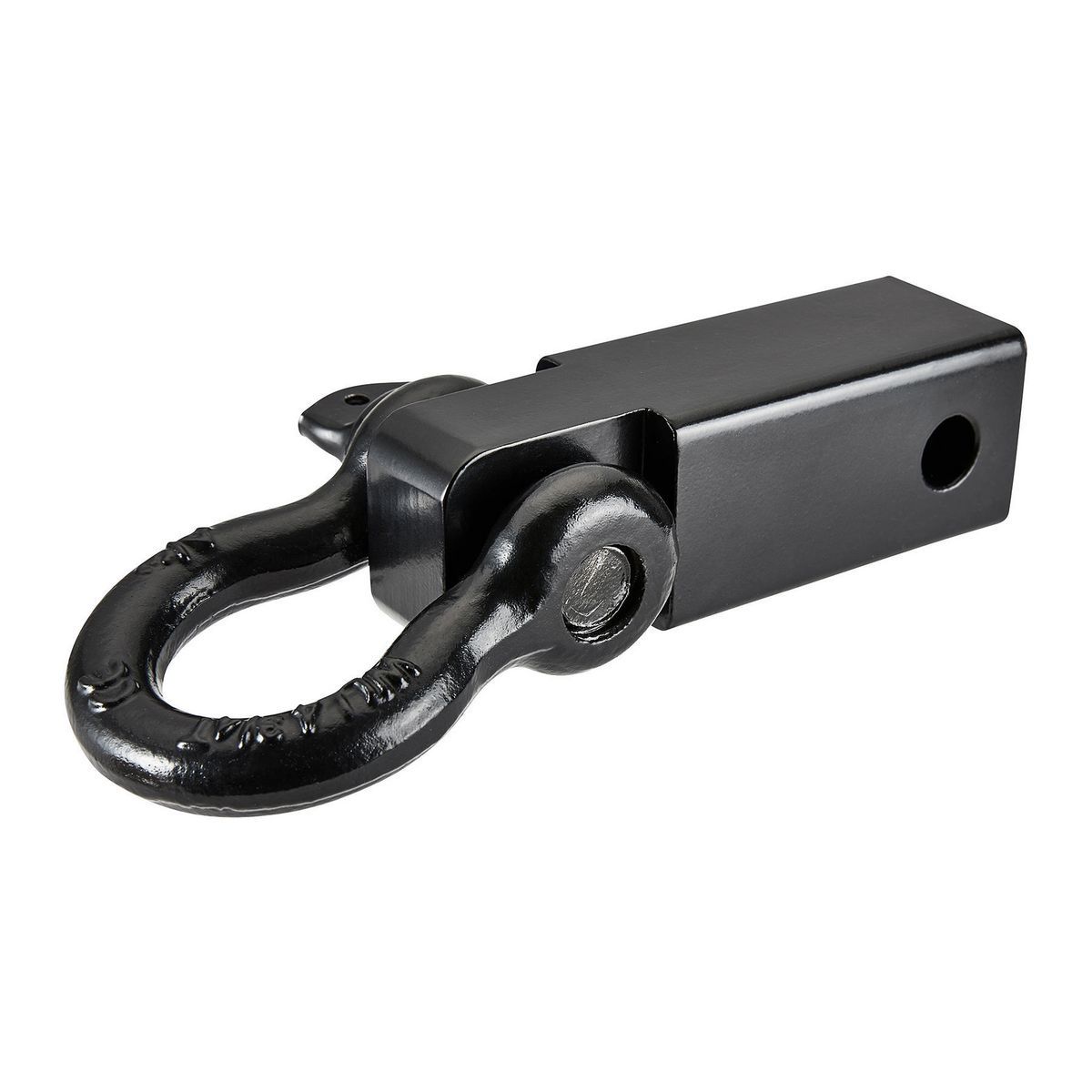

I think he either meant welded on to it, or connected into the reciever, kind of like these. I almost did did welded ones on mine, but I got a four way hitch that had 3 sizes and a tow hook instead. Either of these would work as a rear tow point, my hitch is now on the Rado, but you get the gist, can see the hook. But that way ya don't have to remove the bumper, plus as said, the hitch can help protect the bumper. Even with an aftermarket bumper, the hitch still kind of works like a skid plate, so it's nice to have sometimes

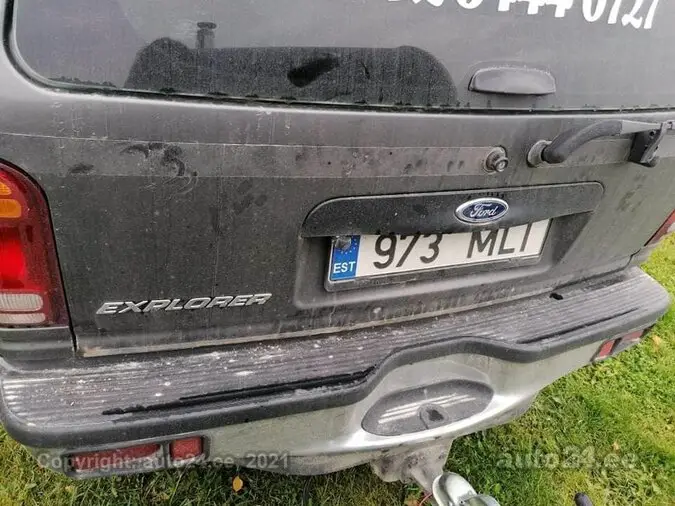

On a european Explorer the tow hitch is different. There's a close to 10cm/4in vertical metal plate under the hitch bar.

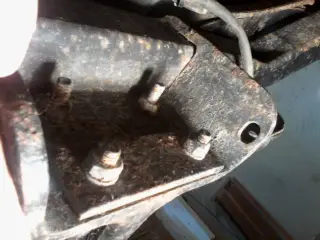

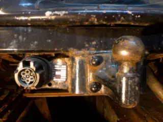

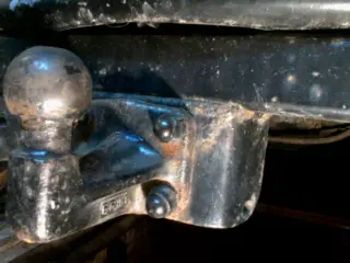

Took a couple of pictures of my cars hitch. The main construction is the same as the US one but where the rectangular connector tube should be there's this 4in high plate metal tow ball holder underneath the hitch frame.
