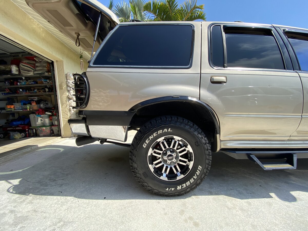

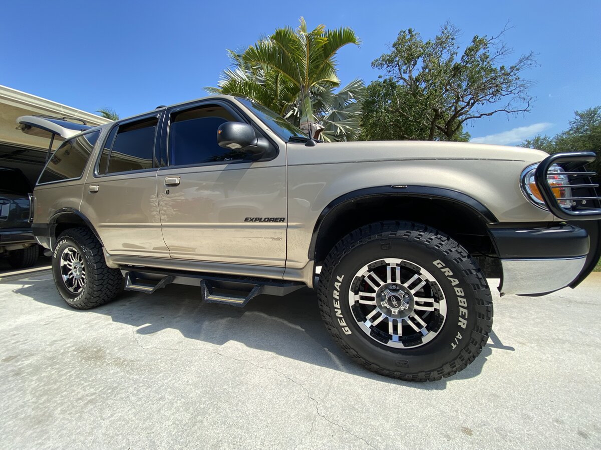

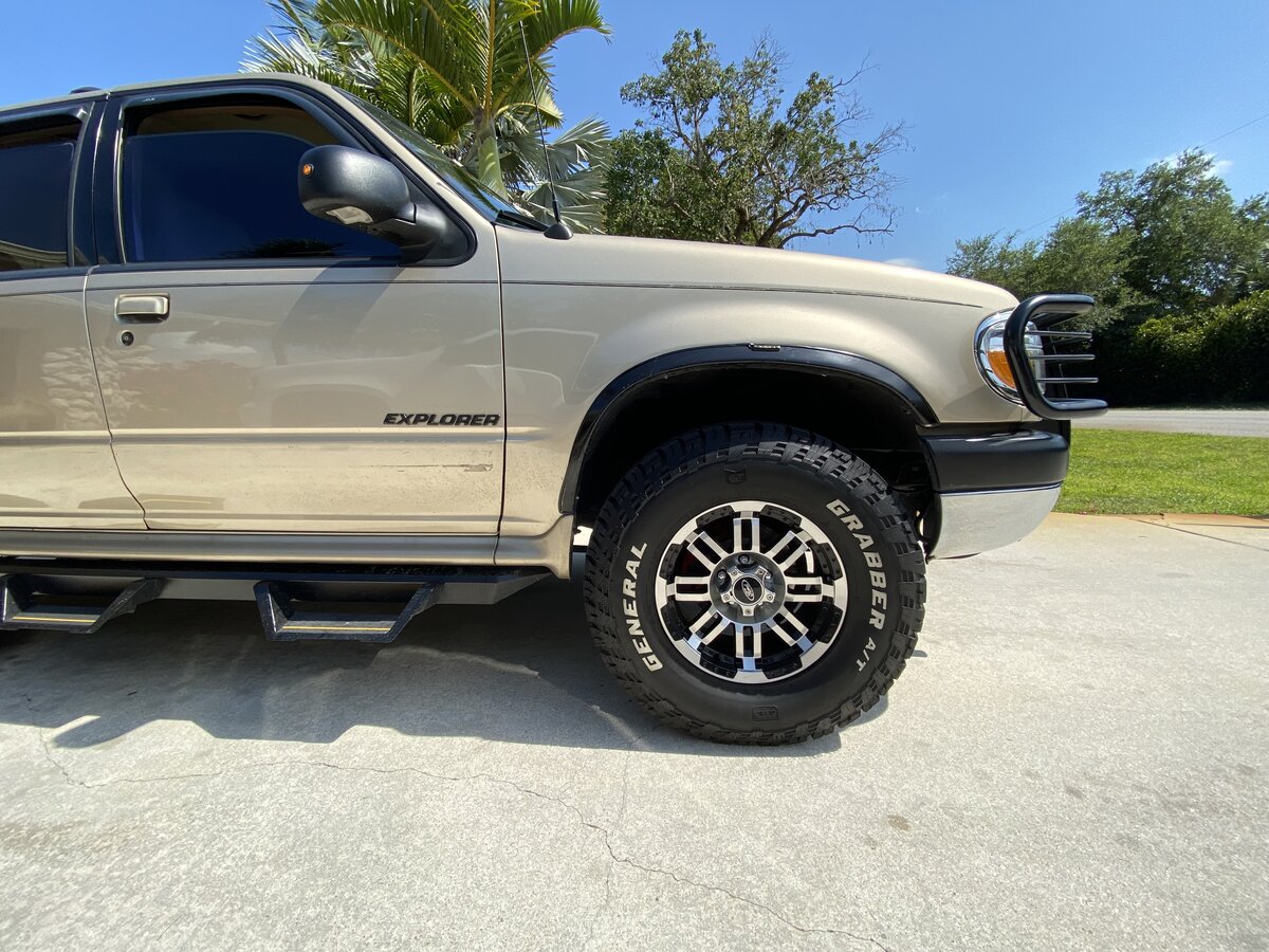

This is my 2000 on 32’s. It has lift keys and lift shackles. It’s going to be about 1” higher soon as I’m throwing on some old man emu springs and lift spindles. The torsion twist is nice but I want a softer ride.
Wow that’s awesome! That looks very high with only shackles and the keys looks brilliant!
How hard are the keys to change?
imo keys do the same as the twist- increase preload on the bars.iirc he has a 2wd so he can use lift spindles, and with 2wd no cvs to bind so tt can be up to 3" if you can handle the ride
that being said, keys aint hard you need the unloader tool iirc

I paid a shop to put the lift keys on about 3 years ago. They told me the hardest part was getting the tension off the torsion bars and the original keys were stuck on the torsion bars pretty well. I think tightening the stock bolts will give you the same effect as lift keys and you can avoid the extra work.
Well, as long as you have the torsion bar remover tool, it's mostly pretty simple. We had to unload the tbars to throw on a 6" lift kit for my moms silverado, really wasn't bad when we got the tool to relieve the tension. Just take note of the amount bolt turns so you can put it back how it was before. The tool is like $40-60, it's not terrible and its worth using, tries adding lift keys to mine before we had the tool, was told they didn't fit, they looked identical to mine, but I just said screw it and maxed out my oem keys. Worked for getting my 32s on
youre 2wd right?

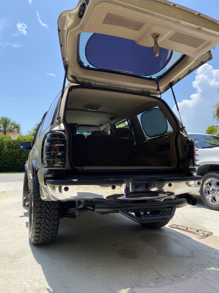

Now I would like some extra advice on rear toe hooks that would essentially bolt onto the brackets that the toe bar will be removed from? If anyone can help that would be awesome again I am from the UK. I’m going to try the rear air shockers off road since I’ve managed to fix a leak on the pipes that was causing it to loose pressure over a few days.

imo since ya have a tow bar which i asume is a hitch i would just put a D ring shackle in its place plenty of attatchments availabke on sites like amazon, imo not even worth the while to remove it to put tow hooks where the hitch bolts to. and anyways the hitch protects the bumper imo. (for those of ya in pst, yep... im at at 1 ;) )
Do you have any photos bud? My idea was the toe bar actually sits low down, so ideally I wanted that removed the rear bumper is scabby on the chrome and I’ll eventually have a proper off road rear bumper put on in the future :)
And would you just put the d ring where the bolts would go for the tow bar?
