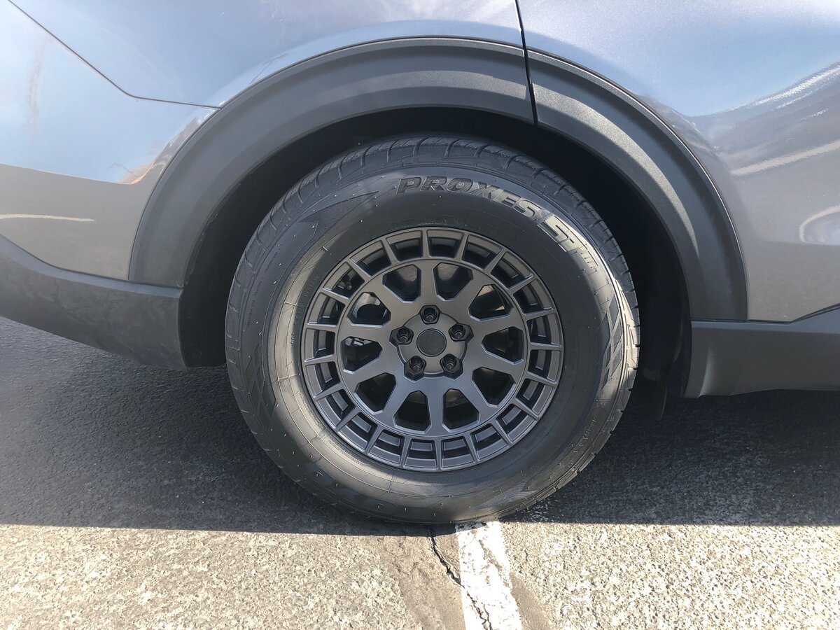

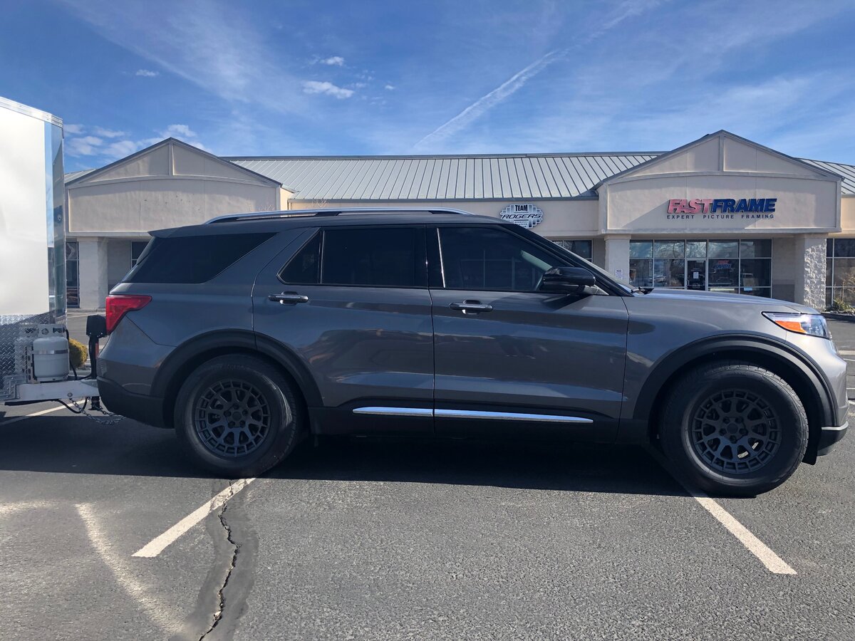

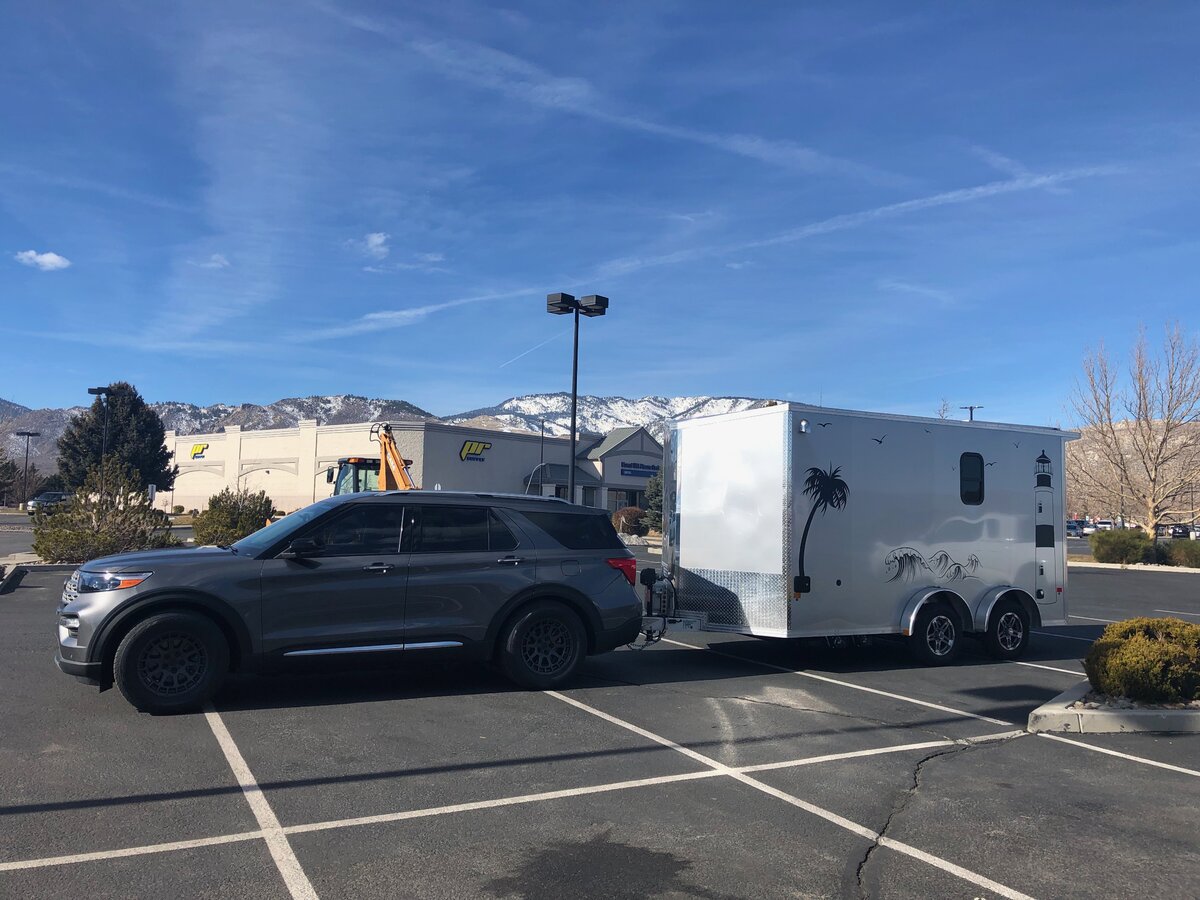

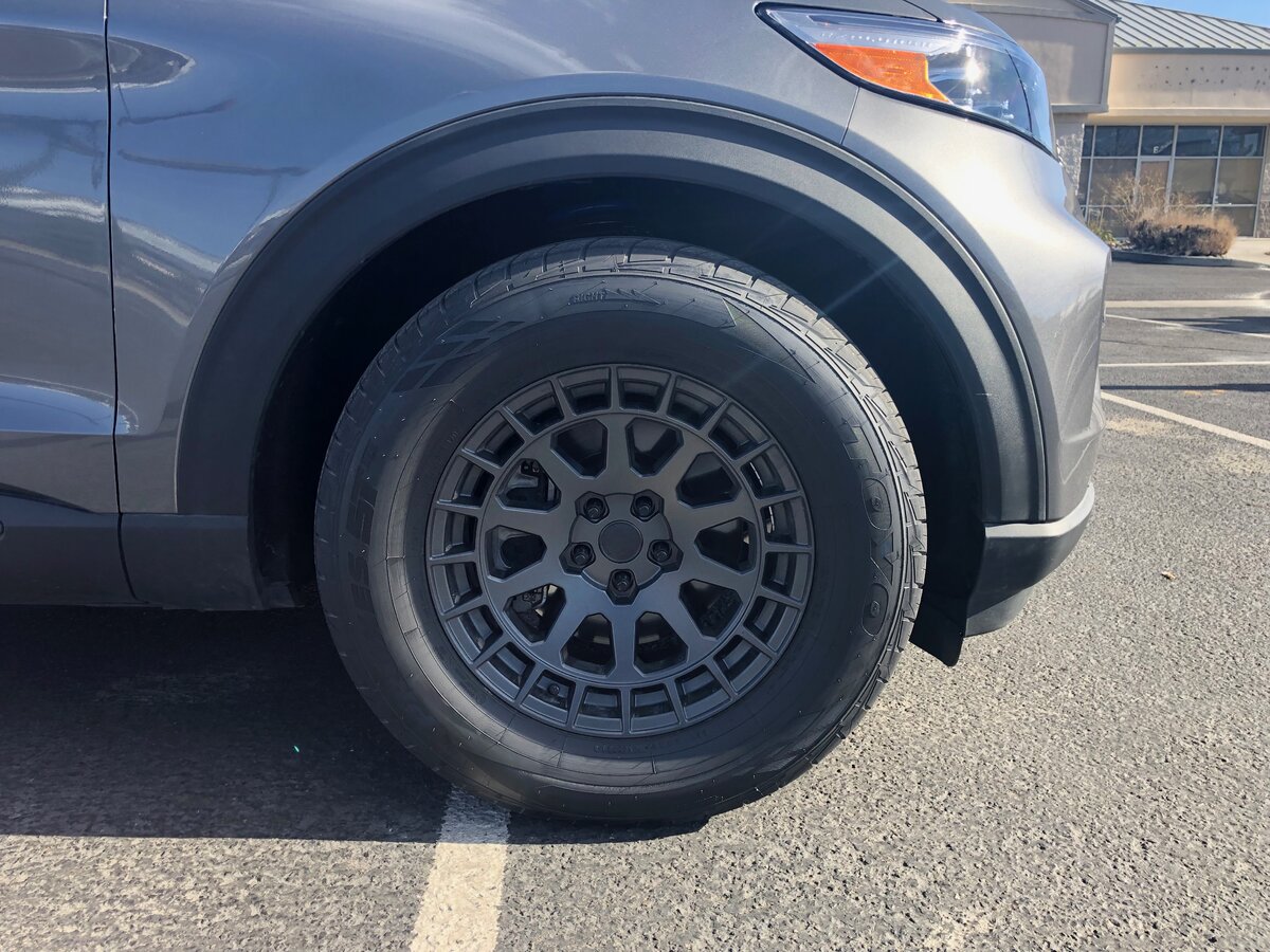

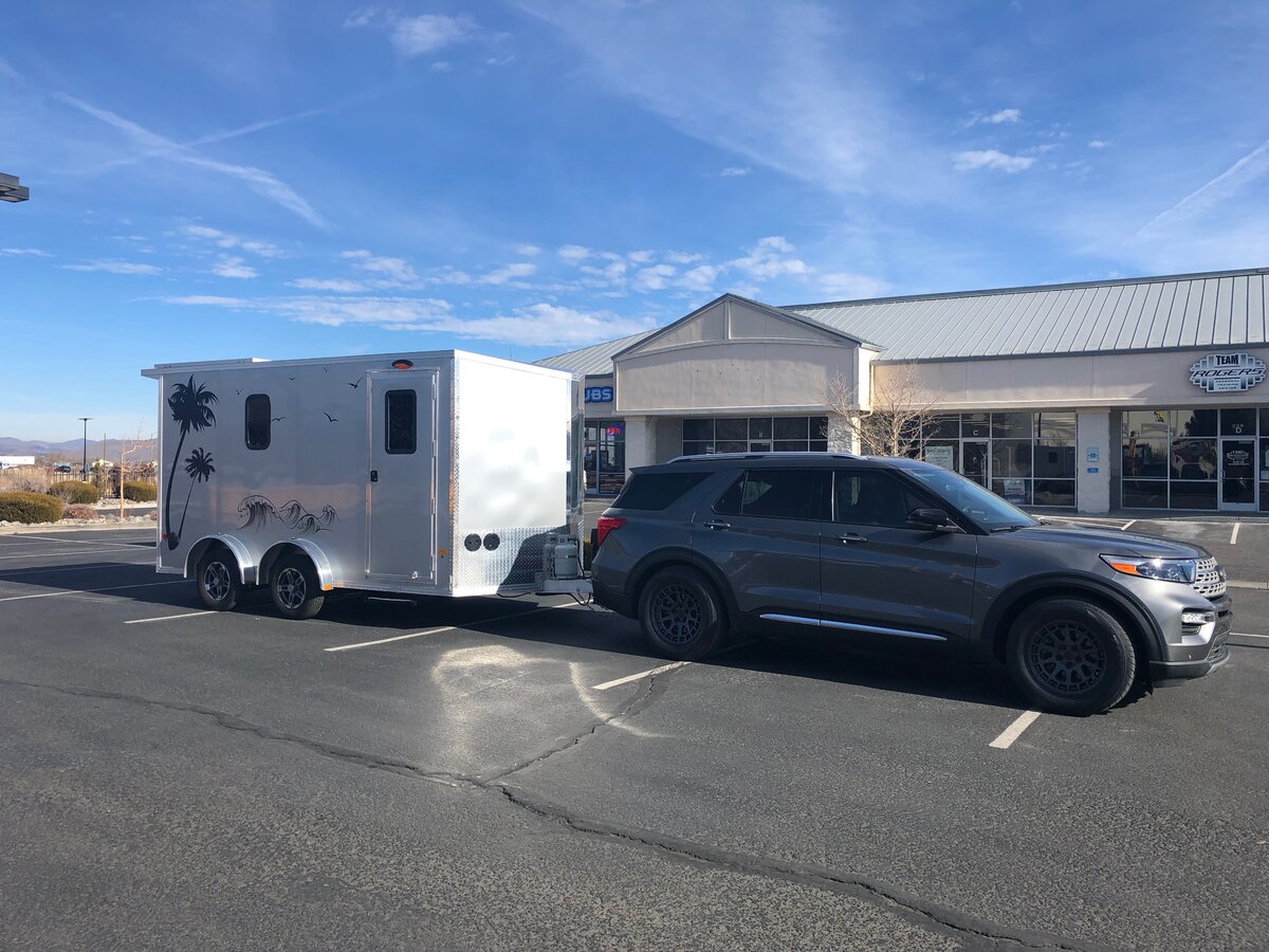

Quick update. I removed the Traxda lift and installed Steeda lowering springs, struts, shocks and rear sway bar. The 285/60/18 Toyo Proxes ST III on 18x8.5 Black Rhino Boxers with +12mm offset have no rubbing whatsoever, even at full lock and suspension compression. Tire/wheel combo also saved 3lbs per corner at 69 vs. 72 for the stock 20's. There is a 1/4" poke at the front and rears are flush.
Handling is drastically improved. Truck turn in is much crisper and chassis rotation at the rear feels great. It actually feels like my 2015 Mustang EB on 21" wheels and stock suspension. Ran it through 8 miles of mountain twisties (in Mexico) taking most corners at 80-90 mph. Didn't want to push harder as it was only 40F out and the 18" tires were also a little squishy loaded at these speeds. At normal speeds, the ride is very composed and just slightly stiffer. Strut/shock rebound is much better with no bounciness on dips. Brake dive is also much improved. Front lift on acceleration is reduced as well.
Also towed my 7.5x7x14ft 4000lb cargo trailer and the stiffer rear suspension helped considerably. Very stable, especially through turns and being passed. Power in the mountains was a non-issue, accelerating easily and maintaining any speed I wanted.
Overall, quite happy to have gone the lowered rather than lifted direction for my new goals with this Explorer. I feel like I can get much more enjoyment with this setup than I thought I could get lifted and going off road.

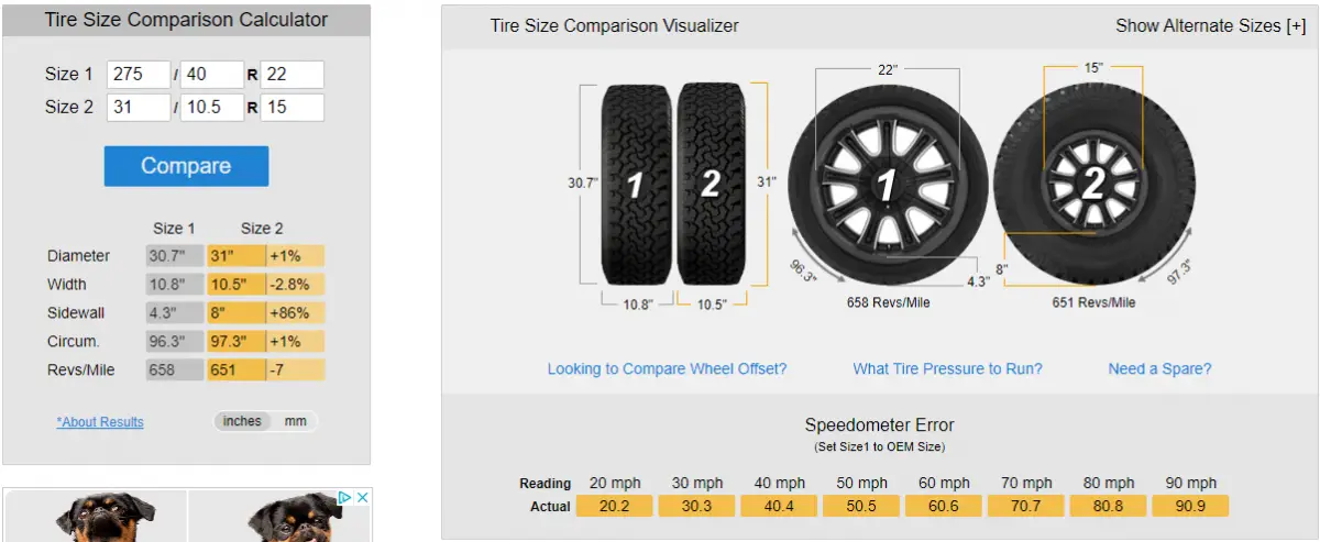

Here's the deal I'm seeing on FB Marketplace:
Any wisdom and criticisms welcome and appreciated. One question I hope to have answered, will these be ok on HWY? More questions to come...

Nice comparison, but I am not sure you can fit a 15" wheel over the brakes. Something to check, otherwise you can certainly got to an 18" wheel as it is standard on others like the Timberline.

I believe an 18" wheel is the minimum size that you could use on a 6th gen.
