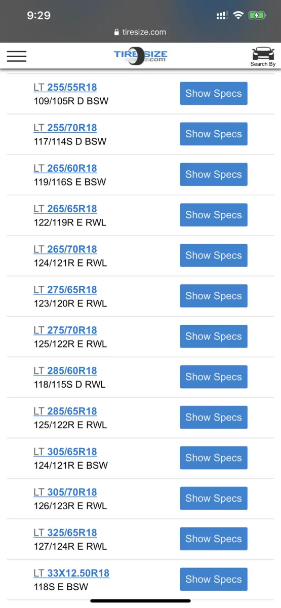

Does anyone know what size(s) will fit?
E rates BFG ko2 size chart attached

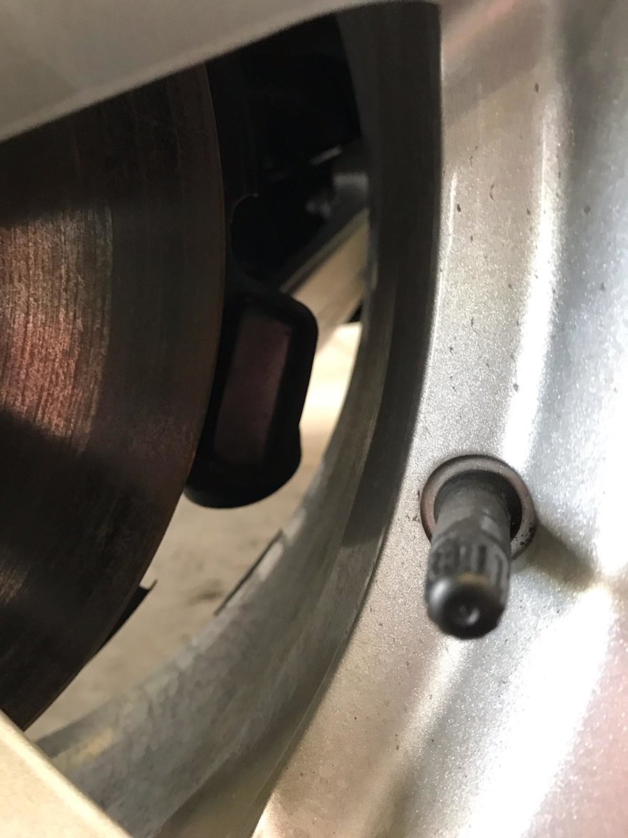

I had the dealer take a wheel off an 18” 2020 xlt and put in on the ST.. no Bueno.. way too tight... so I have to find out if the platinum has the same brakes and rotors as the xlt.. maybe that will work...
If I can’t have 18” wheels, so I can have 10 ply tires.. it is a deal killer

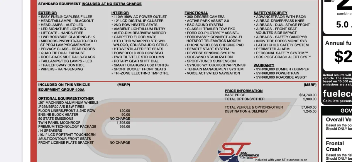

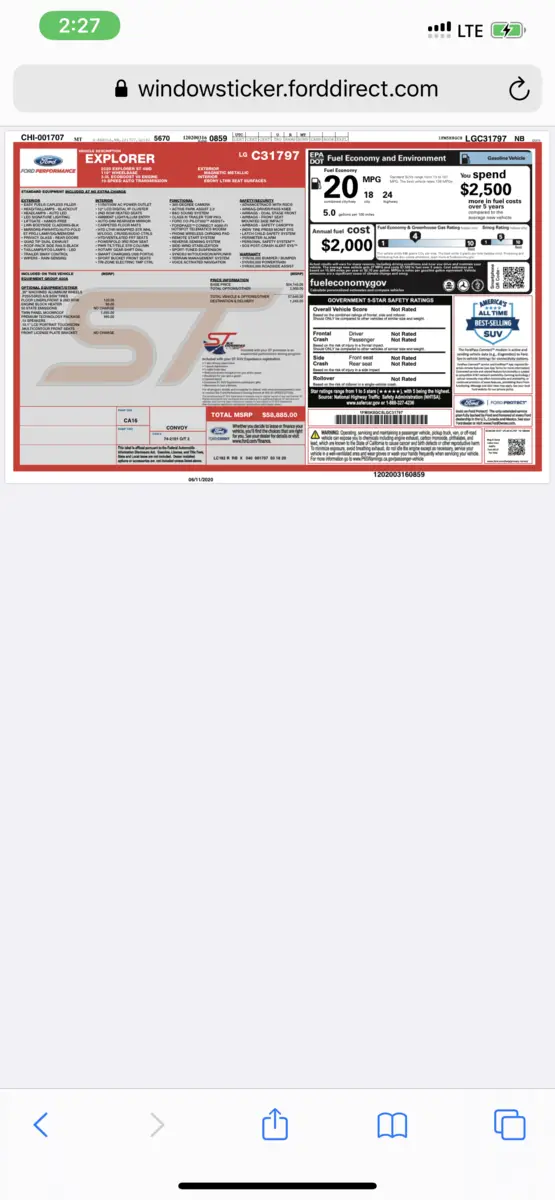

Did the ST have the regular package or the Street Package? The Street Package has different brakes as does the Track Package.
Peter
Peter
it looks to me like the regular since nothing else is specified
The Street Pack calipers are red.
Thank you David. The Platinum and Limited have the same sized OEM tire and more than likely the same HD brakes that the ST had that you tried to fit the 18" wheel on.
Peter

A member bought and installed the Police Interceptor 18" wheels on his ST without any issue. He used them to mount his Winter tires. Winter Rims / Wheels
Peter
