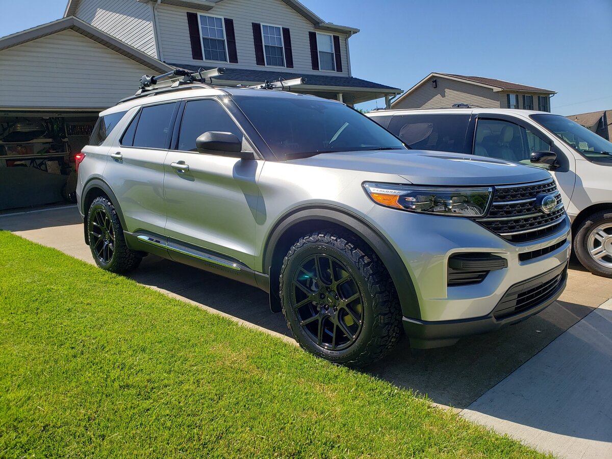

I agree the 275/55r20 work well. I have BFG All-Terrain T/A KO2 on my XLT also. Tight fit, but no issues. I have mine mounted on Voxx Lago 20 x 9.5" +35mm offset. In retrospect, +30mm offset would give a little more clearance between the tire and the strut.

The BFG K02 look fantastic! I have a new 2020 ST with the track pack and am wondering if these will fit my spec with the different brakes? Does anyone know the answer to this? Everyone around me goes for the street look and I wanted to change it up and do the AT tires in 20" so looks like XLT have success with 275/55/20. @SES9 do you have any other angles? I'm trying to be as flush to the fender as possible or maybe extended out very slightly which looks like what you have from that pic. Any advice? Also curious what you think about ride comfort and ride noise compared to stock? I do a fair amount of highway driving and have no experience with AT tires and am hoping they aren't very loud. Thanks!

Few more pictures attached. They are not completely flush, but are much closer to flush than my stock setup. The front is closer to flush than the rear. As far as noise goes, they are definitely louder than stock but that would be personal preference of what is acceptable to you. I cannot comment on any changes to how it handles or ride comfort as they were installed with only 100 miles on the vehicle.
