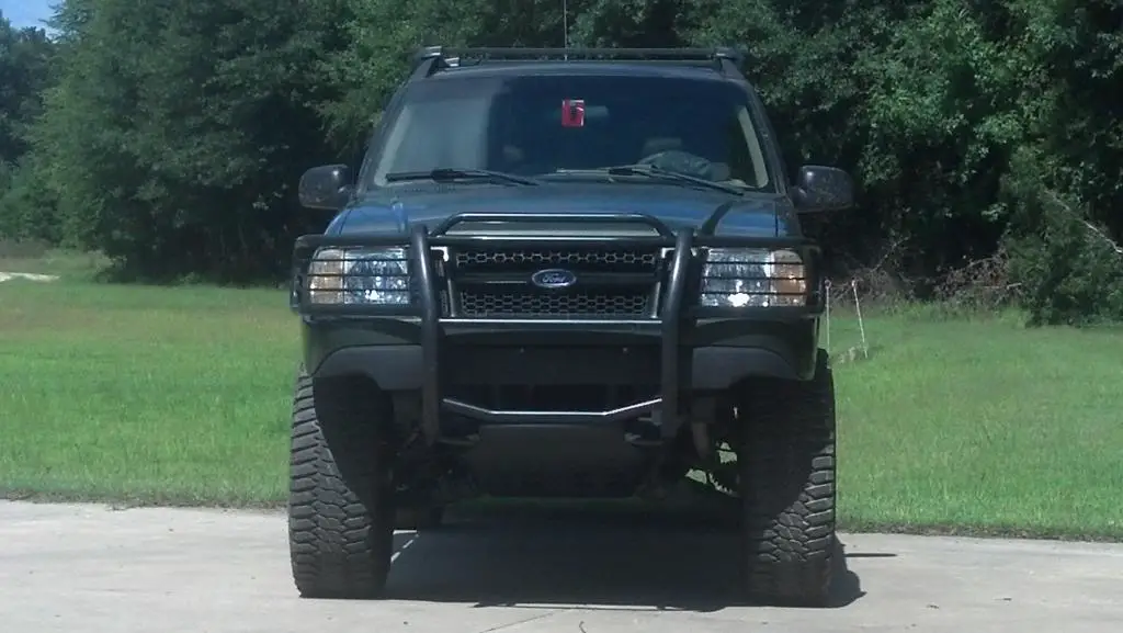

The first modification I made was to add Warrior shackles.
Second thing I did was remove the running boards. No pictures.
Then, I found a body lift from a girl on Craigslist. I went to meet her and she had a huge 2wd ST lifted and on 35s. She thought the body lift was going to make it sit too high. I took that problem off her hands for $80. A few months after it sitting in the garage, I got up the nerve to tackle it one weekend.
Obviously, these tires just weren't going to cut it anymore. Not only were the stock tires just terrible tires, they were too small.
So, after driving around embarrassed for a week, I got new tires. Cavalier Sport King 265/75R16.
I was unhappy with the rollerskate look from the rear because of how far inset the rear wheels were in the wheel well. Also, I was still getting some rubbing on the sway bar, even after getting the 265s to avoid rubbing issues. Solution: 1.5" wheel spacers.
Then, I added a Westin Sportsman brushguard. Got it on eBay, brand new as a shelf model for a shop. It was missing the mounting brackets which didn't matter because I was going to have to fabricate my own for the body lift. $140.
I also took that moment to paint all the cladding as well, since I was going to be cutting into the plastic on the front to get the brush guard and tow hooks on (which I had to lose because of the body lift). I also took the time to twist the torsion bars 1.75" to level the front out.
I was happy with that for a while but had some PIAA 520 driving lights sitting in the attic just waiting for a home. So, a couple weeks ago put me here.

Couple of recent updates that haven't made it to the registry yet. I cut the bumper for better clearance and ability to place the tires a bit better. Also added an RCI front skid plate and a Riddler rear differential cover.

Oh yeah, I also put the basket back on top with the spare since I need the bed back now that hunting season has started back. I wasn't so sure I liked the basket up there before but now I'm wondering why I ever removed it. I think I'm going to remove the step bars again tomorrow and maybe I'll get motivated to start on the sliders.
I also removed all the side tupperware and plastidipped the area to cover the holes. I'll update with more on that later.

More pictures before I head back to the stand.
Here's the tupperware removed and plastidipped over the holes. Not my permanent solution but it'll do for now. I know it's hard to tell beneath all the dirt but the point is that it isn't obvious. My idea for the holes on the rocker is either the body panel push rivets or zinc colored bolts.
As she sits now.
