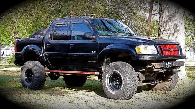

I got a helluva deal on a used 4" Superlift. Here's my truck with it installed...
Just like that? One day no SuperLift, next day with SuperLift?

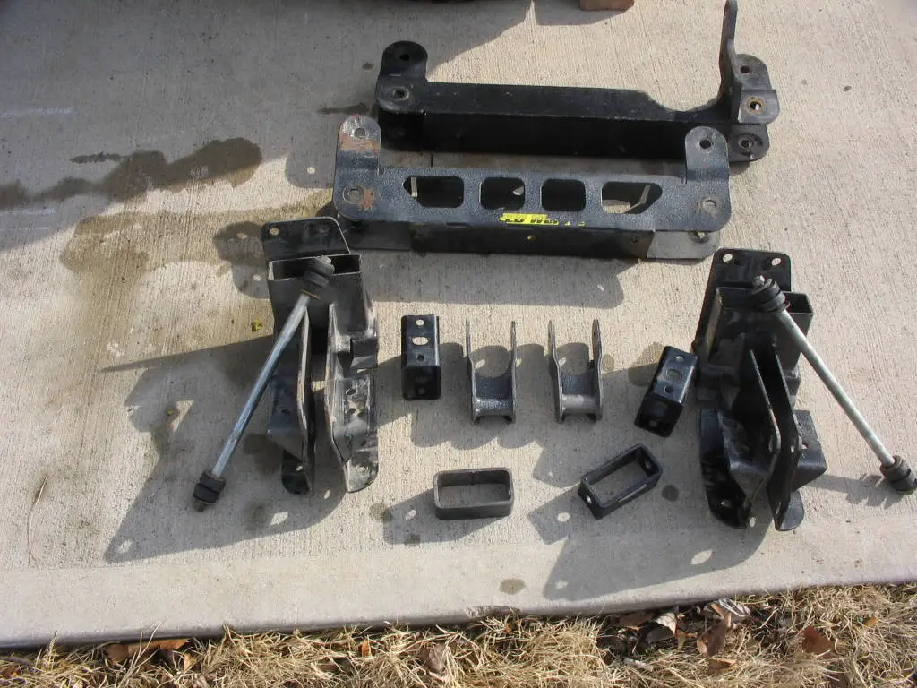

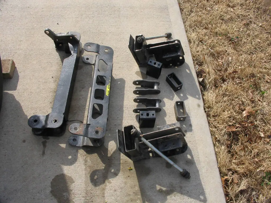

I might mention this
the Trailmaster rear drop bracket for the control arms, is also the diff bracket. It does not use the factory bracket hole
wanna see?
look at the far left bracket
I think the trailmaster kit brackets are a bit better--see how they are one peice?
nice.. now you need new tires and more pics lol :)
A couple of months ago I got 2 new ones on the front. I bought the BFG Mud Terrain KM2's.

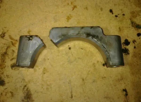

I opened up my front differential yesterday and found this...
I have no idea how long it has been broken. Luckily I have a spare front axle and can replace it from there.
