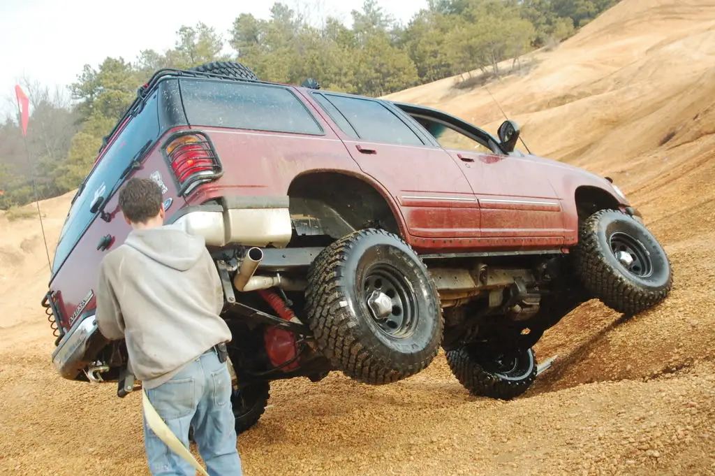

Jeez Jason, you could have seen the taillight guards just fine from the ground- no need to flex it up like that just to see the guards better.... :D
Still agree- a definite Gen 2 favorite for me too. Love the mods- functional and tastefully done.
Paraphoe
Go big or go home
July 26, 2004
5,006
9
Willow Grove, PA
'97 XLT
Thanks Joe! And that flex wasn't in my plans. :D

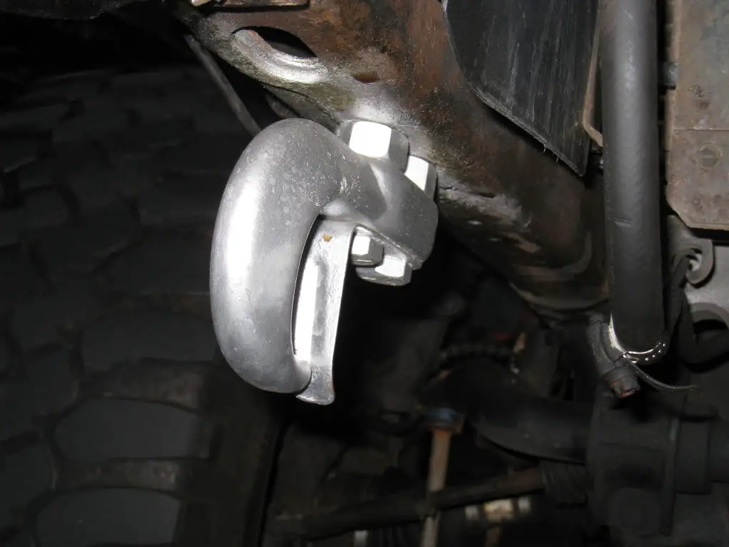

Love that truck-can you post some pics of your front tow hooks? Looks like you have a plate sandwhiched in between the frame and the hooks? Spending way too much time trying to get them installed. Only have 2" BL so body is slightly lower than yours.

As promised:
Should have done some sort of support plate, but I didn't it was a big enough challenge getting the nuts on inside of the damn frame rain from the two holes in the front. :rolleyes:

Much Appreciated!! Should I even ask how you were able to get bolts in the right spots in the frame? I have tried a few times and the frustration forces me to open golden ale every time. Then a few hours pass and I think, do I really need tow hooks....
I drilled the frame out from the bottom, and then, if I remember correctly, getting the nuts on the top and secure involved taping the nuts to the socket and sliding them into place from the two small holes in the front of the frame rail. It was a weird and annoying process.
