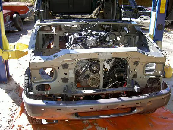

My project is to improve the whole drivetrain, so I need the whole 99 chassis. The body work is the easiest way to make everything bolt on. There won't be any fabrication required for any of the front engine bay parts, including AC. By using the 99 wiring, there will be no wiring issues.
To change just the front body parts, the upper section of the 95-01 under hood clip is needed. I was going to use my 93 frontend. That would have been the same thing. The top half of the radiator support would be needed, from the bottom of the headlight buckets up, plus the top edge of the side fender mounting supports.

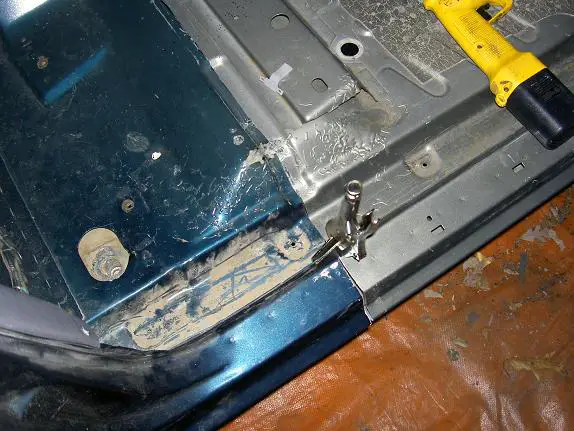

I had to stop last weekend. Rain, cold weather, and heavy mail has kept me away from it. Hopefully today I'll get to mount the doors and fenders, to check the fit. With the alignment confirmed, and weld prep done, then I need to get a welder to it.

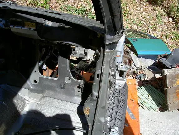

Here is a picture of the match of the right front pillar. Regards,

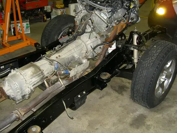

what engine is in the 99? Because you still have a 93 frame correct with TTB?
the SOHC 4.0L and 5.0L use engine mounts and oil pans that fit the IFS.

For swapping just the front end body parts, you will need the top edge of the other front clip. The 1st Gen. fenders are higher than the 2nd Gen. fenders. They both start at the same point, at the back of the hood, but the 95+ model fenders slope downward to a point several inches below where the 91-94 does. The radiator supports are about the same height at the center, but the corner area is several inches lower on the 95+ supports.

This is the 99 chassis, SOHC 4x4
