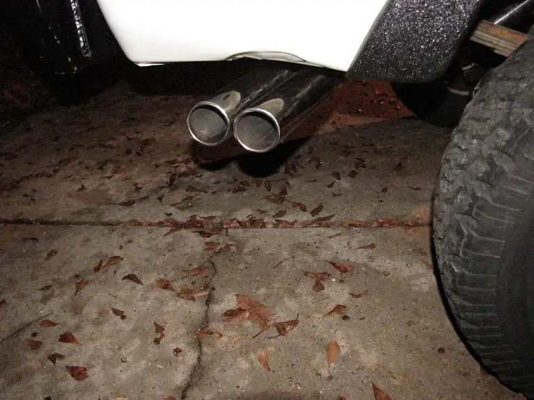

I added pictures of the exhaust system to the earlier post.
Here is picture of the end result - the tailpipes.

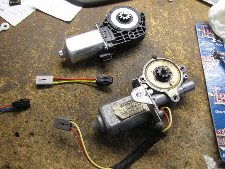

I replaced the window motor on the driver's door today.
My original one had a short - it was intermittent, but sitting for so long, then using it killed it.
I used a Dorman replacement motor. As you can see in the photo, it is not exactly the same. This motor fits multiple applications. Even the wiring harness need work - not only was it too short (workable, but not ideal), it was wired backwards!
So much for "bolts right on"...
I did the same thing with my passenger window recently because it stopped working. The factory window motor had threaded holes and the recplacement motor had no threads which required bolts & nuts. In the end the factory motor was fine, it was my regulator and window seals which needed some TLC & lube. The factory motor actually worked better than the replacement after testing both in operation.
Other thing to note was having to drill a hole in the inner sheet metal door skin just below the speaker to get access to the 3rd bolt holding the motor in place. I guess when they build the truck the regulator and motor are put in as an assembly.
Oh and good job with the overall project, your Ranger is awesome!!. I've owned a 1994 and a 2001 Ranger and if it wasn't for having kids I'd still probably have one!
On my replacement motor, the holes had no threads either - but course threaded sheet metal screws came with it, so I used them. I hope they hold up...
I had already drilled the access hole, having replaced the gearset in this motor twice.
Many kids don't fit to well in a Ranger, but I'm sure a 347-powered Ex is a blast to drive!
There is a lot of torque on those window motors, so if the sheet metal screws don't work then upgrade to bolts and nylock nuts w/washers. I was able to find some of a similar size M8 or something. I like to keep metric on vehicles or machines that come that way wherever possible.

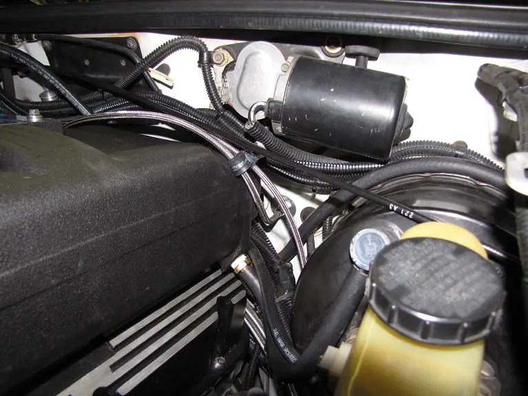

Here are some pictures of the throttle and TV cables.
At the throttle body, the TV cable is the upper cable, and the throttle cable is the lower one.
In the last picture, the throttle cable is coming through the firewall, and the TV cable is coming up from the transmission.

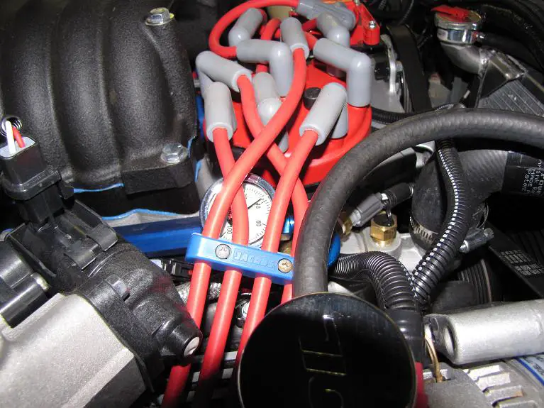

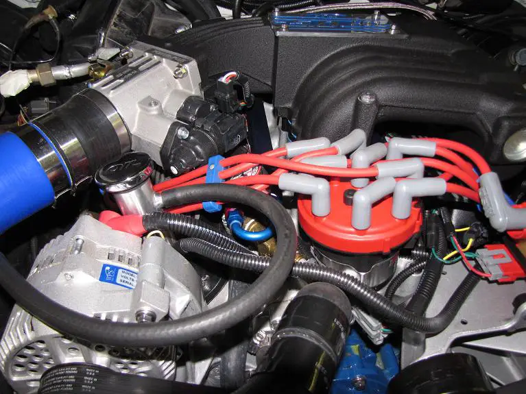

Fuel Pressure Gauge
The BBK fuel rails I am using do not have a port for checking/relieving fuel pressure. The pressure was one item we were not sure of during the initial engine starting/break-in process.
It is a little hard to see in the picture, but I put a pressure gauge on the input side of the fuel rail, between the fuel line and fuel rail. Aeroquip makes a fitting with a 1/8" NPT hole - perfect for a gauge.
