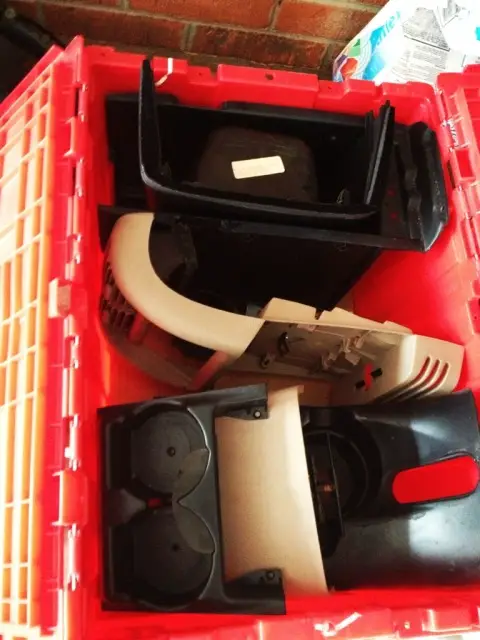

First and biggest is a tan 2nd Gen console.
In the box is all the top parts.
I grabbed 2 cup holder sections one side by side and one with the cup holders in-line.

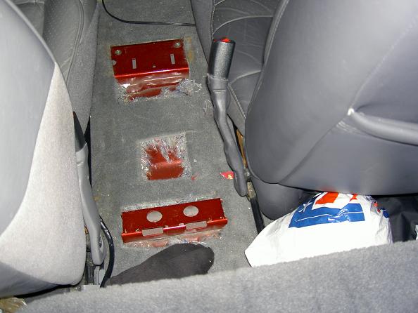

BTW, you really need to also buy the rear floor mount bracket for that console. It is riveted to the floor, and as heavy as that console is, that mount is critical. There are complaints about vibrations of the consoles in those trucks, and adding an extra screw or two around the middle are helps as I recall. That is with the rear floor mount, if you only used the kind of screws in the floor like the 91-94 trucks, the console will move even more.
Below is what the mount bracket looks like, and I'd probably use bolts to hold it very near the outer ends, add stability as much as possible.
I didn't have a drill with me to remove the bracket otherwise I would have got it.
I think I'm going to try and avoid getting that bracket if I can because it was a major pain to get the console to let go of the bracket.
Not sure I want to use bolts in the instillation of it either. I don't particularly like the idea of needing a second person to install or remove the console.
It's probably gonna be a while before I get this installed because I've got a few modifications I want to do to the console first. Also while I have the console out I want to pull the seats and place more insulation under the carpet; which I still need to research what to use.
That rear bracket is made for that console, the console pulls out from the back of the bracket. You only have to attach the bracket to the floor permanently, thus the bolts. I have a picture somewhere of that bracket still on the floor of my 99 truck before I removed it. The location is critical.

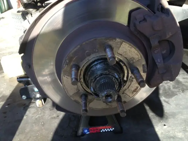

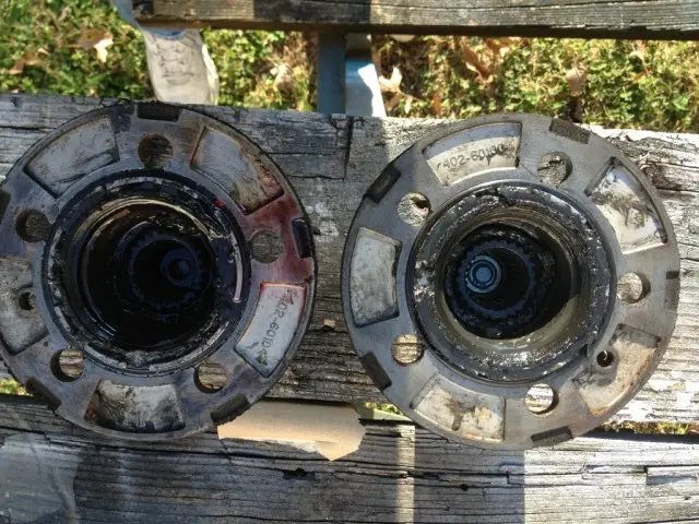

I started by cleaning the hubs as they were extremely greasy and from what I've read on here they work best when they are just lightly oiled.
I forgot to take a before pic but this was after I soaked them with some Awesome cleaner then washed them out with the hose. I then filled them with some cheap tranny fluid I had layin around. I also scrubbed the inside with a tooth brush.
Here's them pretty much finished.
I also noticed that the two hubs have different part part numbers.
I thought that these were same side to side?
But they also had different stickers on them. I just placed them on the side that they fit the best.
Here's what the spindle and brake stuff looked like.
I also figured while I had the chance I'd pain the dust shields. I went with some Ford Blue engine enamel I had layin around.
The pads need to be replaced but it looks like they'll be fine until after winter and the ball joints seemed alright too.

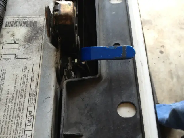

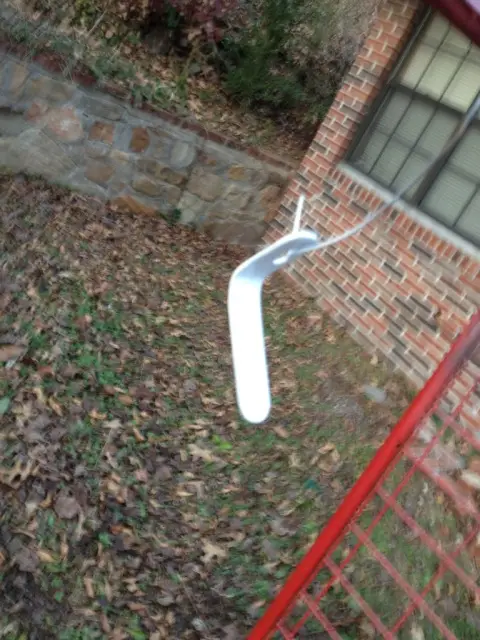

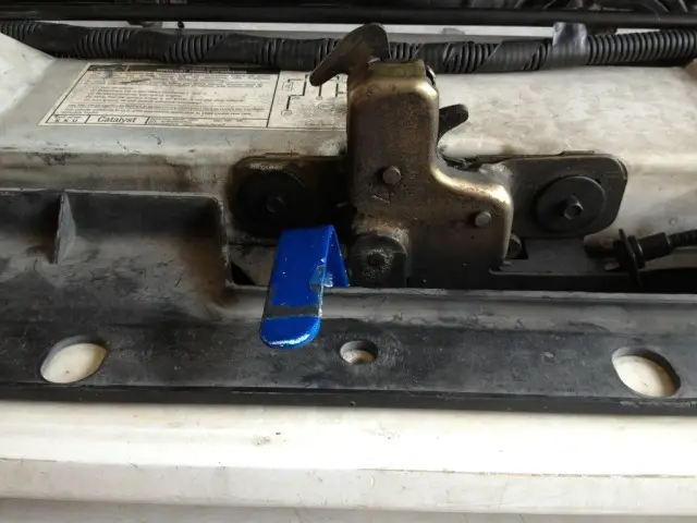

Last weekend I decided I was tired of using a screw driver to open the hood so I bent up a piece of 1/4" scrap I had layin around and used the angle grinder to round of the nose of it and cut it to size. I then used a 1/4" bolt to hold it to the original handle and now all you have to do is stick your hand under the hood and push up.
Here's a picture of it painted in white I covered the white with some more Ford Blue paint then bolted it up.
I didn't get a picture of it installed but I'll try to remember to this weekend.

Awesome work! How come you decided to take apart your 4wd?
Btw, Cant wait for the pic of your new hood assembly! I'm looking into modifying mine
I took the hubs off and cleaned them because the Auto Hubs are prone to failure.
Here's the finished pics of the hood release handle.
The paint had very little time to cure before I installed it so I think that's why it rubbed off I'll probably take it off and repaint it eventually but right now it's too cold here.
When the hood is closed it is right up against this piece of the hood but since it's a rubbery material it flexes and causes no problems.
And because of the positions I attached it you don't have to move it much to get the hood to open.

I have some mesh behind my grill to keep bugs and rocks out of the radiator and it's too tight of a weave for me to get my finger through. I had been using a screwdriver but I got tired of hunting for one.
The original release is still in tacked I just bolted mine too it.

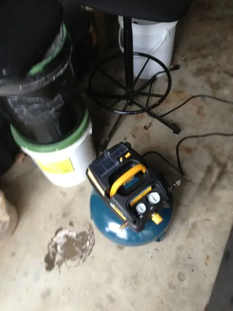

Biggest thing is a air compressor.
It's fairly small but should come in handy. Hopefully it's powerful enough to run an impact occasionally.

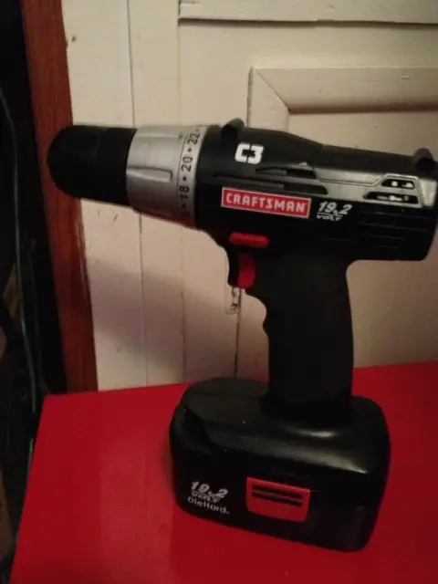

Also got a new drill.
My dad picked it up at an auction for 35$. It's brand new Craftsman with battery and charger also had an extra drill body.

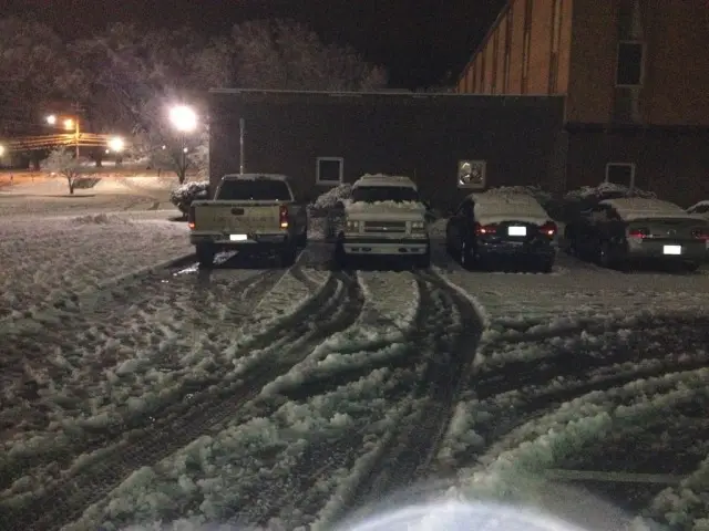

Here's my car in the school parking lot.
It's a mess outside right now since it's been raining since Monday we've had a good bit of flooding(I've got some pics I'll put up later). The county hasn't been able to treat the roads cause it'd all just was away so I'm expecting the roads to be ice in the morn when I head home.
I did go for a little drive to get some dinner right after the snow started add I'm am extremely impressed with the Ex. It did tons better in this wet sloppy snow then it did in the dry slow a couple years ago. I stayed in 2wheel the entire time and the only time it broke loose was when I gunned it to see if it would.
I would attribute this difference in handling to the tires. All around I am very happy with the performance of these Dakota Definitey AT2s.
