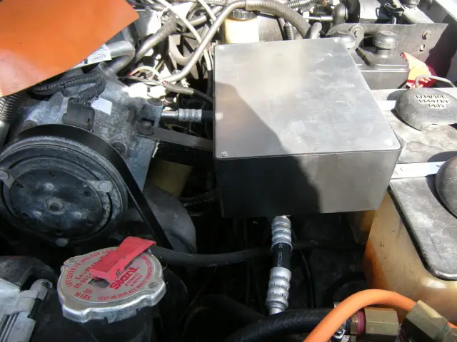

And not sure if I mentioned but here is where I mounted the relay box that will hopefully be finished by the end of this weekend.
It's mounted with 4 screws to the washer/coolant tanks and I made a metal bracket the bolts off of one of the A/C compressor bolts.
That's a nice box you got there I wanted to add a second one to mine when I put on some fog and driving lights and such any thing else I can think of. How many fuses can that hold?
It depends on what fuse panel you mount in it. It's just and empty project box from Radioshack. I'm gonna put a 12 position fuse panel in it along with about 6 relays.

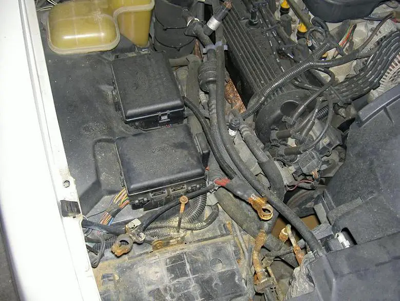

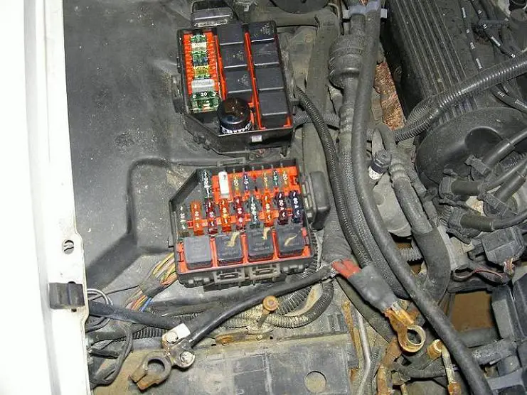

You might next time just cut out a PDB from a late Ford, and use those built in fuses and relays. I added one for my auxiliary devices in my first 95 Crown Vic.

I had thought about that but I couldn't find any that didn't use mostly Maxi Fuses. I wanted the mid size fuses because you can get them almost anywhere. Plus I didn't want to have to deal with rewiring a factory box.
Although after adding up my investment in this so far if I was to do it again I would go with a stock PDB and just keep a bunch of spare fuses in the truck. (I do keep spare fuse's now but I didn't when I started this project.)

That was about 2001 for my mail vehicle. I actually cut up an extra PDB to cut two up and epoxy the relay section from one into the other, replacing the large fuse section. I needed nine relays, two are inline in the trans wiring, which made it a 2 speed trans when a switch was activated.
I liked that method of wiring better than aftermarket parts. That allows you to swap other stock relays or fuses if needed, and if you carry extra items, they work for both.
For my 99 Explorer project years later, I only used one small auxiliary relay box, and made use of unused "holes" in the stock PDB. The smaller relay boxes are easy to find, many Fords have them under the dash, in quarter panels etc.
I started with one from under the 95-01 air cleaners. They are all modular, you can take them apart(difficult) and mix the components. You can make small boxes half of this size, or a square double this size, or larger if you need to.

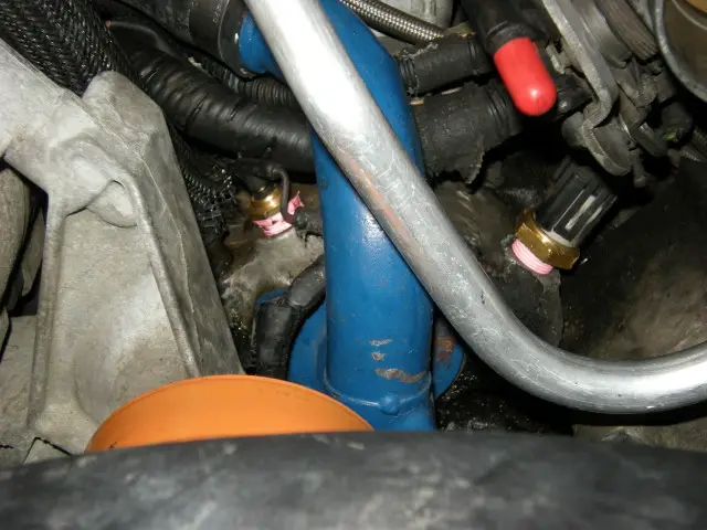

I changed the thermostat and both of the coolant temp senors in the engine. The one for the gauge had been replaced less than a year ago but I had an extra laying around that I bought for the Ranger but never put on. Plus it eliminates another variable in the swinging gauge issue.
So far the gauge stays steady but I think I still have a problem but I'm fairly sure it's electrical. The temp gauge doesn't stay straight up an down like normal. Last thermostat I had in was a 180* but this time I went with a 198* thermostat to see if it would make the gauge read like normal. I'm not too worried about this but I'd like to eventually fix it.
Do you know which sensor goes to the gauge? I knew the motor had one for the gauge and one for the PCM I think the gauge one is on the left right? I think mine has a 160 degree thermostat.
That's correct the Left one wire sensor is for the gauge and the right 2 wire sensor is for the PCM.
160 is too cold IMO unless you have done some other mods a 180 would be as low as I'd go.
