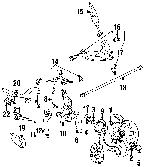

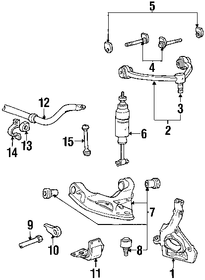

As long as the knuckles and wheel bearing/hub assemblies are good then you should be fine. The 2wd and 4wd both used the same upper and lower control arms, only the knuckles out were different.
What are you talking about when you say "knuckle"??
The part that mounts between the upper and lower ball joints that turns when you turn the wheel left and right. The tie rod end 'ends' into it and your brake caliper bracket and wheel bearings mount on it as well.
Its hard to tell from the pics if they are still good or not. Its depends if the lower ball joint broke or if it slid on the ground on the knuckle at all. You obviously broke tie rod ends but the knuckle could still be fine.
Even if the knuckles are shot on the V8 you can find replacements pretty cheap. Any of the guys on here that install a Superlift or do a solid axle swap should have their stock knuckles they can sell you for cheap. I'll have a set from my 97 this winter when it gets SAS'd.
I will keep you updated with the price that insurance offers for me to buy the truck back for and we'll see if it's worth it.
Does the knuckle kinda look like this?
