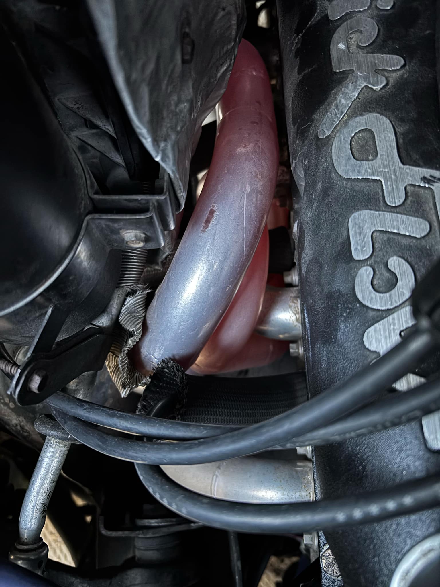

started off by trying to find a belt. 3 trips to the parts store and swapping 2 pulleys out. also a big time waster was the pulley bracket. i never notice it before but it was hitting one bolt on the water pump not allowing it to fit perfect. clearanced that, then the thermostat housing was now hitting it. ugh. clearance that as well. now the pulleys stat too far back. after a hour of screwing with that, and the belt for another hour, figured the rad and hoses can go in. followed that with coolant when i hear that o so familiar sound of liquid running out of the block, and onto the ground. so glade i made my tuning appointment for next week.

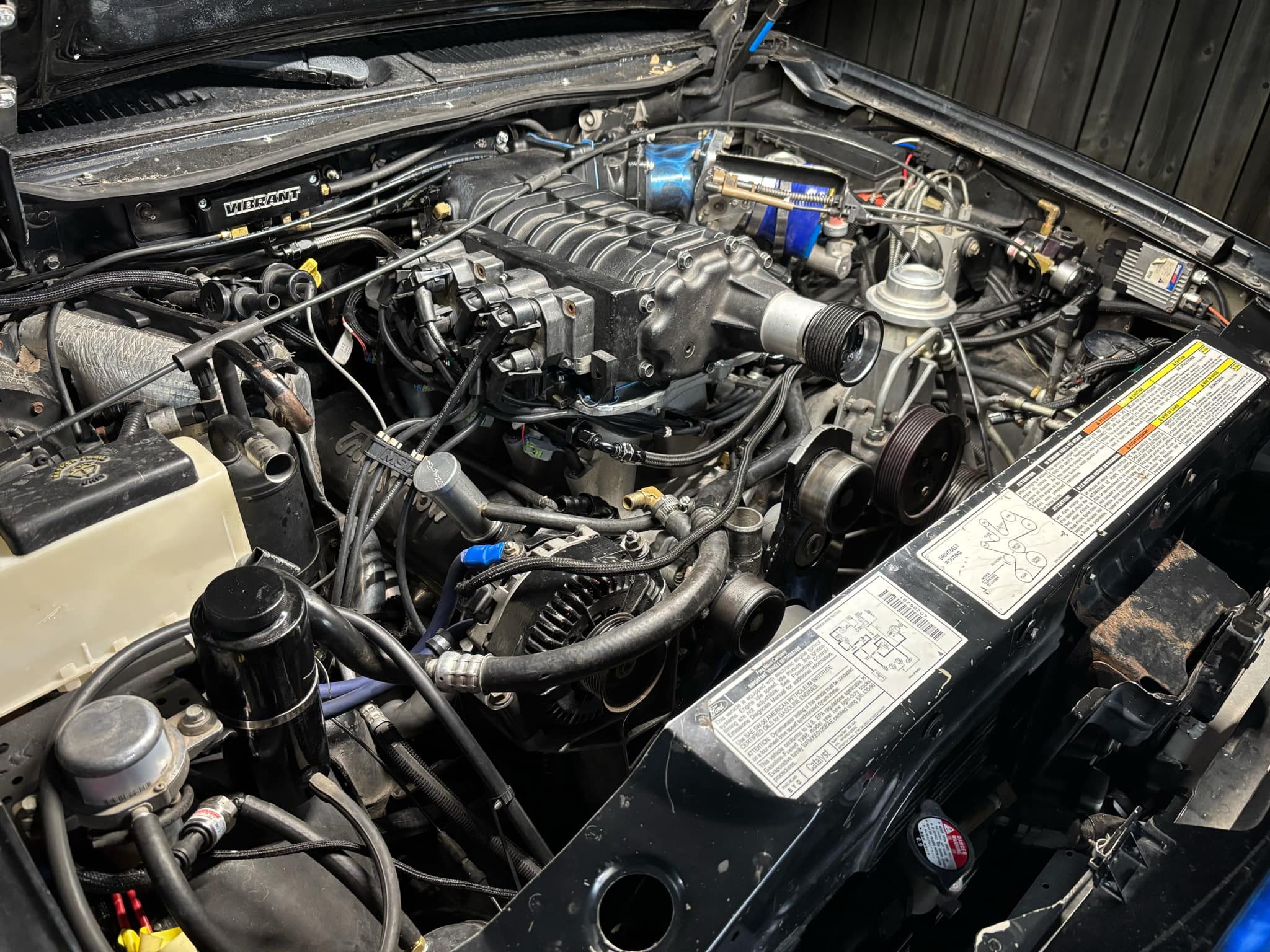

in other news, i put all my hoses back on checked the torque on the bolts (this time they all were pretty much there) and dumped water into it. i also powered up the water pump. so far i havent seen any drips. i will let it sit a few more hours and see if the level dropped or if there is water on the ground.

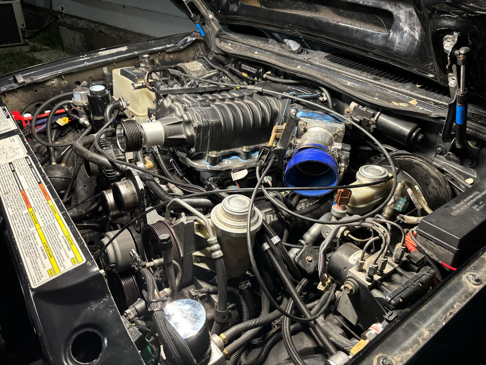

she appeared to hold water as of last night. i drained it (thats what i had was just water in it), and will go outside in a while to work on it. still a little chilly. need to put the blower on then smoke it to make sure it holds air. yes, kinda paranode with it from the last go a round.
held water like i said. then came the smoke. didnt see any where there wasnt suppose to be any. fill it up again with coolant (level is still dropping be thats to be expected till it burps itself out). then try to fire it. it wasnt happy. at one point i didnt think it was getting spark. had that thought of what the hell did i do now.....looked at the voltage and was reading around 9.5. thought it sounded a tad slow cranking. now i get to try my boost points. worked like a charm!
cranks and cranks and cranks.....then tries firing. then cranks and cranks then fires up and runs like crap and stalls. try again, cranks, fires runs like crap then like a flip of a switch clears up and starts idling! yay! once again i forgot all the vaseline i used for the injectors and making the fuel lines.
then starts smoking.....like mosquito fogger smoke. only to remember there is probably a ton of baby oil in the cylinders from smoking it.

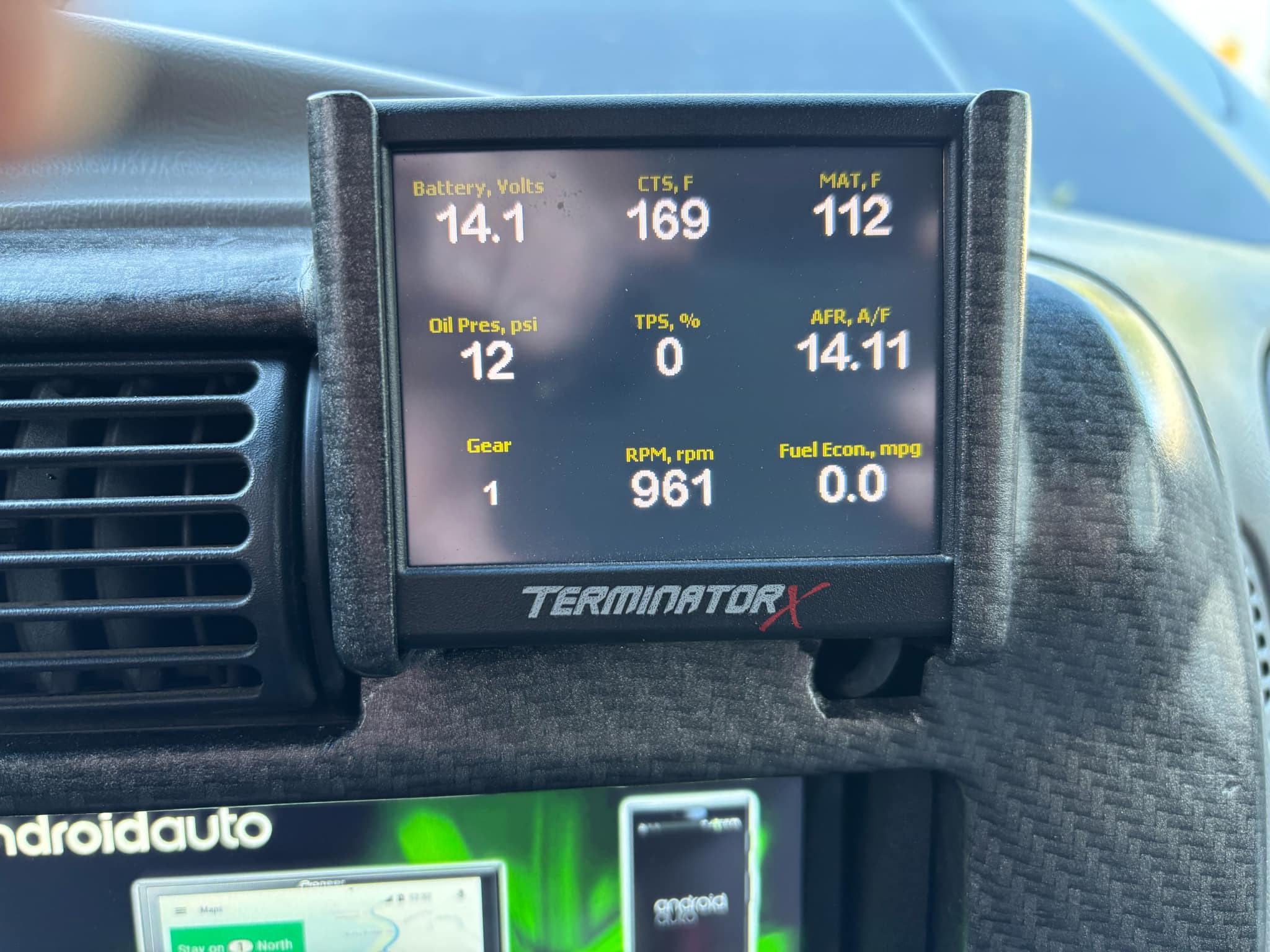

so the report card. one thing that made me real happy was how many volts it was displaying.
ever since ive had stroker motors in it, it has never made above 13.5/13.8 vols. granted the fans wernt on yet but still. i went to the back of the truck and hit the battery kill switch. it still ran and displayed 13.1 volts. nice. also dont worry about the oil pressure. it still needs to be rescaled (KOEO it reads -50). also has a hi idle. i am going to blame that on not doing a tps reset because i did have the tps off when i wanted to run the meth nozzle into the throttlebody.

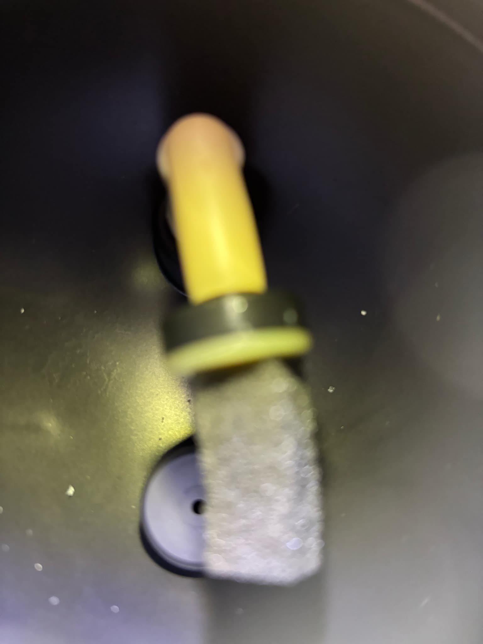

my vacuum pump is also not working the way it should. it will pulse like i was saying before. i am hoping the problem is with the vacuum ball and the way i drilled it. ran out to my friends place where my parts trucks are (same guy that pained evil, same guy that has my flipper parked at his place) and grabbed another ball. ever see in one of those?
sorry, a little blurry but its the best i could do holding a flash light in one hole, and shoving my phone in the other to take a picture. this is the valve that 4pointslow was talking about. i will take the new one and carefully drill the holes out or epoxy the fittings into the new ball.

Nice voltage reading mine is the same way I can't get it above 13.5 on the computer
My one-way valve went bad inside the vacuum ball so I simply added a Dorman one-way valve up on the vacuum line a little
im trying to figure the voltage thing out. electronicky what changed was i had a Rockford Fosgate 1 Farad Capacitor that was in it since i put a stereo in it 18ish years ago, the alt wire goes to the boost point now (4pointslow had said i should change that to the fuse link by the power distribution block on the drivers inner fender), and the smallest power wire for anything in the truck not counting my amps is 1 gauge. 1 gauge wire from the battery box to the boost point is 1 gauge, going to the starter and alt is 0, and all grounds are 0. i dont care, just happy i have more then 13.1 volts reading with all the electronics that i have thrown into it. then again its not hot out right now so that may change.
doubtfully but you wouldnt have a part number or know how i can find a part number for that?
There is a one way vacuum valve on just about every ford we work on! You should be able to get one at work
i dont know where they would be located on anything, or on what modules. the only valve that i know of is the one on the brake booster.
