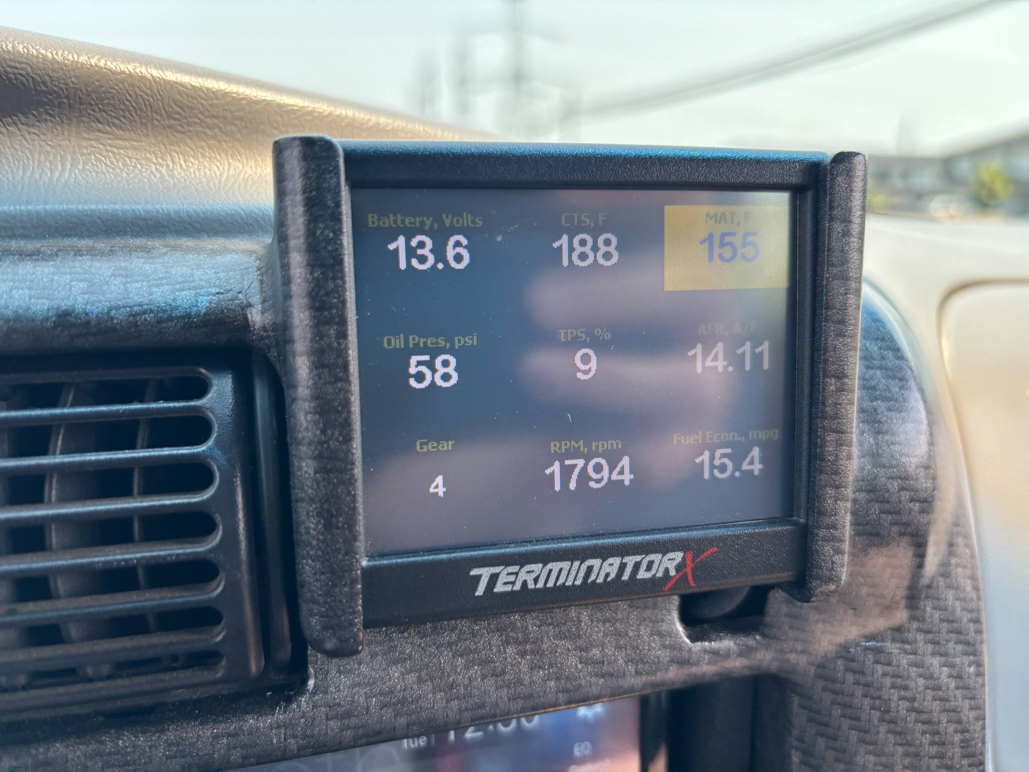

was finnially able to go for a ride in evil today. also wanted today because its around 28C or around 80F so i would see what kind of heat it would make. well.....
that was a couple of mins after getting on it (top right corner) and i dont mean going through 1, 2, and 3rd. saw it wick up to 180F. moving the nozzle just before the rotors didnt make any difference. i might have to figure out a way to put it after the rotors or under the blower. was about to order a intercooler but they would have to make it, which i knew and would be a week out, but they also didnt have the water inlet rails either.

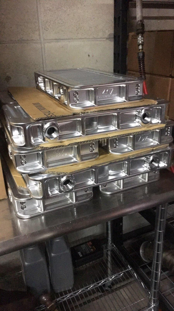

cant remember if i posted it, but it would come from here.
its 2 1/2 inches tall. hood clearance should be ok, but what i overlooked was firewall clearance. will have to look at that a little closer.

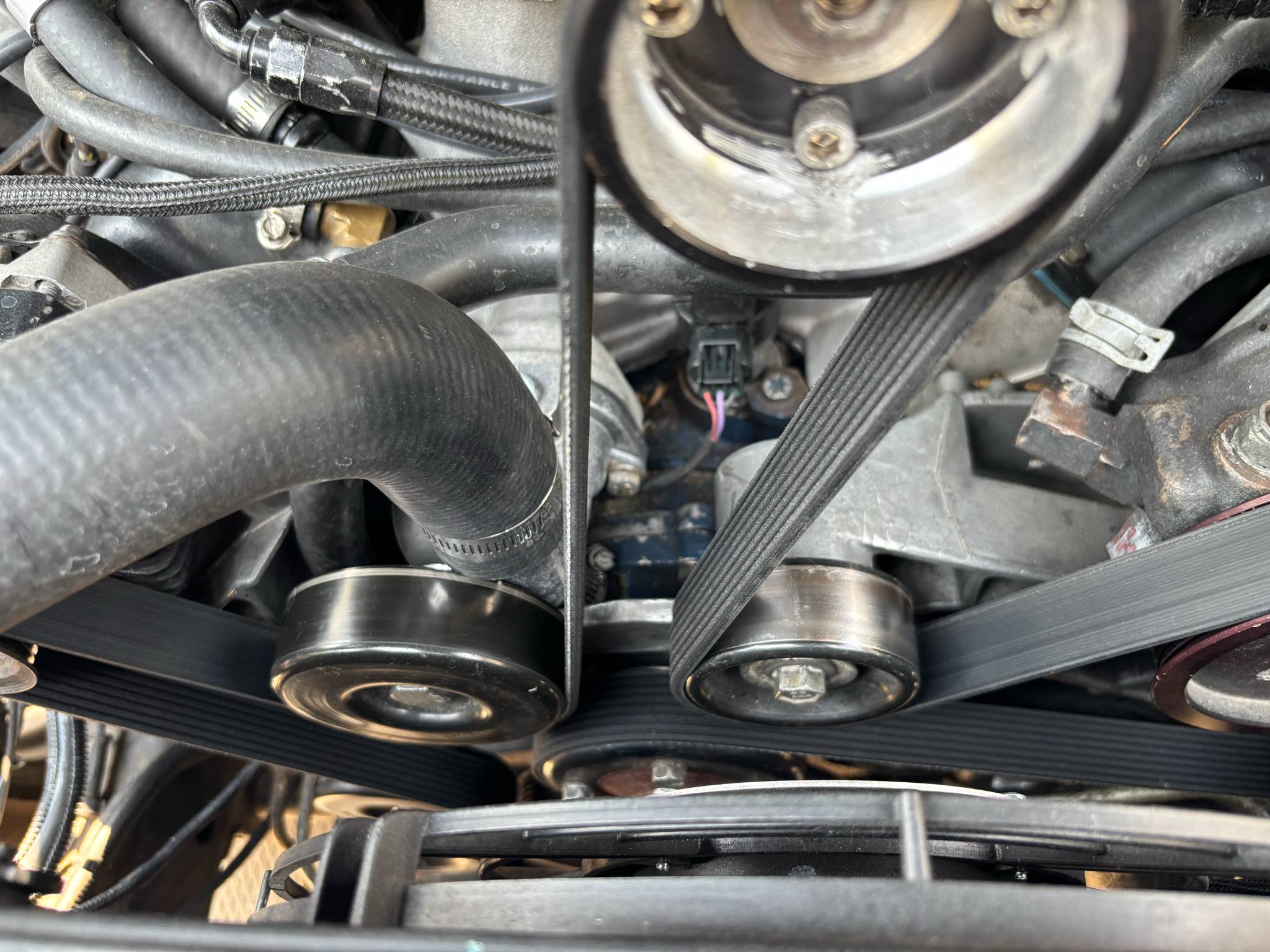

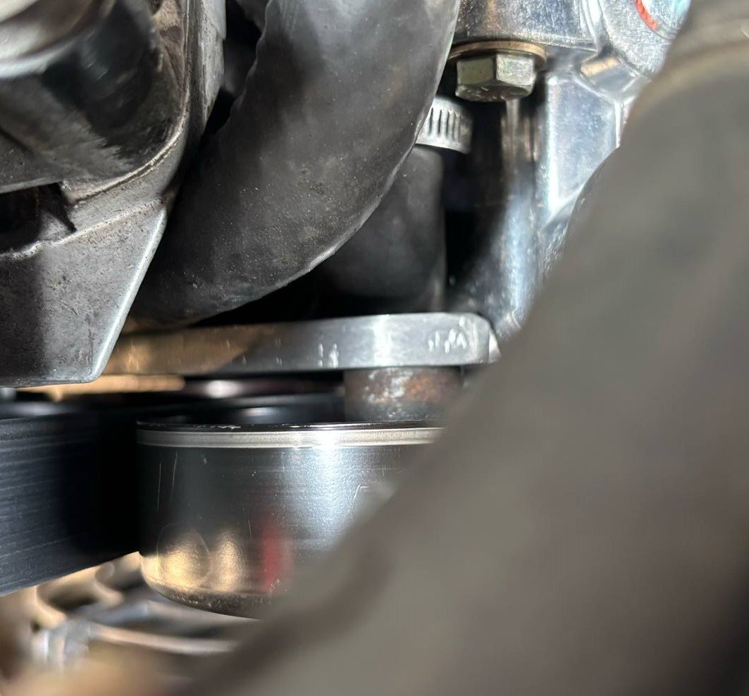

with that i also kinda cut up a different thermostat housing. because of holley making this intake so the thermostat is pushed out farther, the bypass hose rests directly on it. had to cut the hose back a far as i could, and also the pipe for the bypass as well. its kinda better, but still up against the pulley bracket.
not that this is going to help my iat's but it will sure help the temps in the truck.

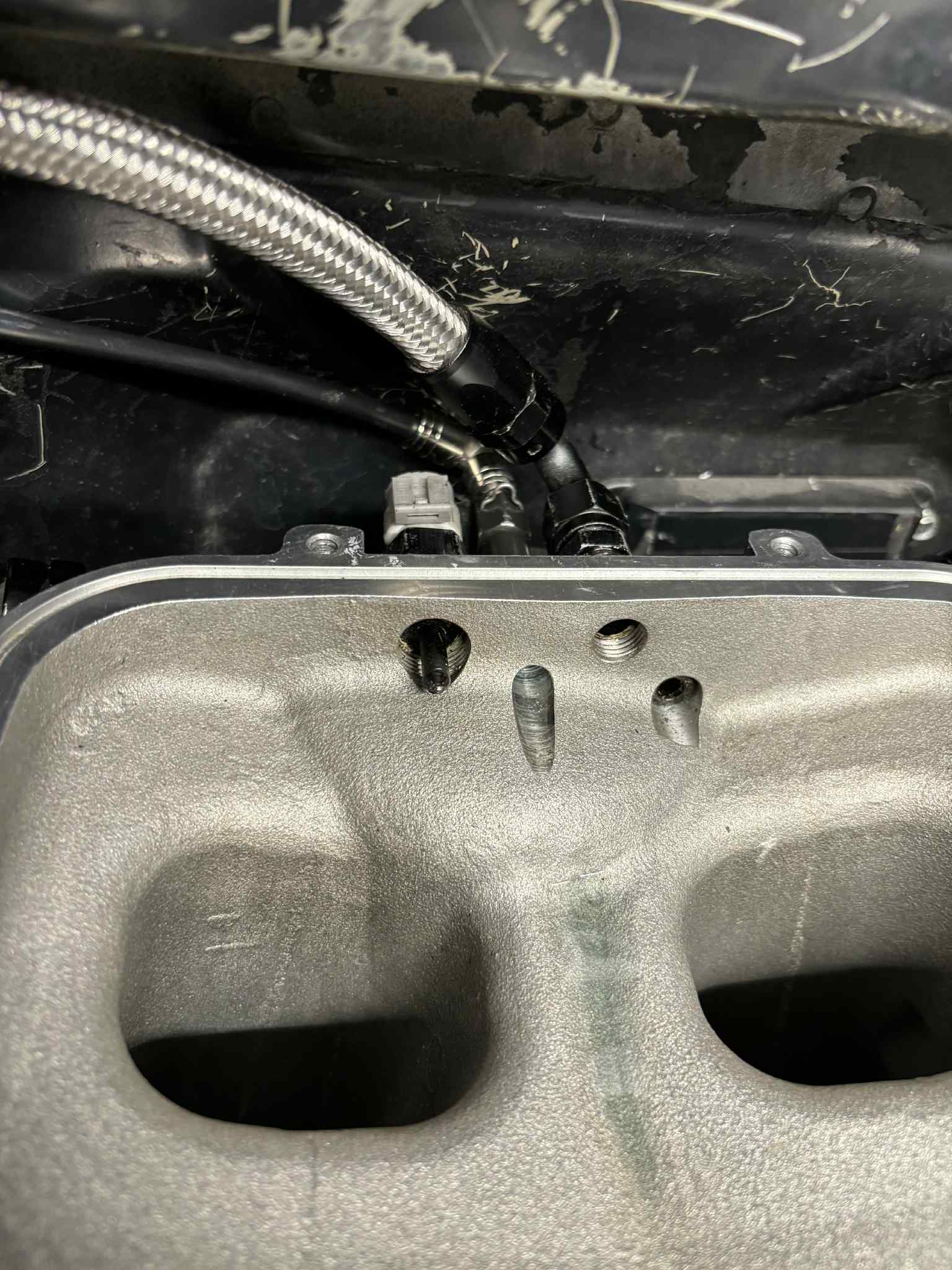

now that things have settled down i can jump back on a few things with evil. the main one is the intake air temps. when i took my cousin for a ride i watched the temps closely the couple of times i nailed it i watched it clime to 190 a few times, then heard major detonation. this was with the meth nozzle just behind the rotors in the supercharger case. once again i ordered a different nozzle but this time against what most people say, this is now under the rotors.
to the left is the iat sensor. to the right is my line going to the vacuum block. not hopeful this will work, but i gotta try because i also learned something else tonight. the intercooler i was going to get will not fit. of all things, it will be way to close to the firewall for the supercharger. didnt see that coming. at the same time even the lowest profile one i found isnt cheap either. so if this doesnt work i may be forced to go back to my old set up which is something i really dont want to do.

i drilled and tapped a hole to move the meth nozzle to the front of the base. i also did it at a small angle so it wasnt shooting up as much into the rotors (still does but not as bad). i have a picture of it but some people (including me :pics:) are having a hard time posting pictures. the results are the same. im getting a little confused here. i have moved the nozzle 3 times, and it made zero difference. im at the point now i believe where i either pull it all off and put the old set up back on which means it will foul the rear plugs if it sits idling too long or buy another intercooler brick and hope i can make a intercooler that will fit.
