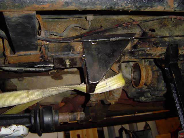

Here is the start on my new rad arm brackets.... still needs angled peice in the front going up on the inside of the frame rail. What do you think?
another
Now I can see that you do know how to weld. :)
Lookin' good.
That 1/2" steel? on second thought, looks like maybe its only 1/4", except for the piece with the hole.
Its half in stock supposedly. But is more like 3/8.the thicker part is two butted together for the bushings. Stock setups are smoother so we will see how long the bushings hold up. It isn't driven everyday so should be fine.
I can weld when I take my time and do it right;) need to work on that whole upside down welding situation...:p

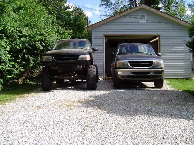

Woo Hoo! She drives! can't wait to flex it out tuesday and measure for shocks. only issues minus shocks to resolve are:
- Driveshafts
- Replace some bolts with right length and right grade on steering
- make trac bar mount and relocate track bar. The setup now was just temporary and I now have experienced some SERIOUS bump steer!
- mount break line like at frame (just hanging now)
- little fender trimming inside drivers side
- Wash the beast
- Drive and ENJOY!

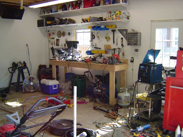

oh and I gotta clean up this mess....:(

Looks Great Dave!! Congrats!!!
btw: at some point, you have to paint the trim on the garage:D
every weekend I want to do it we get rain, I want it to be nice and dry. could have done it today, but had more important things to finish up :D
Looks awesome Taxxman. You and Robb have exactly what I have always wanted. Two X's, one setup for off-roading and one for daily driving (street).
Very, very smoooooothh!!! I think washing her would be a waste of time- get her dirtier first then wash her! :D
