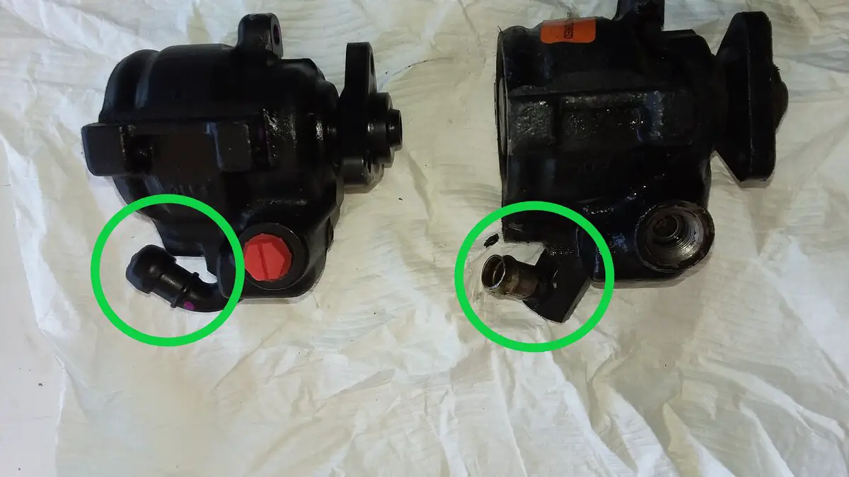

A socket pushing the seal over a big punch enlarges them easy enough, prior to install.
I had to go to 4 parts stores to find the 7" of 3/4" hose. Last one was my last hope for a Sunday, and one I avoid, but I lucked out. Only took 1.5 hours round trip, for $3.00 worth. AutoZone sells by the foot. Now to put this sucker back together & see if it will chooch or not.
Edit:
All buckled back together with a hope & a prayer. Good & bad...
Good: Steering fluids are pumping crazy good in the resevoir now, like a strong visible stream can be seen. After it was bled (both tires off the ground ), the wheels move effortlessly when done. The test ride also confirmed it has improved majorly. Like night & day difference. Yay Diddley doo!!
The bad: The low pressure line elbow on the new pump is an issue for the rubber line clamp. There was barely any room to squeeze the line onto it, and to get it pushed back far enough for a clamp, was a fight! so.. yeah.... There was no way to get the squeeze clamp where it needed to be as it just hits the pump housing. I was able to get a worm clamp on it, but it rides at the very end of the rubber line. Me no likey that. It doesn't leak, and it is low pressure, so hopefully it holds when the Merc V is up to temp.
New on the left, 7 month old reman on the right.
Because it is a press fitting tube, I didn't want to pry on it, to make room for the hose & clamp. Last thing I wanted was to ruin it, and be back to sq one, and out the $$ for it. I will keep an eye on it for a while.
