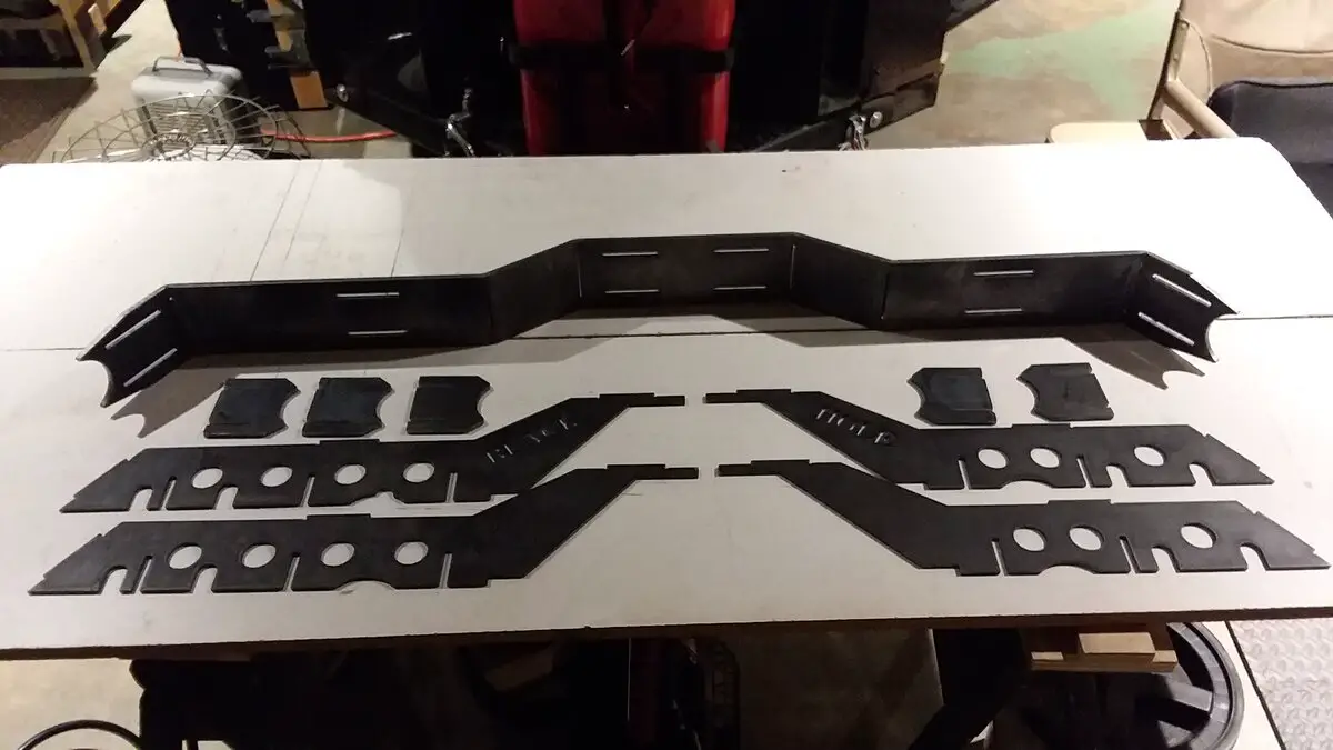

If anybody remembers, way back when, I posted I wanted a Truss to handle the weight of the trailer for off road abuse. We also recently discussed the Timbren bump stops, and how they needed a pad welded onto the axle. Well, that was the kick in the pants I needed to get both of those figured out. My answer to both was a truss that can do both.
I found a small home based type custom fab shop in Ohio, that was willing to work with me, on a one off custom truss. After first contact and explaining what I wanted, he had the means, and the willingness to help. Not 3 years from now, not 6 months from now, but right there & then. Sick. Within 2 days, he had it figured out, the CAD render finished, and after talking out the details, he had it cut & bent. 2 weeks later, and I have it in my hands. Sicker yet. Now that is unheard of service, and I couldn't be any happier with his commitment, professionalism, and did what he said he would do. He didn't have the font I wanted for the wording, but instead of telling me no, he found it, and added it to his collection. Super sick. It also helped he is a 8.8 fan, and runs one in his 4 linked crawler. lol
Ok, so this thing....It's a full width low profile Truss. 1 pc 1/4" top plate that is 4" deep, and made for the bump stops to land on it at 3" tall. I can get rid of the upper spacers now. Woot!
Vertical walls are 3/16". There are 4 of them that are tabbed for perfect fitment to the top. The slotted inside tube supports are 1/4". Vent tube slot, and wide U-bolt slots for thick aftermarket bolts.
Now I have to decide weather I want to wait until spring to do this myself, or take it to a fab shop with a thermostat, and pay them to install it. If I can get a set price on it, that might happen. It's not a straight forward install. Besides the normal prep-work needed, there are a few odd things, that go along with the job. If people will only want to take a T&M agreement, I will wait until spring, and do it myself.

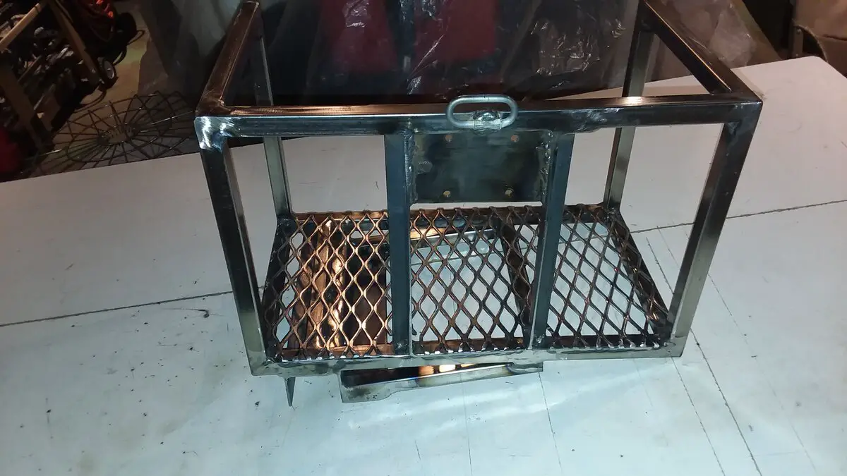

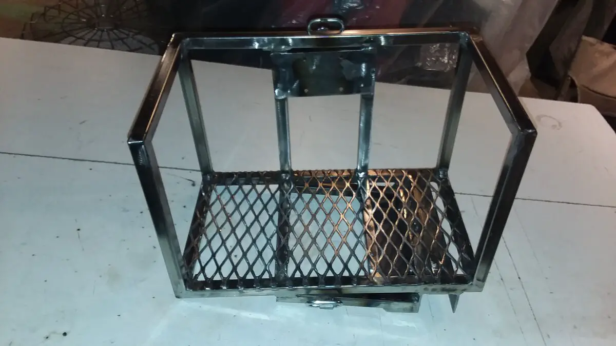

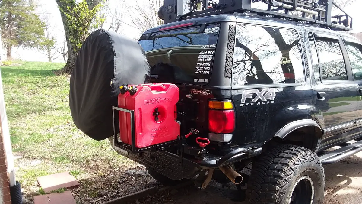

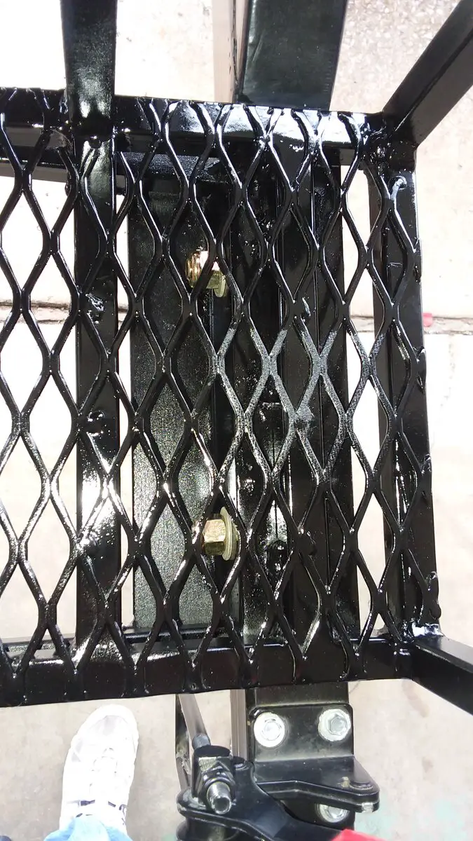

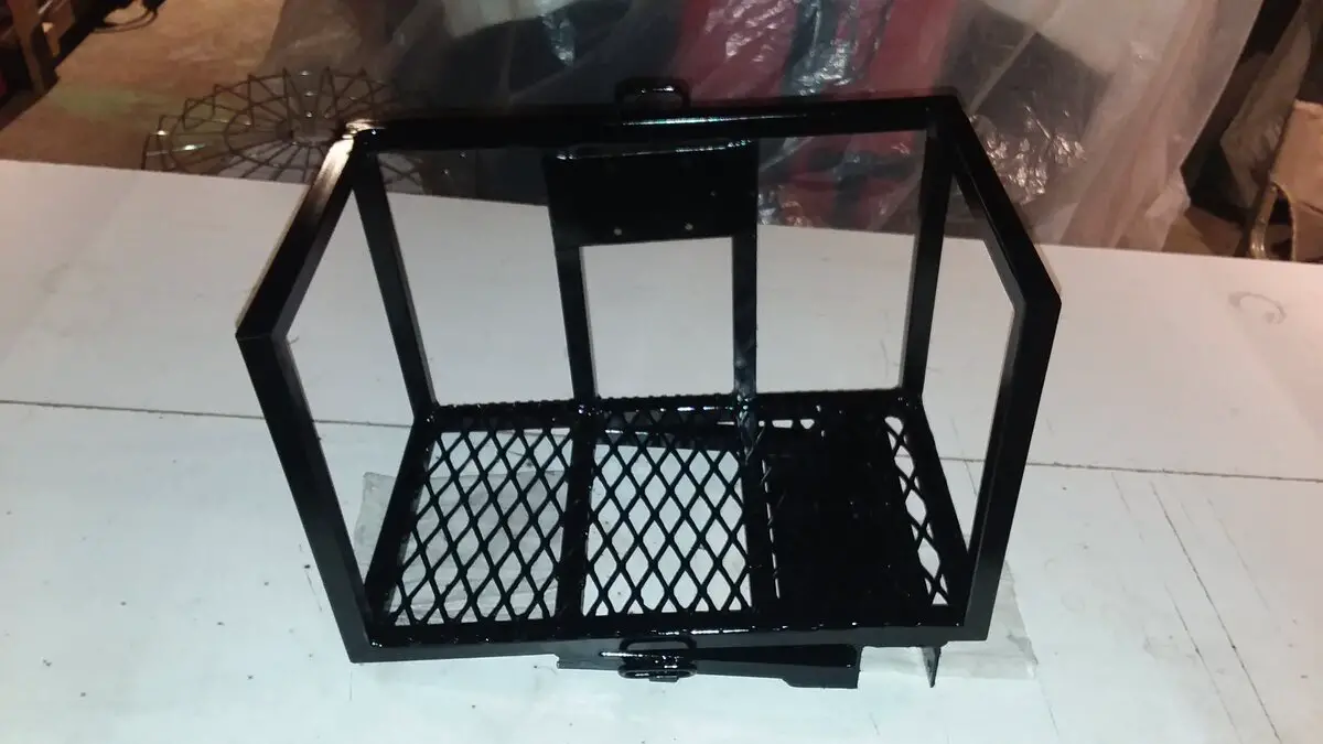

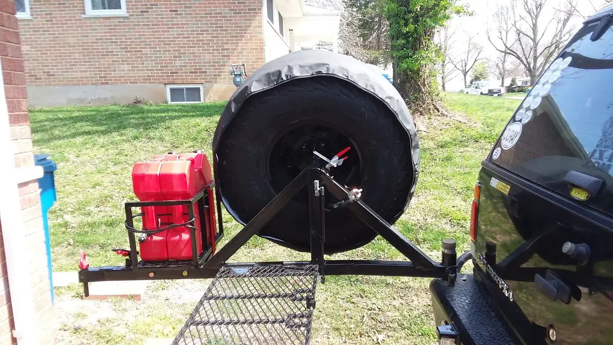

RotoPax project part 1:
Had always wanted to be able to carry a spare fuel can on this rig since day one. I bought a new Jerry can, and a Smitty built can mount, years and years ago for it, but never had a spot for it. It sat until it was eventually used on the camping trailer, in front of the tongue box.
Well, I had to remove that from the trailer, as it was obstructing the rigs spare tire swingout, from opening fully. This meant I couldn't open the rigs rear hatch, with the trailer hitched up. So back to no spare fuel can.
I decided I wanted to remedy this right away, and figure it out. I looked around on the webs, and local sale posts on social media. I found a person selling his RotoPax setup for cheap. I priced all he was offering and he was 1/3 retail anywhere for all of it. Now I figured I could fabricate something for these on the tire swingout, and bought them. This setup was two 3 gal cans, two individual RotoPax mounts, with two Rhino Rack adapters for each.
I decided against putting them up in the roof rack, as I wanted them lower for a couple reasons. This meant I needed to stack them together. I have seen others do this, and went to researching the special mounts needed. After finding the extension adapter, the reviews on them wasn't that great. Seems the biggest issue with these, is the bolt inside them tends to shear in half, due to the weight and off road abuse, and the cans fall off. I didn't want that to happen, so I thunk it out a bit.

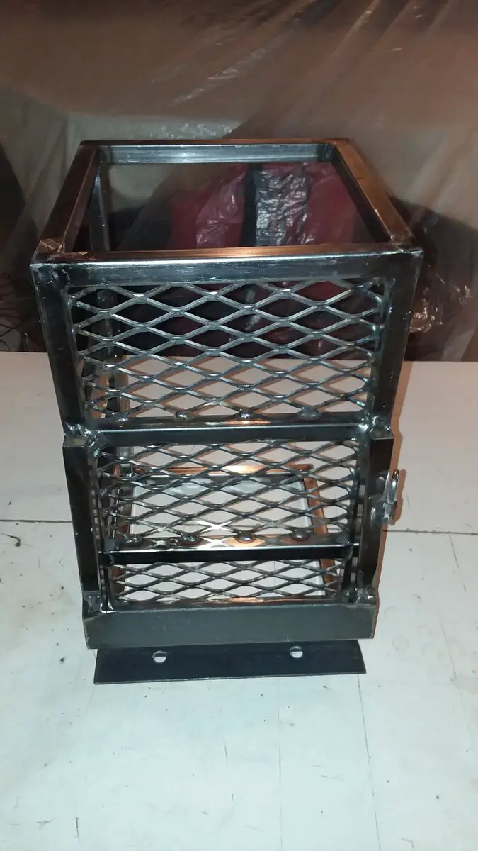

Soooo..... Since the weight/forces was the issue on the bolt breakage, all I needed to use them for was to clamp them tight to the cans. By supporting the weight underneath them that would solve it. Ok, bought the extension mount, and got to putting this to paper.
Quick run for some 3/4" sq tube, and fired up the chop saw. I didn't want any open ends, so I 45* cut them. Once the box was made, I added 1/8" expanded metal for a bottom. A plate welded to the middle uprights for the Rotopax mount, and a couple rings for straps was added. To help support the weight from the 2"x2" main mount bracket, I added a couple runs of 3/4" tube a bit more than halfway underneath. A little triangulation goes a long way.
Entire thing weights 10 lbs.

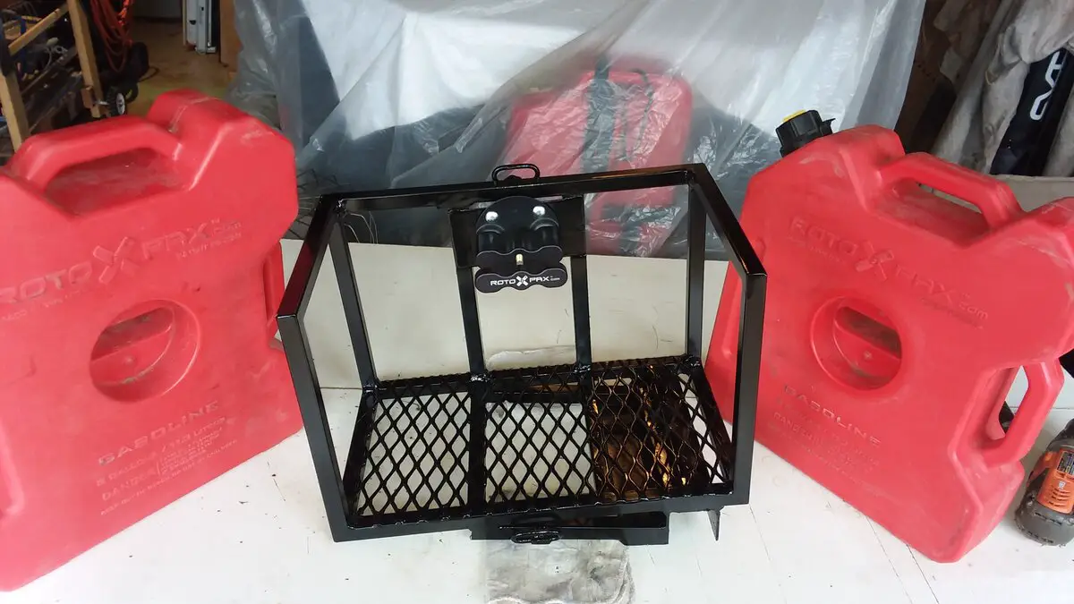

Rotopax project part 2:
Once it was all cleaned up, it got a couple coats of self etch primer, and a couple top coats of gloss black. I thought about having it powdercoated, but didn't feel like waiting, and the cost was $100 quoted to me. Meh....
Good enough for this application!

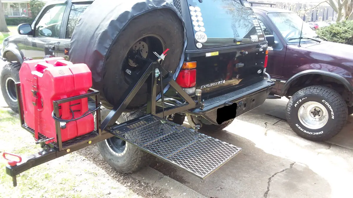

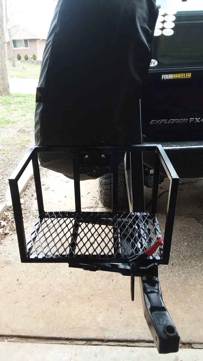

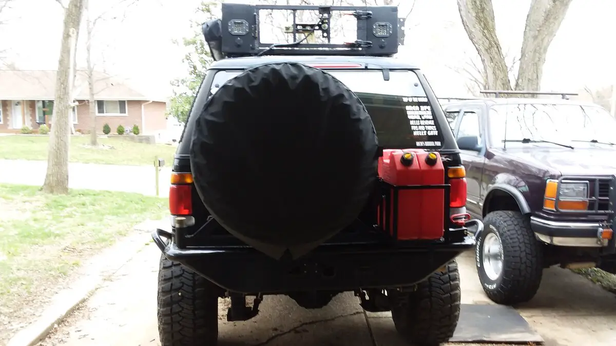

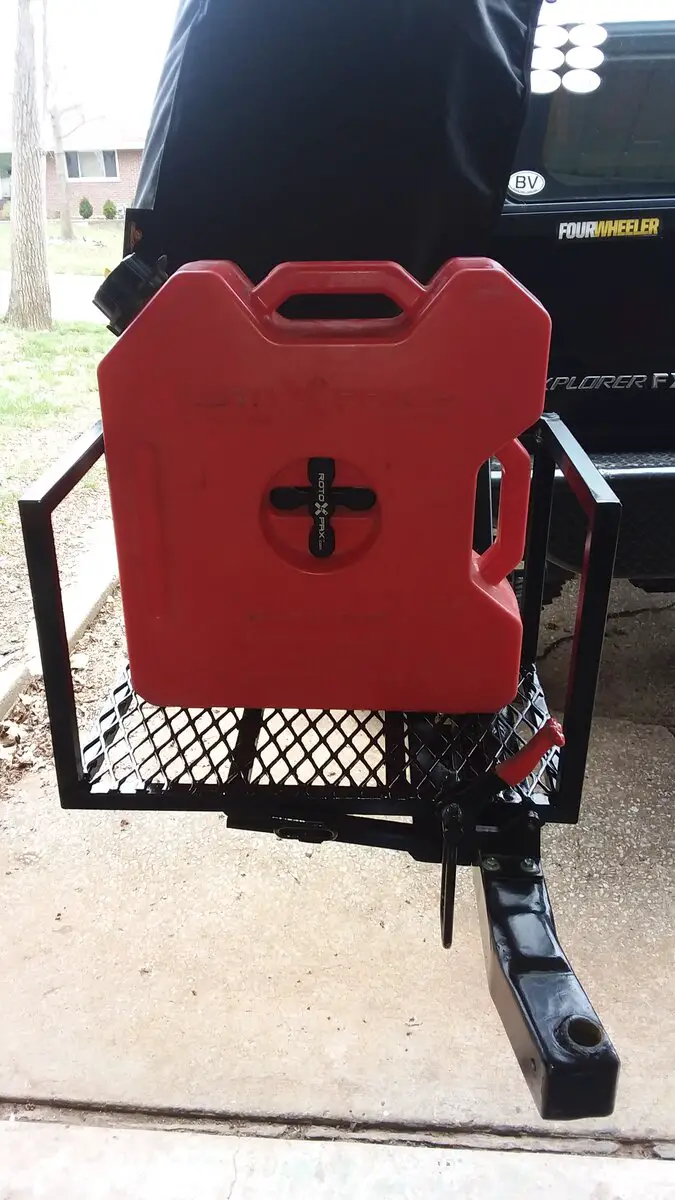

Rotopax project part 3:

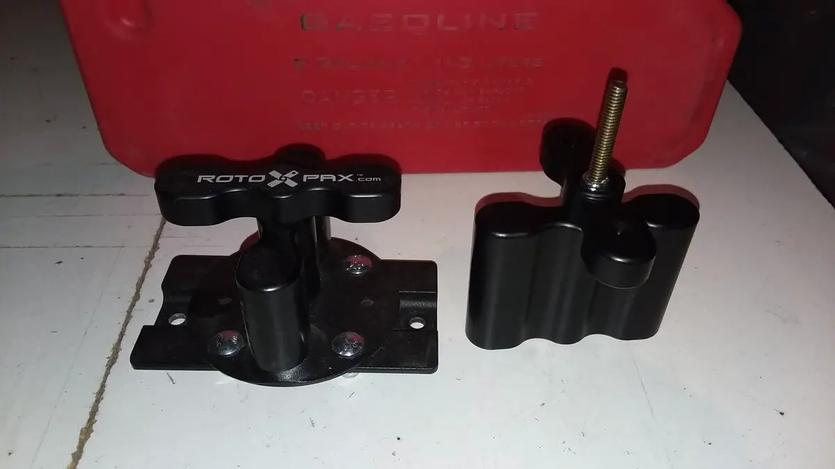

After the paint had cured out, it was time to install it to the tire swing.
On the left is the main RotoPax mount, with the Rhino rack adapter on it. On the right is the extension to stack 2 cans together.
I removed the rack adapter, and flush mounted the main mount to the plate on the box uprights.

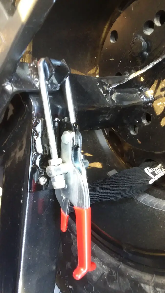

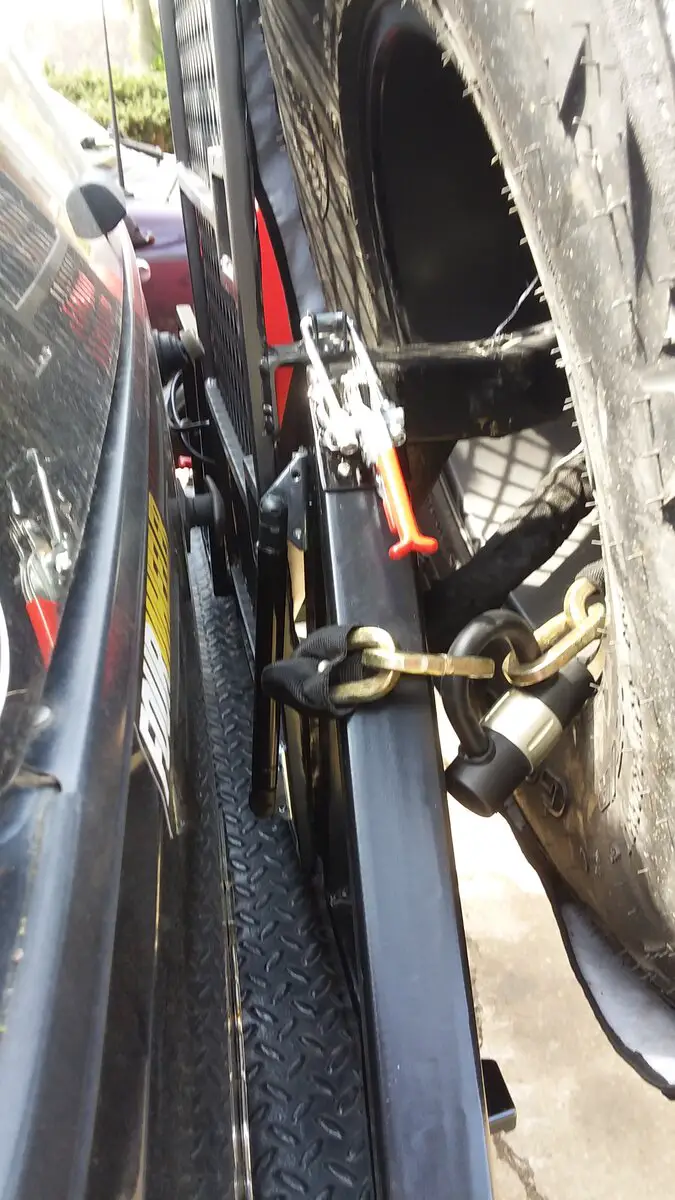

The bracket I made underneath it simply drops over the 2"x2" tube on the swingout, to the right of the tire. I made it to orientate this direction, because the other way would interfere with the swingout's locking latch. The box was pushed back a little so the box wouldn't extend past the spare tire, but leaves a gap between it and the rigs hatch.
Two grade 8, 1/2" bolts secure it to the tube.
Single 3 gal can test.
All good to go!

RotoPax project part 4:
Installed the extension adapter, and the 2nd 3 gal can. they both sit on the expanded metal, and the Rotpax mount firmly clamps them in place.
The military Jerry strap I have is about 6" too short to work. :( Need to find a longer one. Bummed about that, but oh well. It's just a secondary security backup, but one I will use. I added a cable lock to them as well. These have dual handles on the cans, so it made it easy to do.
I had to move the tag from the hatch to the bumper now that these blocked it. Easy as pie. I drilled and tapped 1/4'-20 holes into the diamond plate, and used stainless hardware. Added a new tag light, and used the stock tag light wiring harness. A 3/8" hole with a rubber grommet, some split loom, and Bam, all done.
On to the next mod!

Finished up the rear swing out mods over the weekend. Well, until I get another hair brained idea at least.
This one took a couple tries. Because the swing out was not made straight across, and has a kick out at the hinge, it made this little build interesting.
The Dr side angle of the tire mount sticks out further than the Pass side, so it's not flush across. The first attempt failed after I realized this wouldn't fit flush against it, and could not be mounted as planned. Back it went to the table, some cutting, some grinding, some new metal welded, and hit it at a different approach for mounting/use.
Confused yet? I was for a while too, don't feel bad.
All welded up using 1/2" Sq tube, and 1/8" expanded metal. Hinges of choice are sealed Exterior Gate hinges. These can stand up to the elements. Total thickness of it is 5/8".
Off to the paint booth, for self etch primer and Hammered black top coats. Once cured, it was bolted to the swing out by the hinges. I tapped some holes, and used SS screws.
To hold it closed, a locking toggle type clamp latch was welded to a 1/8" plate, then bolted to tapped holes. The latch catch had to be extended, so a small pc of angle was used, and welded up. You can see it in the picture above.
Instead of using a length of chain, or cable to hold it, I opted for a 15"x 25 lb gas prop. Reason being is that the Gate hinges can only open to 90*, and pretty much hold the 5 lb weight of this table. The gas prop lets it open slow, and holds it tight (assisting the toggle clamp) when closed, for a rattle free application.
Table down, and swing out opened at 90*. Not the best placement, but it was this or nothing. I can make it work.
Swing out opened 180*. this gives more room to work around the table. This will most likely be the position when used, as it frees up all the camp box extension items when used.
All closed up
And the gap between it and the hatch door.
Have a brand new Trash-a-roo bag for the spare tire. Will have to remove the tire cover when using it tho, which is fine as it will only be used on trips.
Well, that's it for now. More planned, but not sure if I have time to get them done before the next major trip out. Have a shakedown run with a friend in a couple of weeks, and the rig needs to be usable for that. We shall see.
