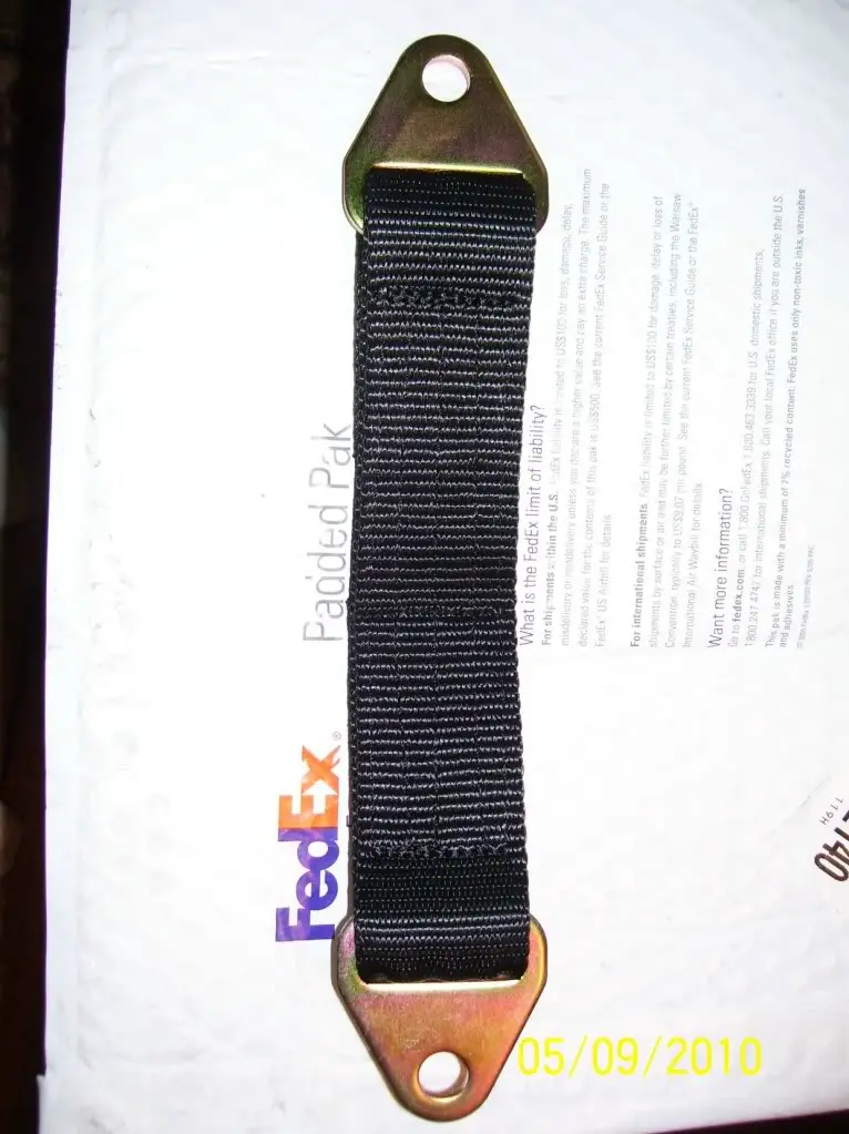

Got a set of "Beef" limit straps to install.:D

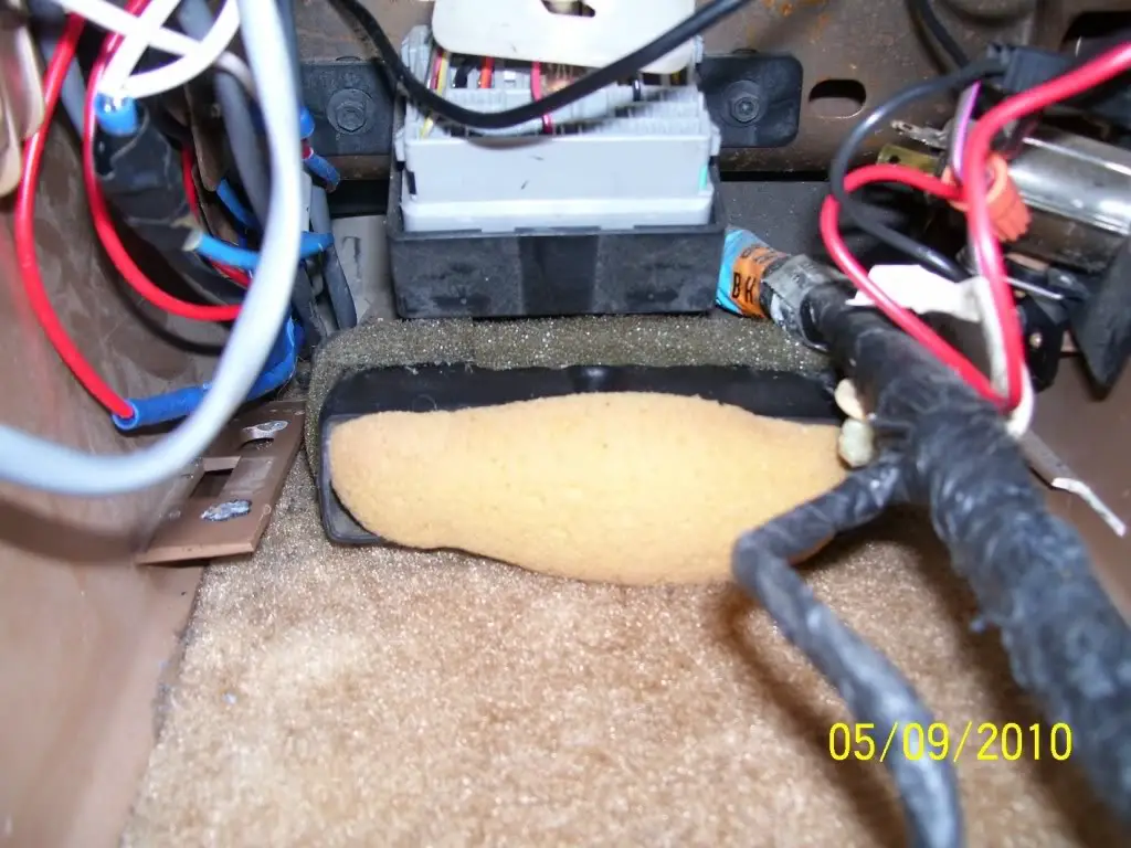

Now I had to block off the dash duct to stop the air flow. I used a commercial grade sponge, conformed real nice.
Ok that is taken care of...phew, on to the next problem.....:rolleyes:
Mind if I ask where the limit straps are from and how long they are.

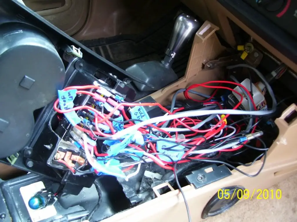

With the duct removed it is time to tackle the mess of wires under the console from the ashtray switches.
7 switches=21 wires..:eek:
Here is my latest MOD:
1st off lets take a look at the offending mess
Crazy right? I need to get ALL those wires out of there! After a little thinking,
I came up with this idea.
:cool:

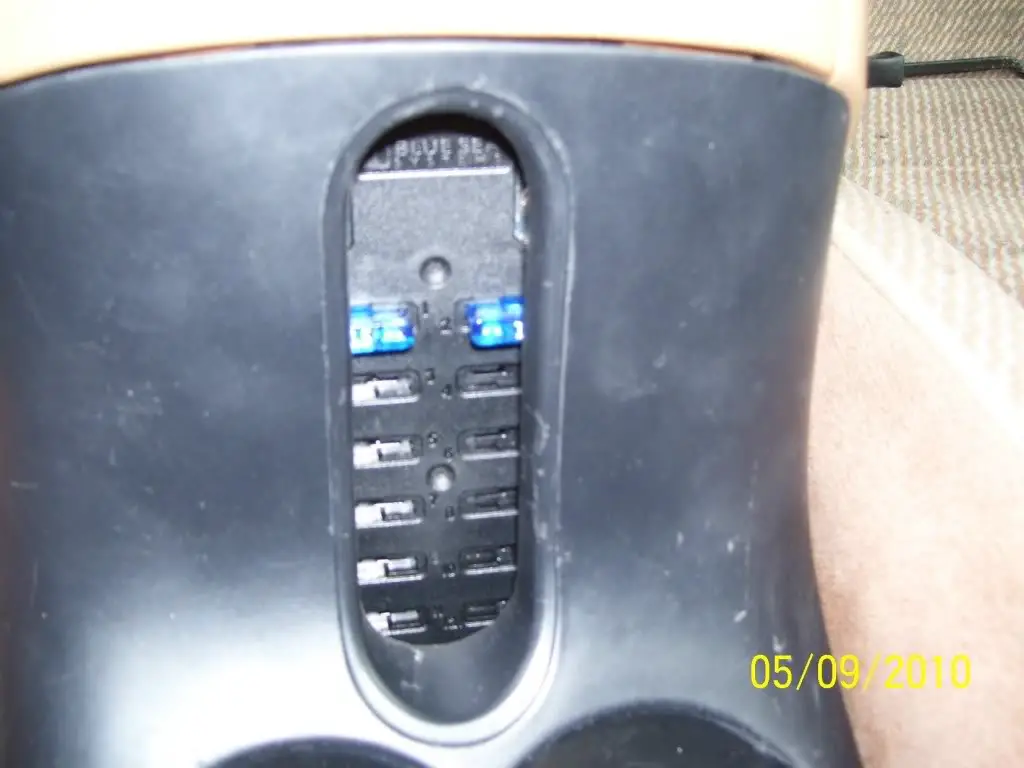

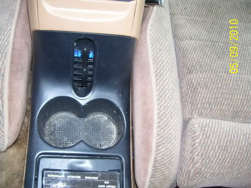

With the console pocket, ashtray, and Kleenex box removed, I figured I could run a fuse block under here somewhere, ...hmmm.....But where?
How about right there ;) The stock coin holder in the console looked like the right place for it to me.
So out it came.
Then the coin holder removed. It is held on by a few small torque bits. Careful now...there are 3 good size springs and 3 plastic caps inside that will shoot out after the last screw is removed. I put it back together and set aside for later.
Now all that's left is the tray. I used the Dremel to cut a little notch on the bottom for the 4 ga wires. Drilled some holes, and bolted up a fuse block to the tray.
Slid the whole thing back in from the Outside of the console.
Now it was time to install the coin holder. It simply slides back on going from under the lid, inside the console.
Here it is installed.
Just run the 4 ga wires up the sides of the console, through the firewall (using a grommet) positive to a keyed safety switch before the battery, ground to the chassis.
That's it, all done with installing the fuse block! Now to spend a lifetime hooking up all those wires to it :rolleyes:
Straps are 12". I am going to be using adjustable clevis mounts attached to the LCA & tabs on the frame. Those will give or take a couple inches on the straps.
I got them off a vendor on a different forum, ...sorry guys, I had too :p:

That looks like fun, and see how much space that ducting took up. If those switches are controlling stuff under hood or far away, you could place the relays apart under the hood or another remote place. Ford started a wise habit in the 90's by avoiding running high powered wires in the dash etc. That increased the number of wires by a bunch, but most of the switches and controls are very low powered wires.
I placed an extra turn signal switch on my right door panel(top switch), and this time I made it a relay control, triggered by a ground. That was smart because any rain or water that gets to the switch, it only would complete a ground circuit and trigger a relay.
Wiring is an art, keep at it.
So Don, when are you coming over to help with all the wiring? lol :p:
That duct did take a lot of space, for sure. It will be a ton easier to install the shifter with everything out of the way.
I have some general knowledge of wiring, but nothing extensive. Learning how to utilize relays is a major step for me. :thumbsup:
I was thinking the relays would be nice and hidden under the console. I have seen some installed behind the Dr seat, and elsewhere in the open. To me, that's just fugly.
These wires under the console are just for lights and the front CAD. If I was to have them all running at the same time (which I never do) they total 130 amps.
Anything more added, and I am going to need a bigger alternator. Which just might come to that. Who knows what kind of wild hair I will have down the road..:D

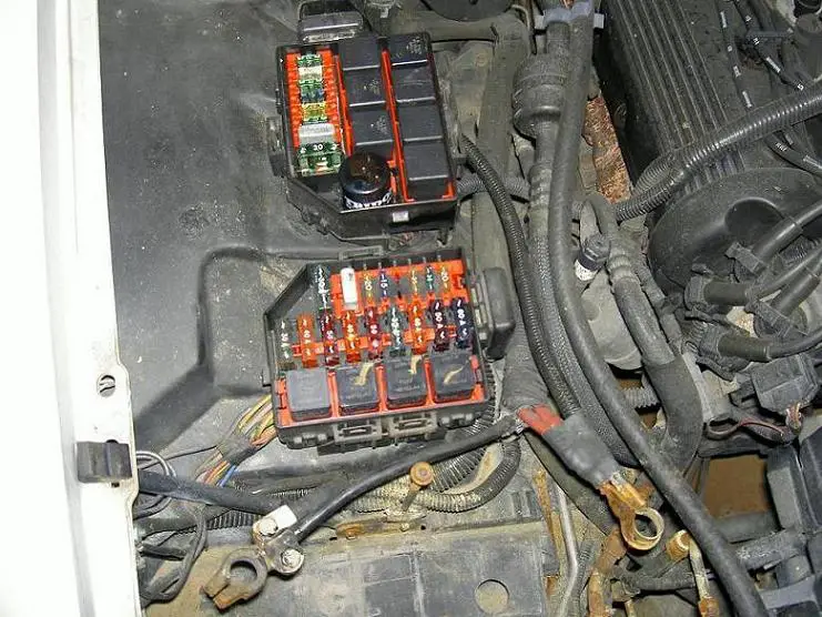

That kind of load would really be best in a cool space and closer to the loads. That relay box you saw in the LR is a common Ford part, there are similar boxes in the dash, under the air cleaner, and often along the fenders. The best part is they all take interchangeable Ford relays, there are two sizes, equally reliable. I mixed the parts from some spare wiring to make one for my extra circuits, I have a four relay combination in it with a flasher cut and epoxied into it. I mounted that under my master cylinder, with two zip ties. They all have covers to protect them some, if you use them make sure to place them so any water can get out and not be trapped in the relays.
An important feature you get with remote relays and switches is that the switch wires are very low power, and cause little trouble with burning wires, connections etc. The important wiring critical for amperage and great connections are all at the relays and to/from the battery and loads. That's safer for where you place the switches, and those connections can be very quick small wired crimps.
FYI, a 94+ Mustang has a nice main PDB(power distribution box) under the hood. They are easy to come by etc. You can put together lots of combinations.
Relays are somewhat simple. There are commonly four terminals, two trigger wires and two load wires, and usually either of either pair can be ground or power. The fifth terminal that some have is a normally closed point to the #30 main power terminal. It's usually used to turn off a circuit, feed power or complete a circuit without applying power, until it needs to be broken. That doesn't have to be used, it's just another choice.
