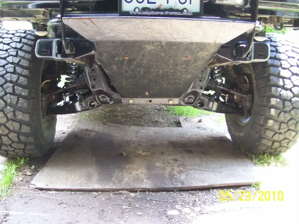

Pictures by the end of the day! Wrapping up the coil over conversion today. Need to mount the brake lines in a good spot still, and do some final tuning for the ride height and valving. I have the spinner nuts at half way down the shock body threads and have 2.5" of lift. They need to be backed up to get rid of some of that lift. Hopefully the coils are just needing to settle and relax a bit. I want the nuts at around 60% down. QA1 recommends this for optimal collapsed rate. As is, I need to go another 10% to achieve that, but that will give too much lift. This is most likely the result in my choice of going 12" instead of 10" shock length.
These coils has made it so that you have to compress them with a floor jack under the control arm to get the upper ball joint back into the knuckle to install the pinch bolt. That is how I have done it in the past, but this is a lot harder to do now.
The Dixon Bros cross member is installed. Ran into a slight problem with that. The pre-drilled bolt holes on it did not line up exact to my tabs. In order to work the tabs side to side, (front to back is easier if bent) the entire control arm assembly would have to be removed. I was not about to do that. Since the holes were wider apart than the holes on the tabs, I ended up making the hole on one side bigger on a drill press. It was only off by 1/4", but enough to make it a pita.
This was the time to install the cross member. Since there can be NO load on the LCA to remove the rear bushing/mount bolt to install it. The stock bolts work on this, as the cross member only takes away 3/16" from the thread length.

All finished :bounce:
Coil overs successfully installed, new paint, and DB cross member on.
Front sits at 40" to the fender lip. I have the valving set pretty stiff for HWY. The swaybar is permanently gone. When I want a smoother ride a simple turn of the knob, and it can ride over train tracks and hardly feel them :D
